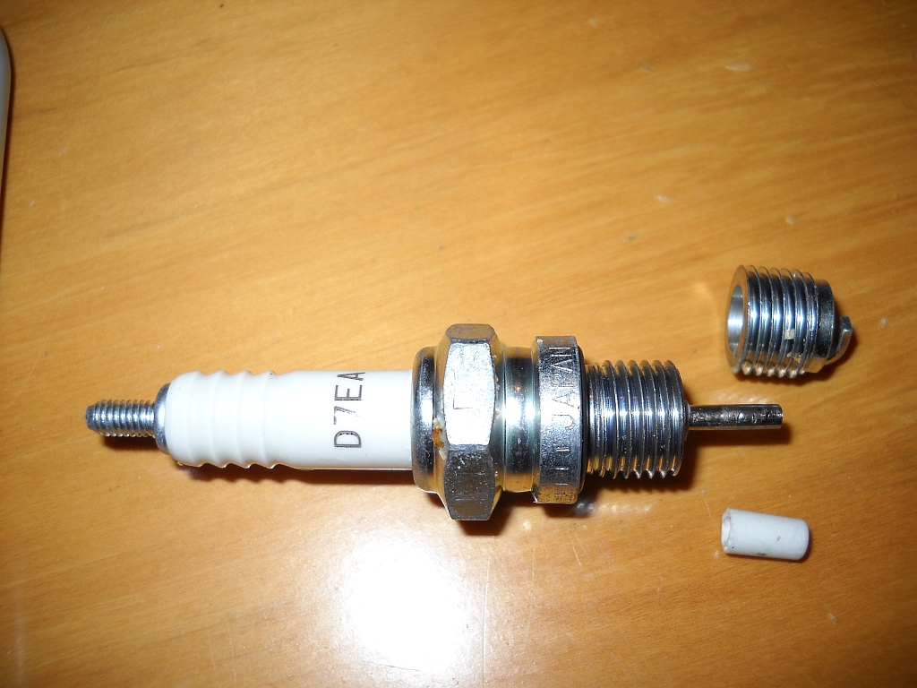

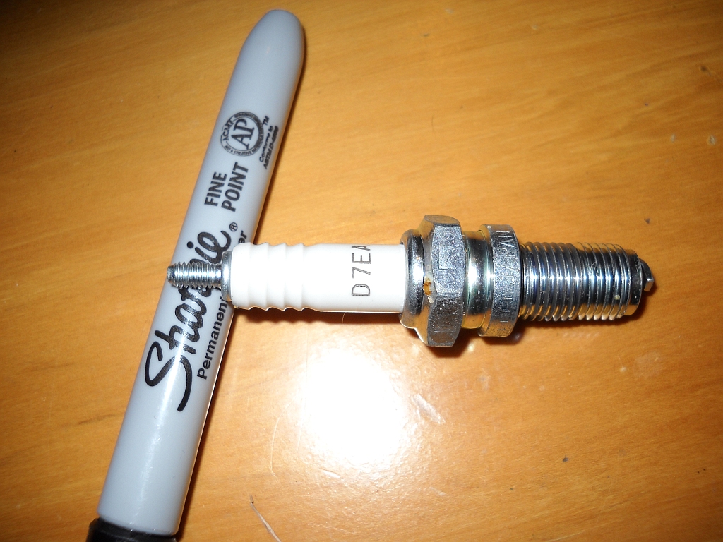

Heres how to make usable feddthroughs out of spark plugs good to around 20kV with out any further measures
photo 1 choose a non resistor plug ie no resistor in the centre leg with as long a reach as possible (plug thread length)
Now you have to part off the bottom part of the threaded portion so that more of the centre is exposed
careful you don't want to hit the ceramic insulator inside.

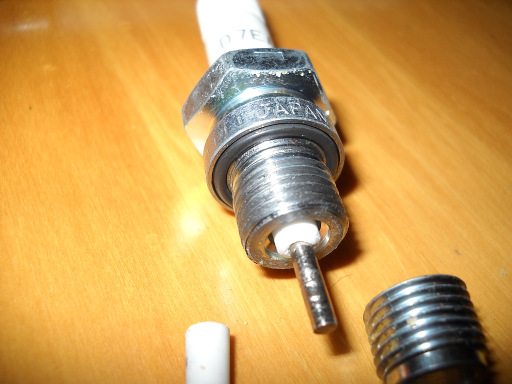

using a thin diamond coated disc in a dremel cut the insulator almost all the way through all the way around
Remove sparkplug from lathe and holding the exposed inner in a vice gently bend the inner a little, the ceramic will crack where you sawed it all around with the dremel
things should look like this

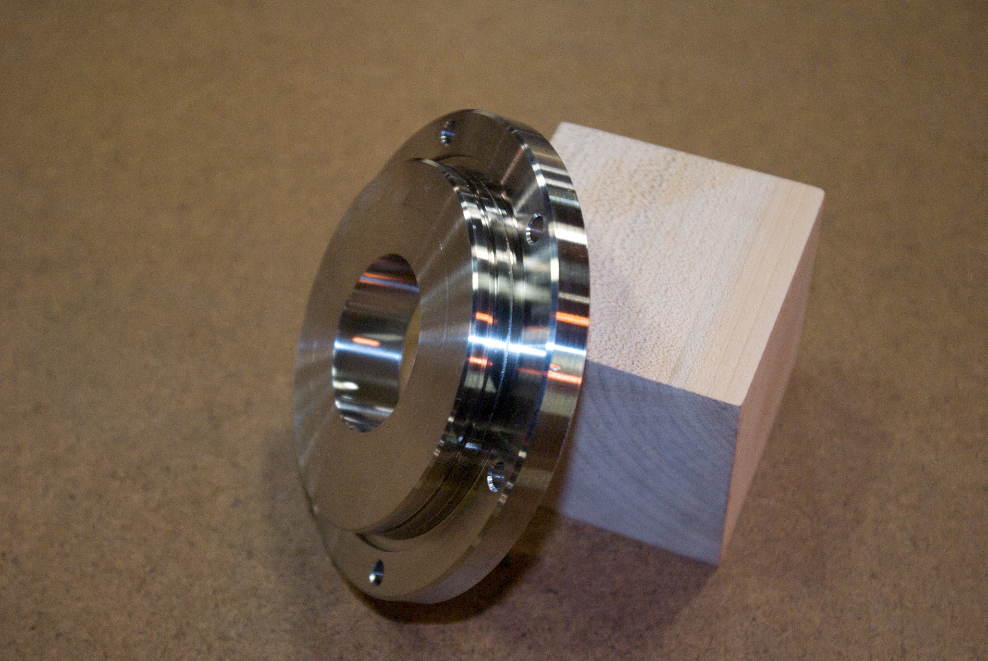

Face grooves are not that bad to do. But you need the right tool geometry. Assuming standard CCW rotation of the chuck you want a tool that looks somewhat like a mirrored comma. The outside radius should be slightly tighter than the OD of the groove and the inside should be slightly greater than the ID. The finished tip should be full width at the top tapering to the side with a curve. Use as thick as a blank as you can as usually there is a bit of stickout to get to the groove.
With that even stainless is easy, here is an adapter I turned out of some mystery metal stainless. Probably 316.
