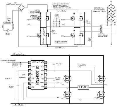

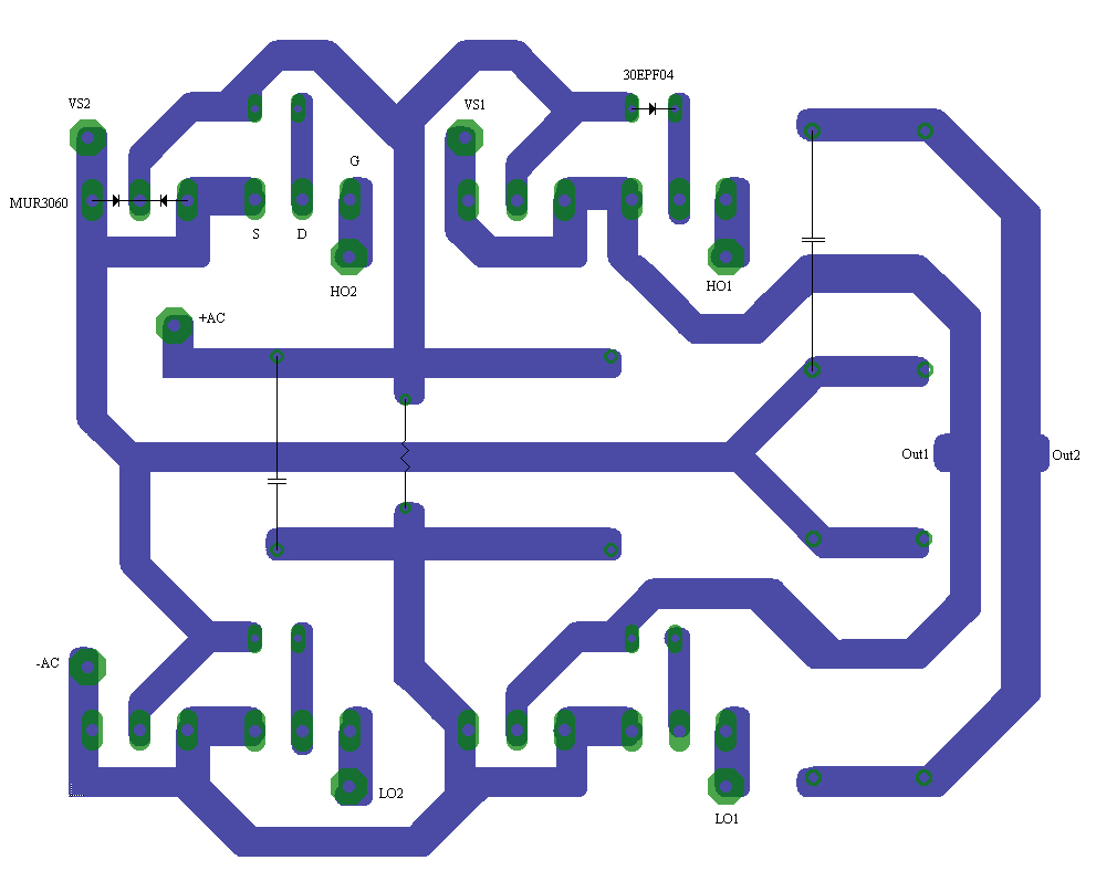

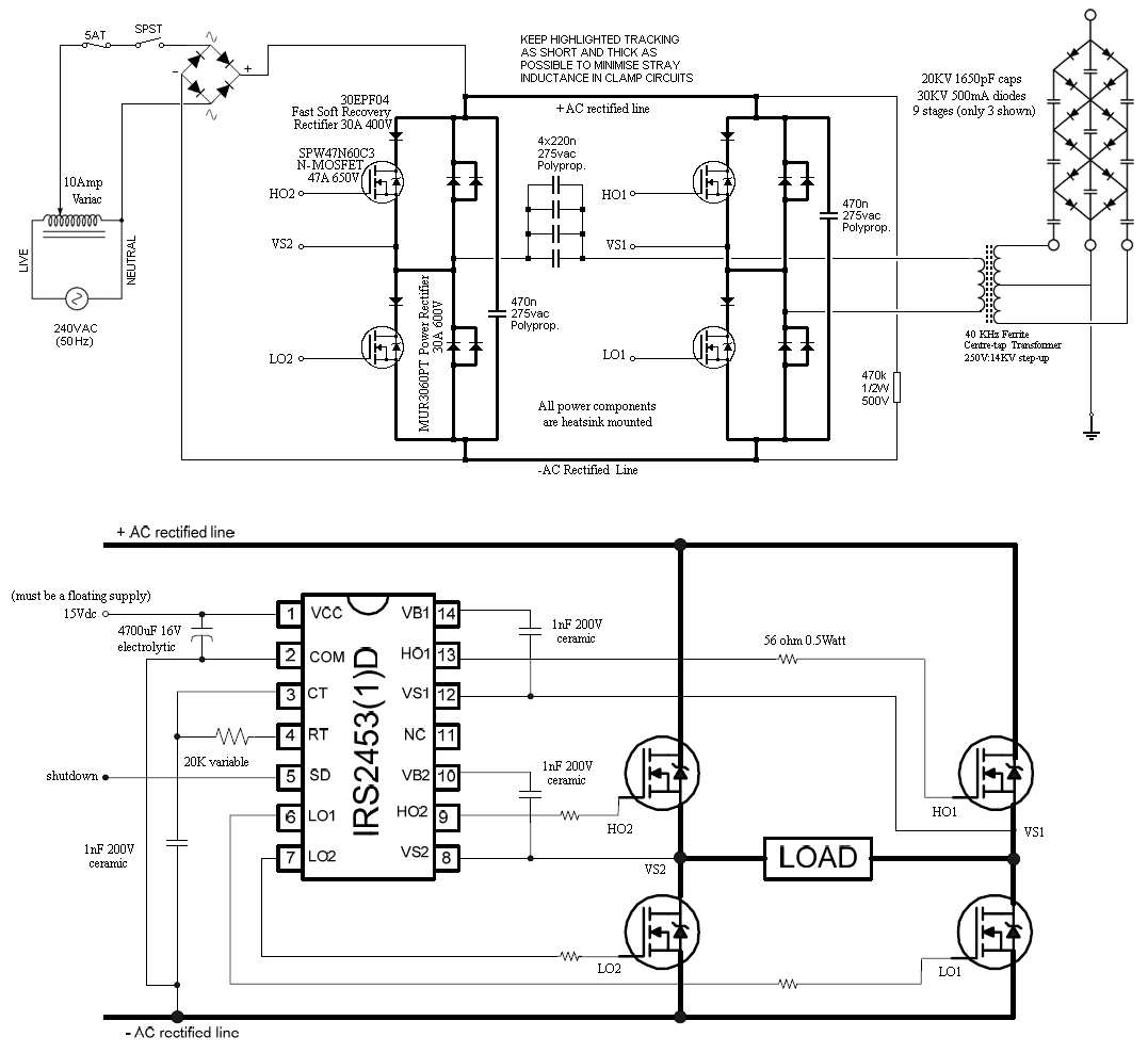

Probably like many of us out there, I have been having troubles with my high voltage power supply. Doug suggested that I take this up on the forum, and perhaps we can work through it together. The problem is that the FET’s in my H-bridge circuit keep blowing.
I see at least two main issues – 1) Driving the FET’s properly and 2) matching the driver circuit to the transformer and tuning to optimum frequency.
I have attached an image of the circuit – the schematic describes all the component details. I am also concerned with possible inductive and capacitive parasitics due to poor circuit layout, and so have also attached a PCB layout.
Some points to consider:
The full bridge driver IC (IRS2453) is RF shielded from the H-bridge, and the voltages produced by the IC are around 15VDC, so the FET's are not being overdriven or under driven.
The dead-time is controlled by the driver IC and is fixed internally at 1.0μs. In addition, I have included four 56ohm gate resistors (to increase the dead-time? and prevent shoot-through currents), although I do not understand how to calculate this resistance or how it relates to the gate mesh resistance Rg,i. I also do not know how to derive the values for the capacitors between VS1 and VB1, VS2 and VB2 for this IC.
Each FET body-diode is isolated with a Schottky Barrier diode, connected in series with the drain lead, and external fast recovery diodes are connected across the FET and the Schottky diode to provide a path for the free-wheel current.
All semiconductors are heatsinked, I have a heavy duty 50k ohm resistor on the output of the voltage multiplier ladder, and I ramp up the power slowly through a 10Amp variac.
There are four 220nF caps paralleled, all in series with the primary winding of the output transformer, in order to eliminate the presence of any DC current in the primary winding; the output transformer is 250V:14kV, designed to run at around 40kHz and has a ferrite core.

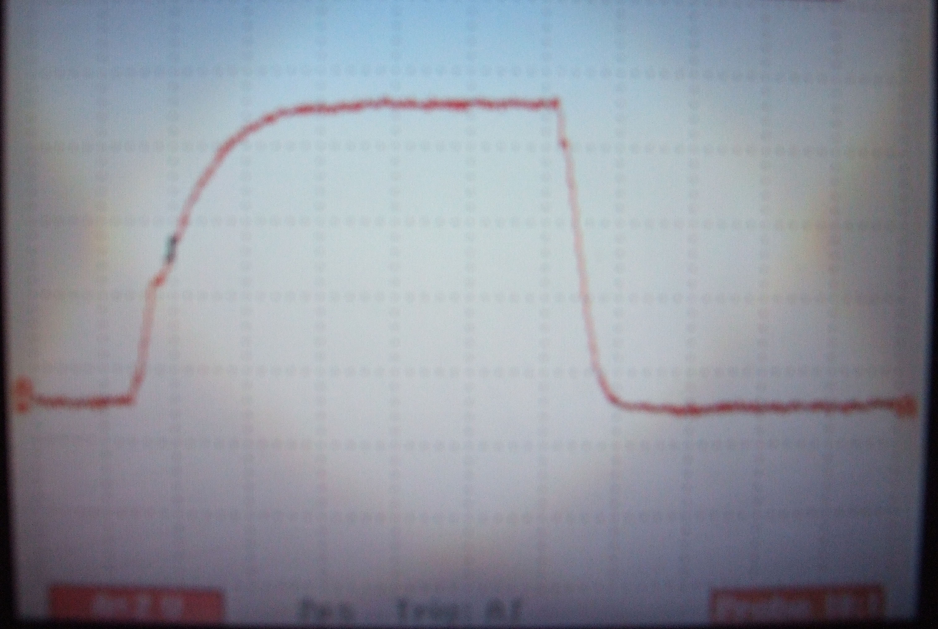

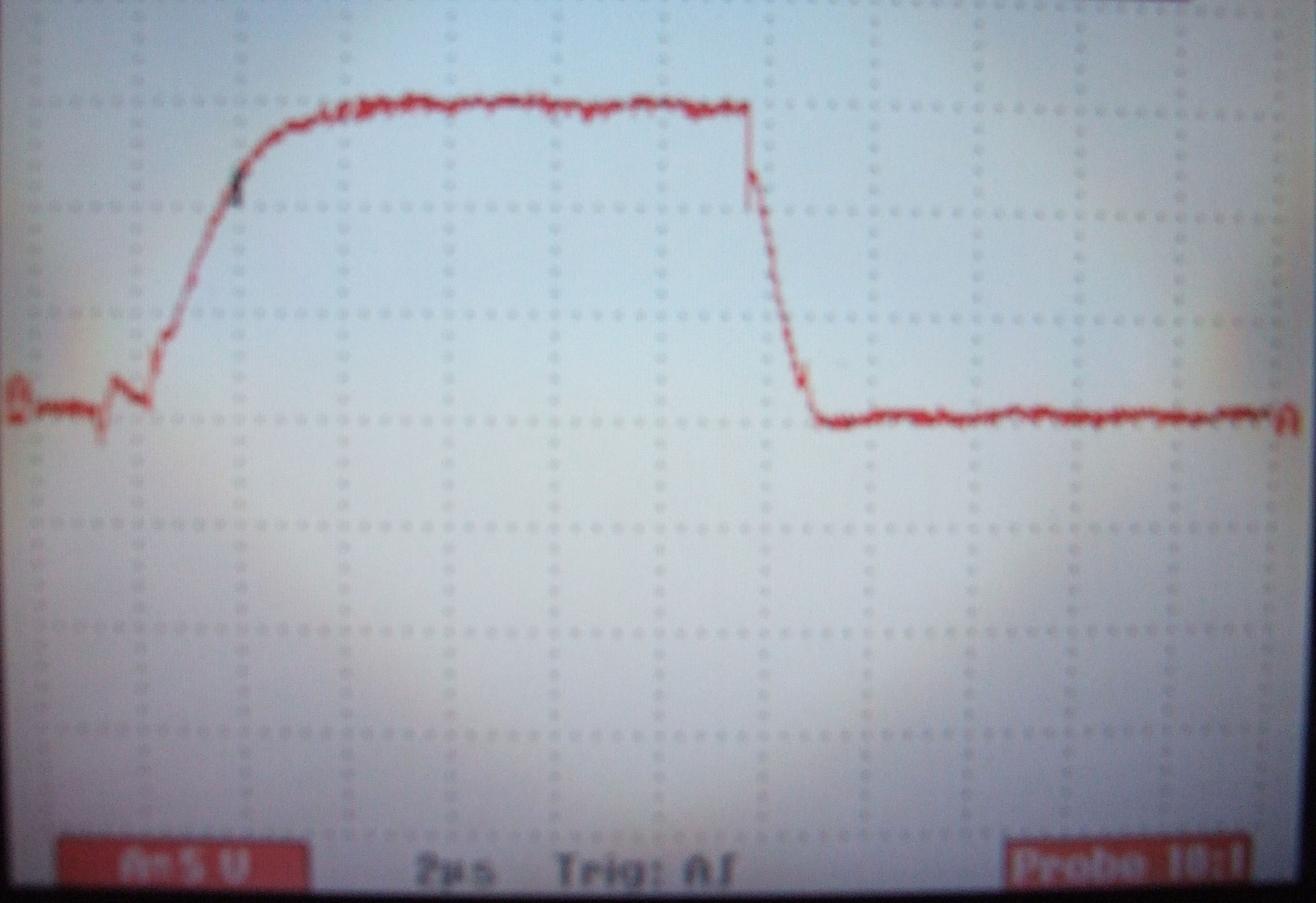

From the recent scope measurements taken on FET gates, it appears that the lower FETS, LO2 and LO1 have reasonably square waveforms, however, the waveforms on the gates of H02 and H01 are just little spikes. These measurements were made without the transformer connected. I will repeat them again, transfomer connected and report back (with pics of the waveforms).
Doug suggested that the FET’s I’m using (SPW47N60C3 [which are 47A, 650V]) are too large for this IC to drive directly. Could anyone suggest a more robust driver IC?
Or possibly I could swap out the FET’s? I have some IXFH52N30P, which are 52A, 300V, although these are perhaps still too large?
So, with respect to point 1, turning on the FET’s, I understand that Cgd and Cgs need to be overcome by the gate drive current before the FET will turn on. On the datasheet these values are given (at 250V) as Crss = 70pF = Cgd, and Cgs = Ciss – Crss, where Ciss = 1600pF, therefore Cgs = 1530pF. The driver IC has an output source current of 180mA...

Not surprising you are having troubles. The high side bootstrap capacitors VB1,VB2are way too low in value.
At present 1n try 4u7 to 15uf they should only need to be 25 volt rated low esr types a must ( I usually use multiple 4u7chip 1206 ceramic).
The 1n caps will not suppy enough gate charge in fact the fets probably have more gate capacitance than the bootstrap gate supply ones.
Net effect of this is the fet will not be hard switched a sure method of letting smoke escape.

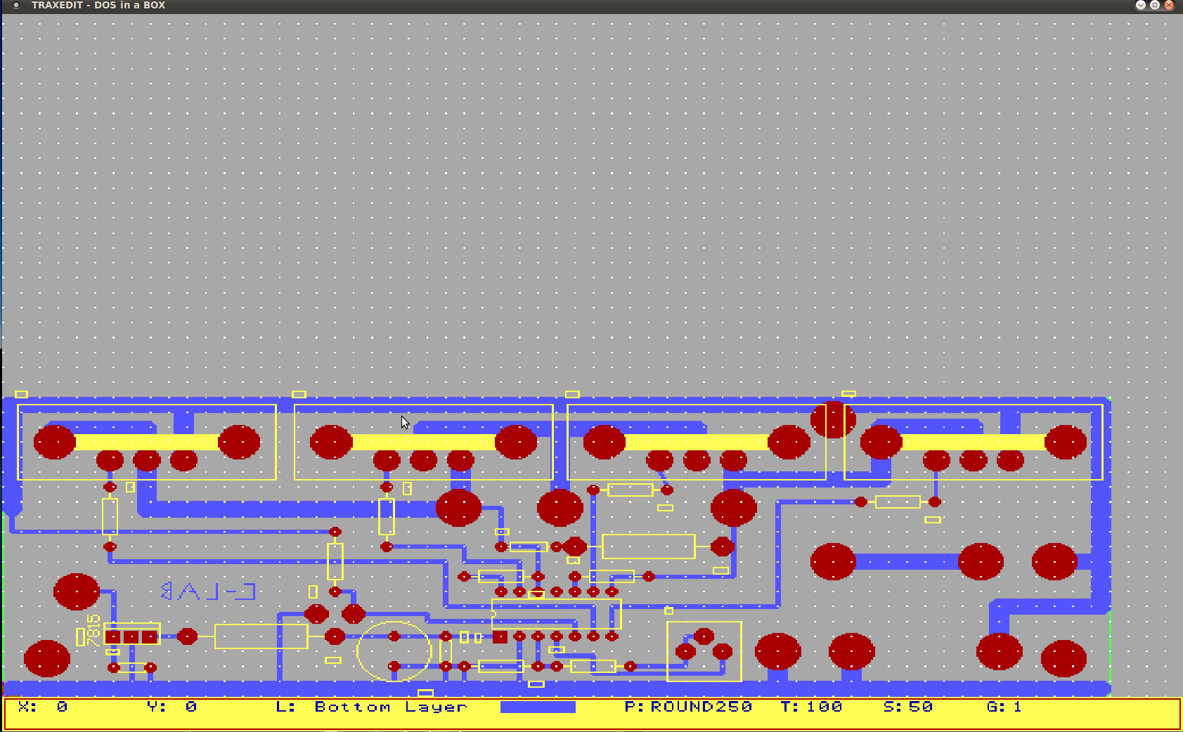

PCB layout in trax/dos/linux software
Here's the layout I wound up with after a couple of tries. Fets across the top so they all go on the same heatsink and the wiring is "tight". I stiffened up the high current tracks with wire, and use an 82 uF bypass electrolytic across the main rails. One way of knowing if you're tuning right is that thing gets HOT if you aren't. Any farther away is too far away for that cap to be.
Note the ground rail at the bottom isn't wired to the main rail minus -- that's on purpose so I could insert current sensing there. I had to add a wire from the cap (on the right) to the + rail for the fets (center top) because of the limitations of a single sided PCB (made here). I have a trimpot for oscillator tuning, and a series R in that so the pot isn't too wide a tuning range and hard to adjust. For what it's worth, I found using a super-high quality silver mica timing cap was a bad thing, and a crummier ceramic actually works out better. Go figure. I used a 3 terminal 15 volt regulator for the chip to keep the chip cooler. Don't know how important that would be in yours, but it helps here.

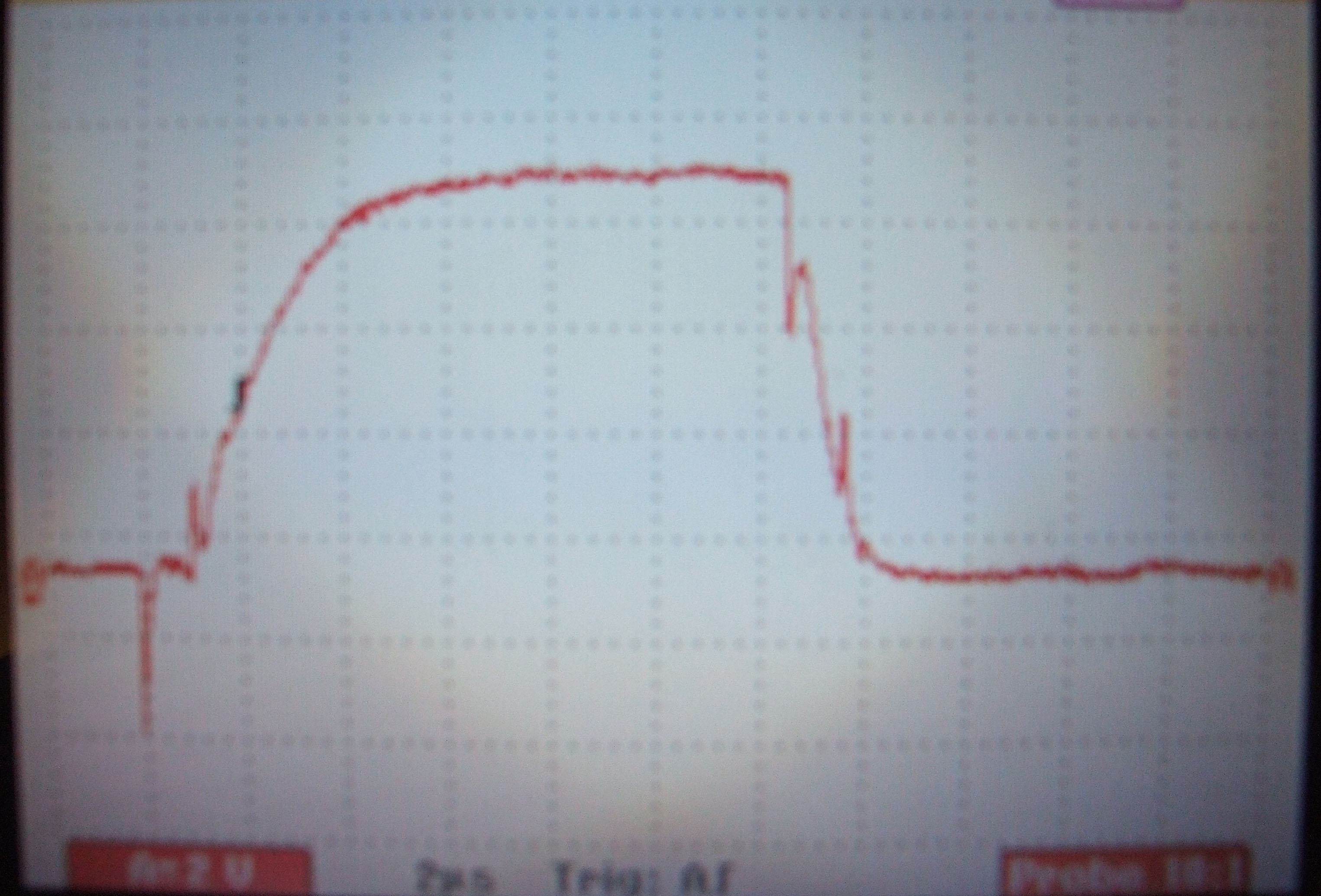

I replaced the caps with some 4u7 tantalums that I have to hand - they have low esr, but not ultra low (I also ordered a range of ultra low tantalums yesterday). This made a huge difference (I immediately found an interesting triangular wave on the output. I then replaced all the 56ohm resistors with 15 ohms. This made another huge difference - the triangular shaped wave pulled itself up into a pretty decent square wave. Unfortunately that is where the improvements ended.
I do indeed have several glitches (see the third pic): The most serious looking one is a negative going spike just before the turn-on slope at the gate drive. The next glitch is just after the start of the turn-on slope, and there are another two on the turn-off slope. I have tried several different values (15, 12 and 6 ohm) for the gate resistor and several different cap values (4u7, 9u4 and 14uF) for the bootstrap capacitors. None of these values or combinations thereof makes any difference to the wave shape, nor do they improve the glitches. They only thing that does improve things slightly is turning down the power supply from 15 to 12 volts...
I have a battery powered portable Fluke 199C scope, which is floating, by definition. So I think that I can measure anything that I could measure using an isolation transformer/scope combination? I am measuring this gate signal with the ground lead of the scope probe attached to the rectified AC- line, and the probe to HO2. If I place the probe’s ground lead to VS2 (the bridge output point) and the probe to HO2, then all the glitches disappear! What does this mean? The glitch is on the low side of the bridge?
Another thing that I noticed is that the high side gate signal is only 10 volts, whereas the low side is the full 15v. This is not right, surely?
LO2-Ground (5 volts per division)
HO2-VS2 (2 volts per division)
HO2-Ground (2 volts per division)

What I see instantly is that the chip can't get a good fast rise or fall time into that gate load. That means slow turnon and off of the fets, and they will die when current is being drawn during those times. 10v drive should be OK, actually, but you have to get there quick. That's showing that either the chip can't charge those large caps fully, or they are not so good some other way.
Could be the stuff in the chip simply wimps out at the currents required -- it should be within a volt of so of the chip power supply voltage. With most fets, the actual threshold is about 4v or so, and how fast you can move through that is the key. At 10v or so, you're getting it as turned on at high load currents as it's going to get if you look at the fet spec sheets. I can't quite make out your horizontal speed/division, but assuming you are running some sane frequency, those rises and falls are just too slow. The fets are spending much too much time in a linear region with both voltage and current across them with that drive waveform. Your rise and fall times shouldn't be 10 or 20% of the total time as I see here -- that will get things very hot under real loads, and risks getting out of the safe operating area of the fets. (Thank heavens you're not running with igbts, or they'd die with this even with no load at all!)
It might be counterintuitive, but with less fet that gets fully switched quicker, you don't have that loss anymore, and then only have the loss during on time due to the finite on resistance, which is still going to be pretty low even with a smaller fet. Though heat is heat, and fets have a pretty square SOA, it's still a lot easier on them to not be dithering around during the switch interval, and a smaller fet should actually run cooler and be more robust here (or a much fatter drive -- amperes instead of the milliamps this chip makes).
You're going to need more drive, or less fet. I'd go with the latter myself (because it makes the rest simpler and all of it cheaper), but that's a call you have to make. I don't know your power output target, but this chip is for KW and down kinds of things. If you're really going to run full rectified 240v AC on the rails, I'd go with the industry standard IRF 450 600v fet there. That's more or less what this chip was meant to mate with, and there's a good reason that it's the one you find inside any FET based commercial HV power supply when you peek inside - regardless of the brand. They'll do a KW pretty easily when the other things are right. After all, with 240 *1.414 = 339vdc and 10 amps (the fets are rated for more on a heatsink) you've got over 3kw possible there -- and you can't use it, really. Your fusor tank will melt a good bit before that -- not to mention the grid. It's all going to come back as heat and X rays.

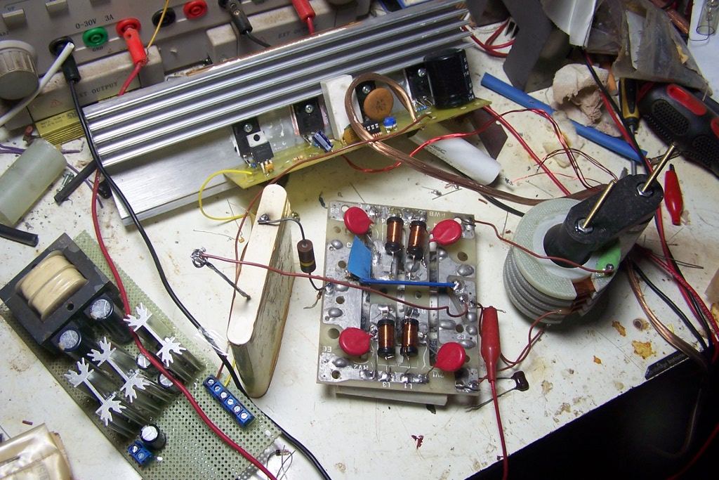

For reference, this is what I'm testing with now, a different transformer (homebrew) and what appears to be a stage from a Spellman supply (acquired surplus) that someone foolishly dug out of the potting material -- it won't go to it's rated volts in air, but is plenty hefty -- I can easily push a KW through this setup. I will note that just moving the primary from under the secondary to the other side of the core made some very dramatic differences in how hard this was to drive while staying cool --a little leakage inductance goes a long way sometimes.
Bridge setup on my tinker bench.
The perf board on the lower left is the housekeeping and chip power supply, a little fancier than needed, but it's going to run fans and a microprocessor as well in the final rig -- it makes two floating outputs. The main H bridge is at the top, and hopefully the rest is obvious. I've been using this to test a bunch of those big yellow HV caps we also got surplus, and to test the driver in arc situations, which it now passes with flying colors -- I like that. The big Wallis transformer is actually a lot easier to drive due to a lot of leakage L in various places in it, gaps in the huge core, and the big pie wound secondaries that have some leakage L and R. This little transformer borders on being "too tight" and is when the primary and secondary are on the same core leg.
At this point I'm driving it off a bench supply with current limiting so I don't have to replace fets (almost) no matter what happens. With the full rails power, it's another story, so it's easier to get it right this way, then do the more risky thing. The fets in use here are irfp-264's which are a little on the large side for this chip but it makes it -- just.
