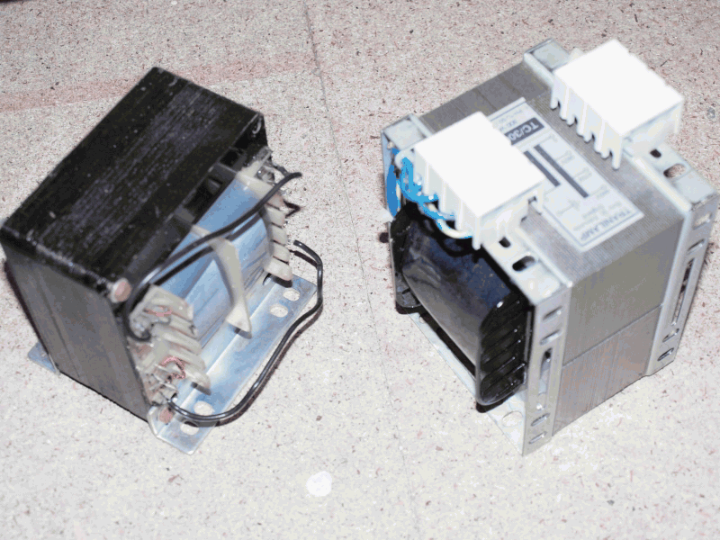

Well, a transformer-type humming started up and then the fuse blew. I was hoping it was a short to ground of a small part, but oddly, after desoldering each part in turn to trace, the fault appears to be in the isolation transformer itself.
What is odd is that there is no short to ground in it, but it seems to be a short in the secondary. The resistances all look OK on the terminals so I suppose what has happened is that a couple of turns into the secondary coil something has fused making an alternative 'few-turn' coil causing very high current internal load that I can't see.
Does this make sense? And perhaps it just gave up (being 40 years old) and was unrelated to terminal float?

I've had this happen for a variety of reasons. You probably have a shorted turn or few. You can test for that various ways, but you already know the answer -- the thing is toast, stick a fork in it, it's done. Usually can't be repaired without heroic effort.

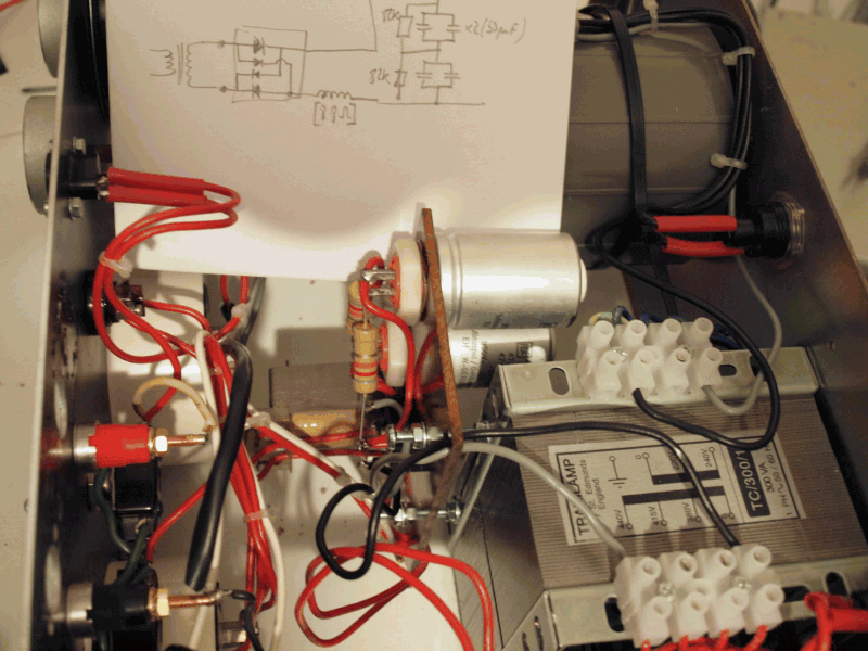

OK.. so decided to get on with substituting the transformer, and the result is very nice.. looks like it has always been there. It is a slightly higher rating but otherwise exactly the same spec and is a 'new' isolation transformer, so happy [enough] I did that job anyway.

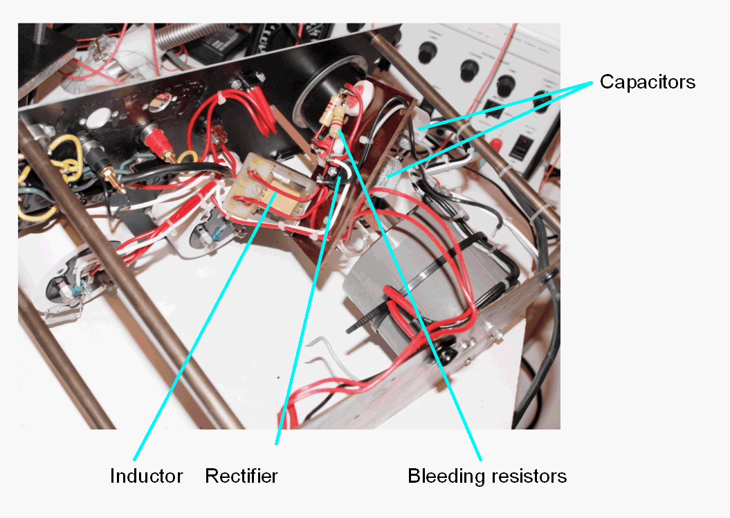

So the basic layout is variac -> feeds isolation transformer -> feeds bridge rectifier, then two 'double' caps via an inductor. [I think - please let me know if it looks like I misunderstood that little transformer thing with two inputs!!!).
When I disconnected the bridge rectifier from the transformer it still hummed badly, so am satisfied the transformer was toast and needed replacing.
But after replacing the transformer, the inductor is also humming alot now. [I have disconnected the smooting stage from the output lines, so only the smoothing stage attached to transformer.] Problem is, I'm not sure what 'normal' humming is, but I don't think it is right. (Still no measurable shorts to ground on the inductor.)
Question is... what is this secondary fault most likely to be following a transformer short; is it a fault with the rectifier [could one side have gone down?] or a capacitor internal breakdown, or a short resistor. I don't know what fault can happen to inductors that would make it hum?
If it could be anything, I might as well replace all the parts. :roll:
I'm only thankful enough I have an ancient linear supply that I have a half-chance of understanding!

If your inductor is humming, it's an indication of too much AC current going through it. Likely a shorted diode (easy to check usually, they rarely fail in a mode that makes them into a low voltage zener), or a shorted capacitor.

Yeah, sounds like a plan to check out the rectifier.
....[later..] yup, rectifier gone. Good call, Doug.
Sigh. I'm a bit annoyed because I think [thinking back] the signs were that that went first, then the transformer which I might've saved if I powered off quicker. Oh well... such is the game we play doing this stuff! I daren't even think of the more expensive things that can go wrong! :?
