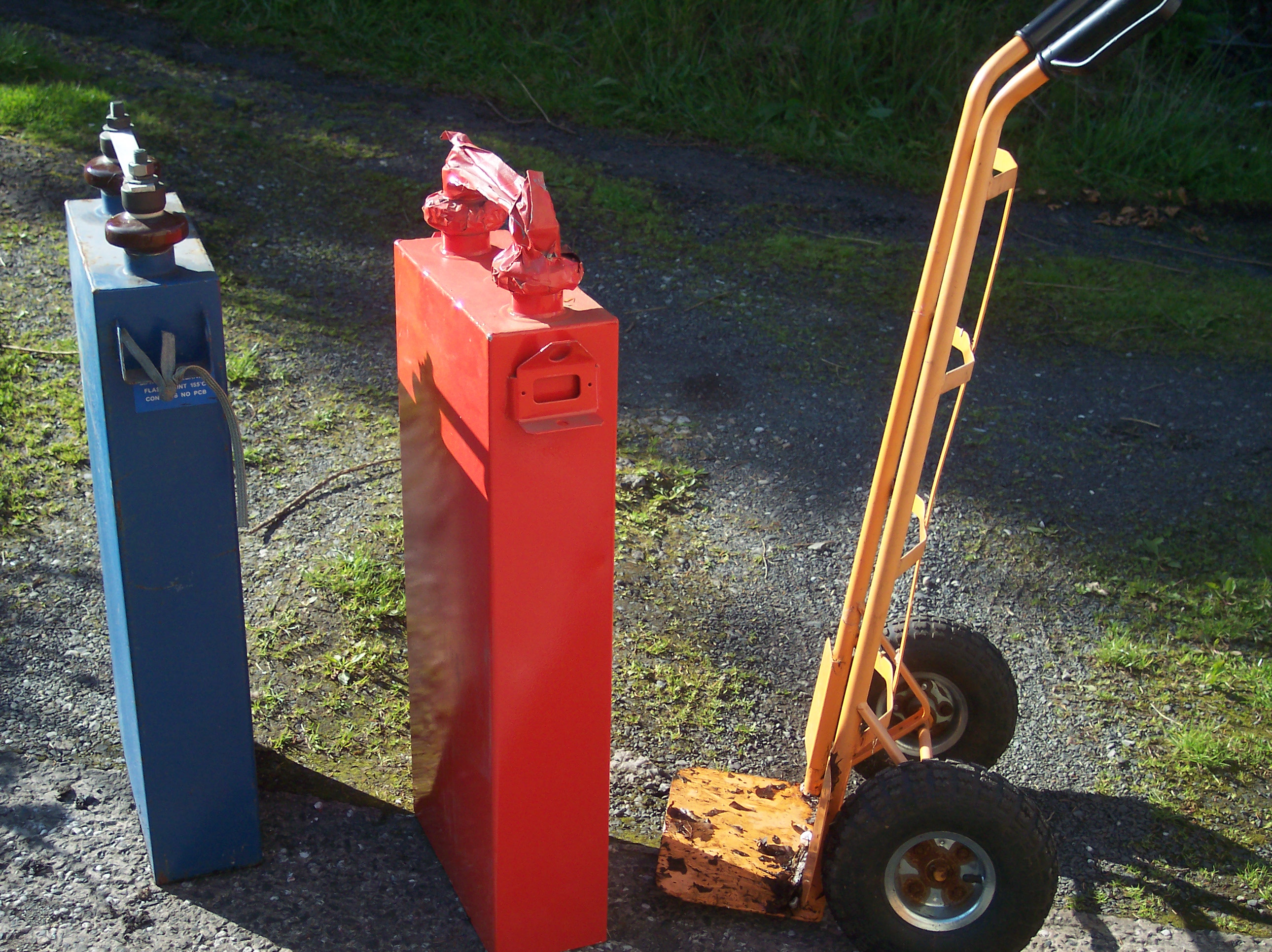

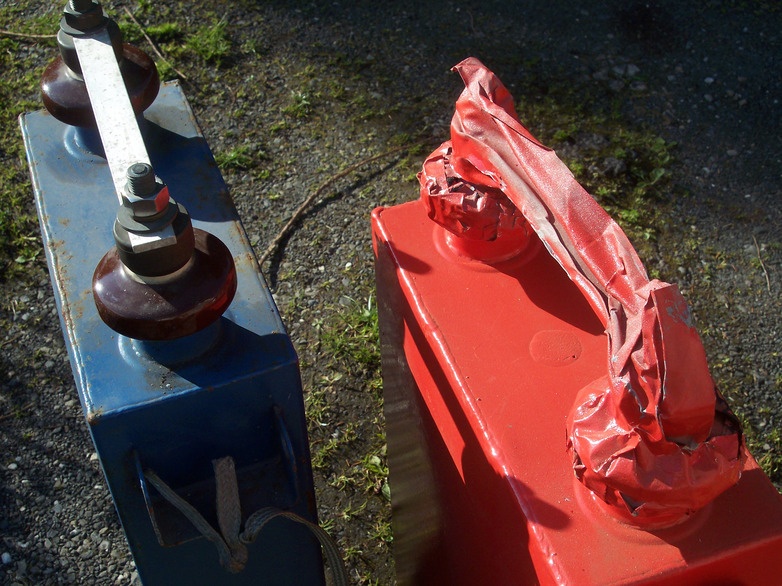

That time of year again and time to brush the cupboard - the picture shows 20kv 24mfd caps repainted (@ $300+ ) the blue showing rust and the red after sand blasting and two coats of undercoat and a red finish gloss.
The caps weigh in at over 200lbs each.

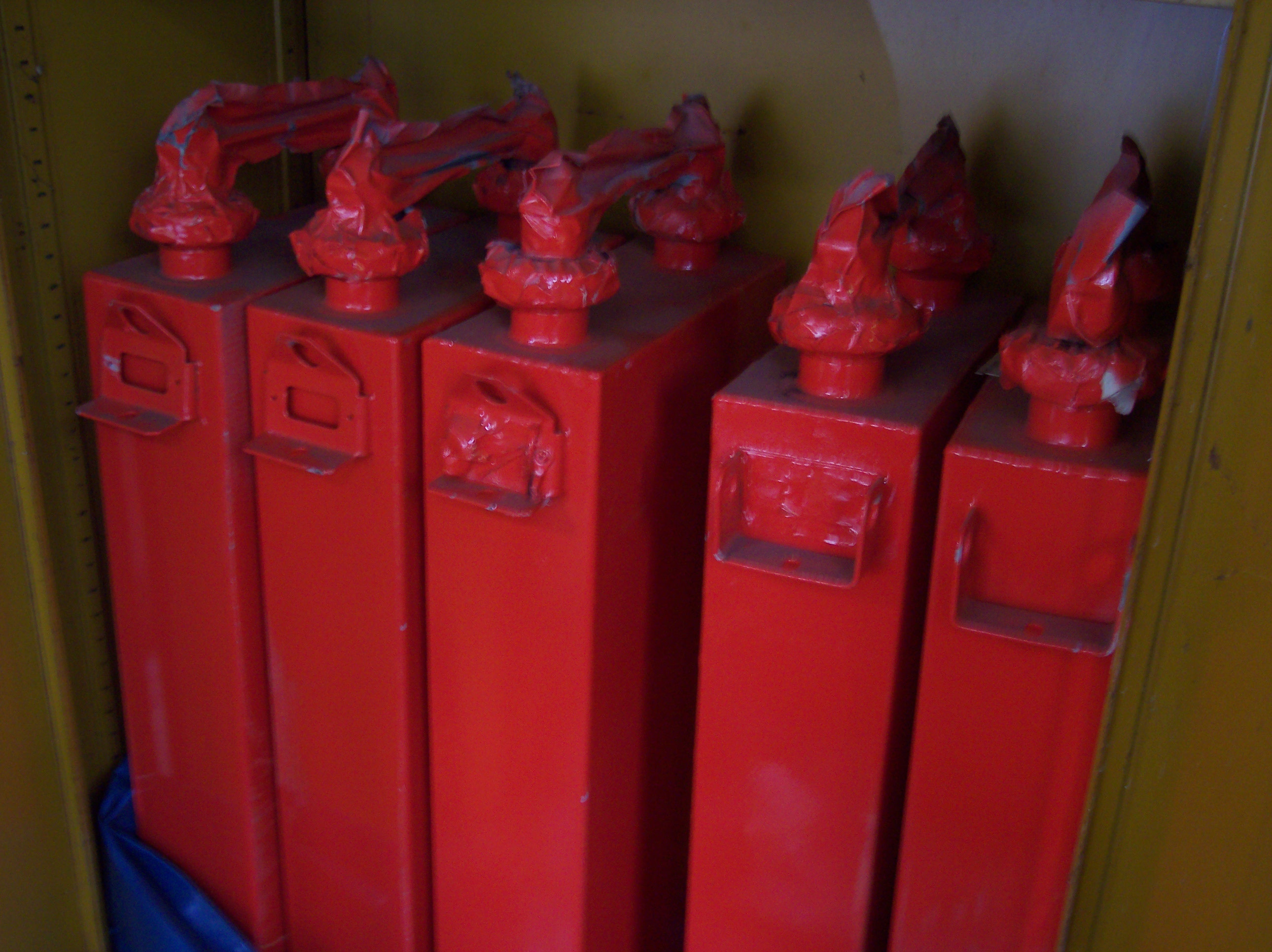

Part of the bank -240mfd 20kv full bank makes a loud bang when discharged ( not good in N.Ireland :)
Shorting bar taped up

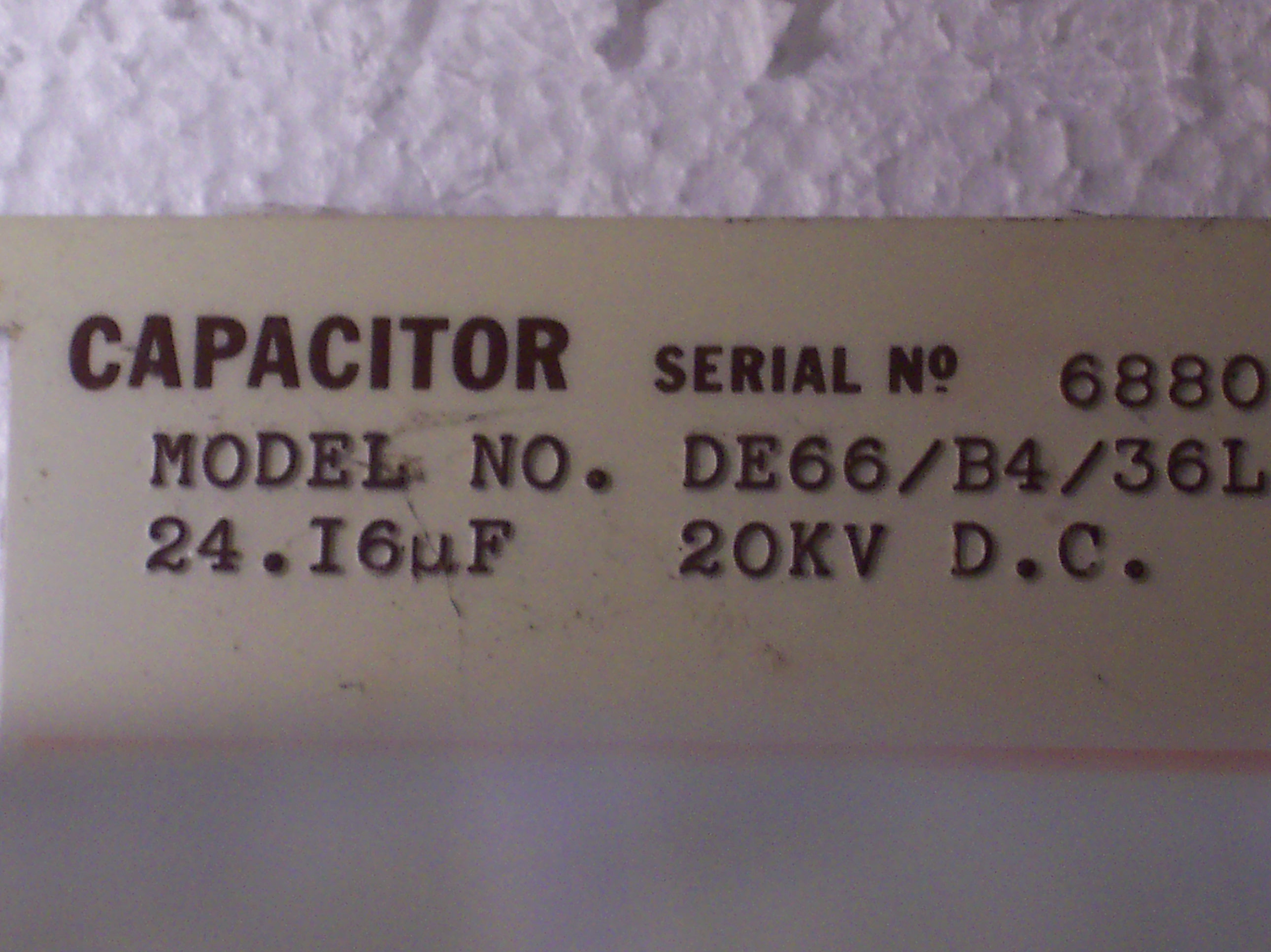

Plate
Two of the bank with a truck - before (blue) & After (red)

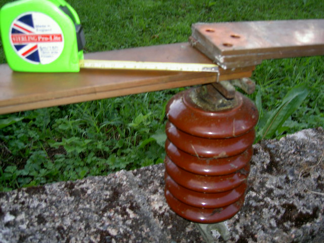

The thing is that one needs a different level of engineering Doug to get the transfer of energy fast and it also needs a few tricks.
2 off 3" x 0.25" solid copper bus & standoff's
