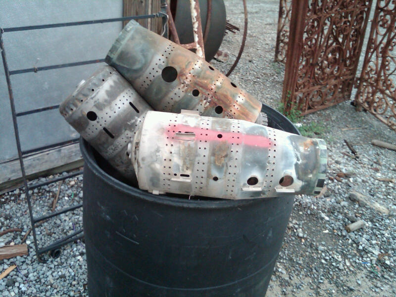

Postby Bill Fain » Sat Jan 08, 2011 1:59 pm
Joe, Hi. I have always wanted to make one of these too. I have a cummings turbo, oil, pump, fuel can, and a few braided steel hoses. I think I have the original AIEE turbo/jet design paper laying around here somewhere. I haven't built it yet because I don't have any welding/metalworking capability. And now any of that would go into fusors anyway. The biggest obstacle was going to be the burner can/flame holder deal. I have found a source of old burner cans, but I think they are too big for this application. I was going to buy one thinking they were titanium, but they turned out to be hi temp. SS. I can pick up one for $20, if you're interested before your impending visit. Might make a good pattern/ reverse engineering thing. I don''t know if they have a flame holder in them, but I'm pretty sure the injectors are not with them. Let me know soon because they are about an hour away. -bill

Postby Bill Fain » Sat Jan 08, 2011 4:45 pm
Hi, Well I blew this. Ready fire aim. I thought the post was started by Joe. My mistake. Well Thomas, do you need a burner can or the AIIE paper, if I can find it? -bill

Bill, There was a time that I was contemplating building one of these too. I learned quite a bit of the little detaily type stuff when I was working for one of the big boys, but eventually shelved the project because I already have too many others and it wasn't going to be quickie.
Doug, you're right about about the size/cooling thing. A typical jet engine only uses about 30% of the air it takes in for combustion. The vast majority of the remaining 70% is used for cooling, and a lot of that is used reduce the combustion gas temperature to a reasonable level before entering the turbine. Another case for the large chambers is giving the fuel time to atomize and mix properly. I've seen combustion chambers and fuel injectors that were melted because the spray pattern wasn't exactly right.
The series of holes that go around the cans in Bills picture are used to keep the flame away from walls of the can and help cool the combustion gasses.
