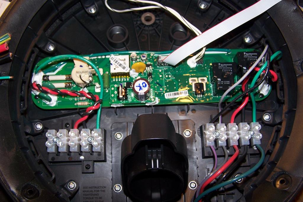

Guts of the Voltec unit.
In a big plastic box, you get this little circuit board that's mostly blank. Fuses, then a GFCI sensor, a little +/- 12v power supply to run a uP, and a couple relays to switch power out to the car. It comes with a long coiled (ugh) cord that puts way too much side-stress on the car connector for my taste as well.
It turns out, that's all you need, and even a uP is kind of overkill for this. Sure, since they have it, they check AC frequency and voltage and a bunch of other stuff and refuse to work if anythings not perfect, but so what - the car doesn't care, it's just a brute force rectify and switch into the batteries kind of thing at the other end. After all, they don't have to change the car for 208v (between two phases of 3 phase) or UK, at 50 hz and whatever - it's just a universal switcher in the car.
Now, there's a pretty simple protocol involved, that uses only one wire and a ground return, and this is where the factory units are lame, and mine will be much better. Basically, the "cord" emits a 1khz +/- 12v square wave with a 1k series impedance. The duty cycle high is what the car uses to decide how much power it can draw (within the car own limits). It works like this. The EVSE (glorified extension cord) makes this signal all the time. When you plug in the car, the car has a 2.7k load hardwired so the cord can tell there's a car there. This load is through a diode - it only affects the positive part of the wave swing. When the car is ready to accept charge, it switches more load across the pilot signal - net about 880 ohms - to drop the pilot positive peak to around 6v. At this point the cord goes into action and closes the relays that let line power go out to the car. The unit could vary the duty cycle to allow the car to adapt to varying amounts of power being available, in a situation like my solar system - but the factory ones don't have any way to do that. The unit could also switch the AC off when there's a need to conserve power for a bang-bang algorithm, but again, not the factory ones. I put a switch in the line to the 120v one so I could do this, but then had to defeat the car alarm going off for "charge cable theft". It still beeps once when power is restored. Not a problem here, but some places people whine about the fan and pump noises the car makes when charging, so you know they're going ballistic about a horn.

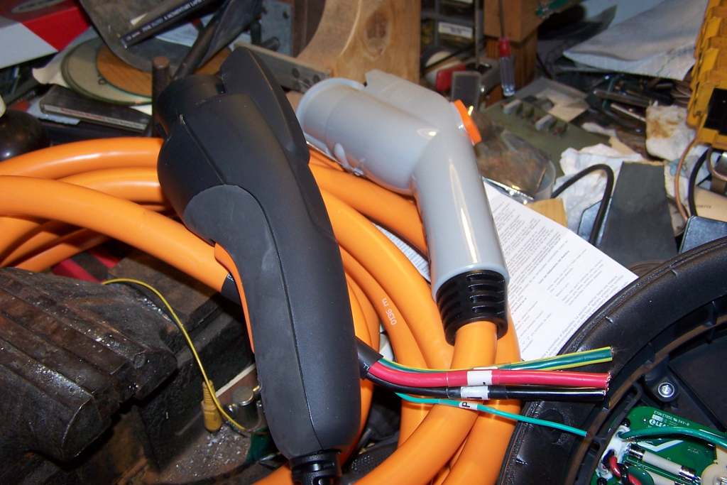

Thus are all slick projects born. As mentioned above, I bought one of these expensive cords, raw, to implement my own system for this:
Better cord from TusconEV, also expensive, but lookie that fat, straight wire!
Got this nice orange one from http://www.tucsonev.com/
This uses straight wire (which I prefer) and this one's number 8 stuff - not number 12, so less losses at 15 amps. It's longer than the Voltec/SPX unit and obviously much better made. The only difference is it lacks the built in led flashlight on the end, but has a connector cap to keep mud out (important here). There is an open EVSE project out there that uses an arduino to control this, but I like PICs, and theirs also doesn't have the desired/required features (though I could probably add them if I wanted to bother to learn the ins and outs of yet another UP). Here's their page - I've asked them a few questions, and they've helped with answers. I plan to publish this there and here as well - the more open source ways there are, the better. http://code.google.com/p/open-evse/
