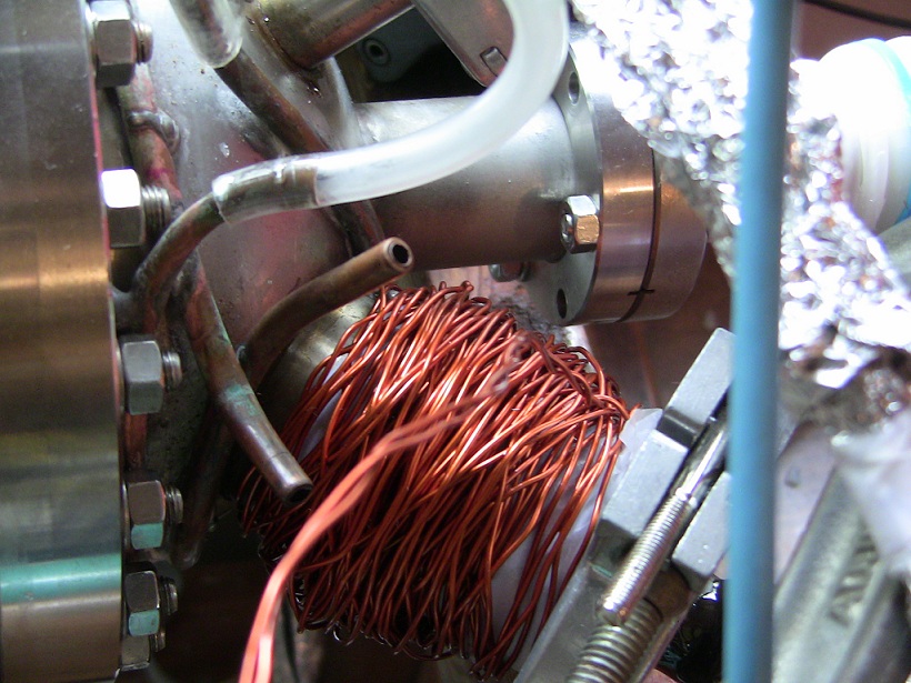

The ion gun design is a KF50 flange with about 150 turns of magnet wire around the tube. At the time of this incident, it had about 6 amps through it, so the field at the center was somewhere around 200 gauss (very much an estimate since the exact winding count is unknown and there was no active current meter on the DC supply at the time, but after previous probing and knowing the variac setting, it was about this amperage). Then there is a little mini-grid inside the flange attached to a feedthrough. This then connects to a rectified NST. So, basically a pretty simple DC magnetron using an electromagnet to vary the field.

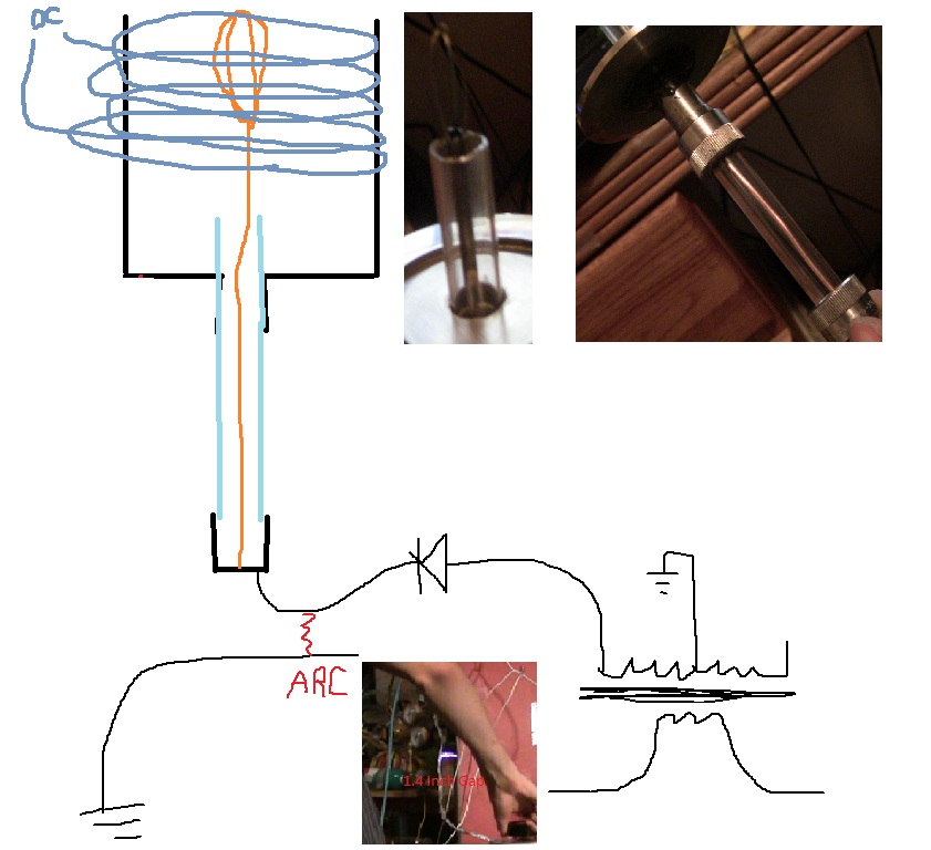

I've attached some images of this, the first being the electromagnet, second showing the arc, and the third showing a diagram of the wiring and coil.

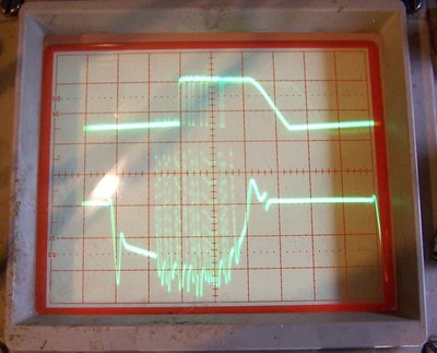

This video shows what I was doing at the time, not the same as you, but a similar thing going on.

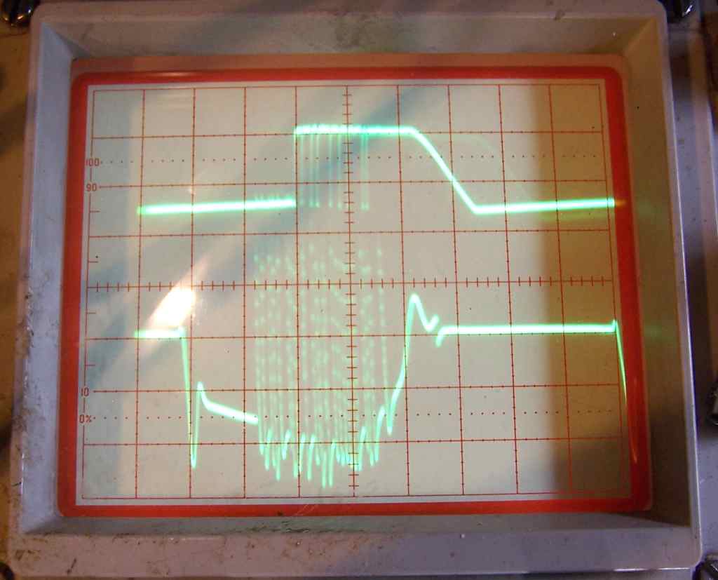

Scope trace - neutron counter upper trace, voltage on secondary grid, lower trace. Lower trace 10kv/div.
Here, the upper trace is the output of the 3He tube (after some pulse stretching, a transformer, and an audio amplifier, that's why the weird jump up after the first negative pulse,
which is energy stored in the isolation transformer and the audio preamp clipping -- for what I'm doing, I don't care about that).
The lower trace is the realtime volts on the FT using a frequency compensated high voltage probe. Zero volts is one major div below the middle. There are several important things
to notice here, I think. This is chopped traces triggered off the 60 Hz line, so within the camera exposure time -- they are concurrent. Two things that are making
me really scratch my head here. One is that you can see that when the phase is such that we are trying to drive the secondary grid positive, it takes awhile for
it to start "rectifying" and clamp the volts back to ground -- eons in electron transit times. Why? Second -- why does it take so long after getting to negative volts for those
pulses to begin? Eons again, and so is the repetition rate, slow considering the equations of motion I think are applicable. And why do they go positive of ground?
Now, to add something else I don't right now have a picture of (didn't take one before frying the NST, Bill is bringing another this week) is that the faraday probe shows the plasma net negative a couple ms (during that positive overshoot on the second grid) and then going positive as the 2nd grid stays in the positive going phase, but is getting clamped back to gnd -- for a couple ms. After that, the signal on the probe goes positive about as far as it had been negative (about a couple hundred volts from a wire in there into a scope input at 100 megs load). It doesn't seem to see those
sharp pulses that the other things see, though, during the 2nd grid negative half cycle, and I'm not sure why other than it's about 4" from the action.
Without that second grid connected, I always see a couple hundred volts net negative on the faraday probe.
This is puzzling me no end. The only thing I can think that makes sense with laws of physics is induced charge as a bunch of pure positive ions come into proximity to
the grid on the way through -- after all, the neutrons seem to be coming out in bursts right then. All the times involved, though, are EONs compared to what you'd predict
from the speeds of the particles at the assumed voltage fields. Milliseconds, not nanoseconds. But why in heck does it take so long to happen? Something else
(perhaps some odd recirculation) has to be going on first that I'm not seeing, first? Something that eventually builds up to some sort of avalanche condition?
Note, you'd not necessarily see this if I ran my 3He tube normally. I have a very high threshold set so I only see a pulse if it gets hit by multiple neutrons inside on tube response time -- more than one per 10-30 us in other words. I do this as I'm interested in bursting, and because otherwise it always sounds about the same on the audio amp you can hear in the movie it counts
so fast.
My pulse widths have sub microsecond rise times, and about 10 us fall times, but only occur at sub kHz speeds.
It's like it takes a long time to "make up it's mind", then avalanches, and does this a little *after* you get to negative volts on the thing, after having sucked out the electrons
and made the plasma net positive (we normally measure net negative with a faraday probe in usual DC fusor operation). I'm getting about 5-8 pulses per
60 Hz half cycle doing that, at least until it fries the NST.
