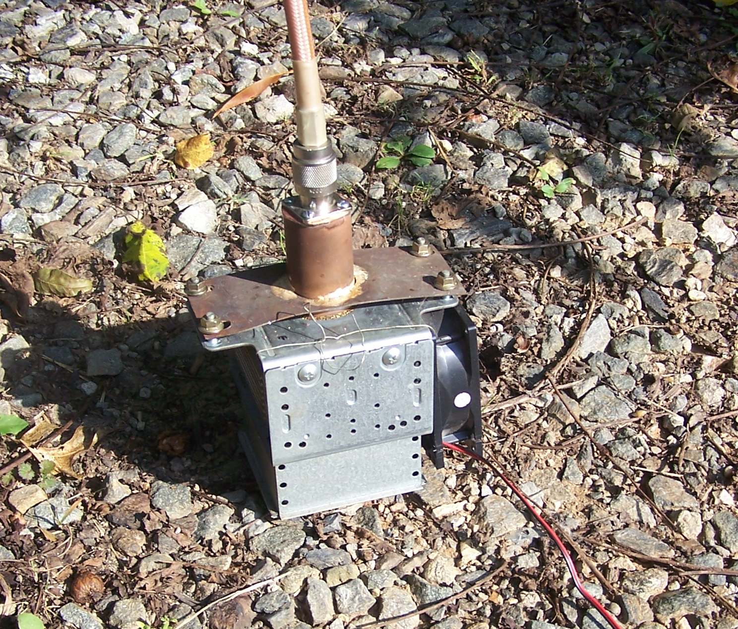

As this sort of thing is "rocket surgery" for many, I thought I'd show what I did with a side of why I did it this way vs some other way. Here's what the result looks like:
Magnetron with coax type N output
Not pretty (yet), but it works fine as shown. I used a computer type chassis fan with some wire through the magnetron heatsink area to hold it on (baling wire!) to keep the maggie3 cool. Even at low powers, you're putting around 36 watts into the filament alone and that will heat things up to the point of messing up the magnets if you're not paying attention. This little fan gets it done with minimal fuss, and my magnetron power supply has a 12-14v wall wart incorporated to drive the fan.

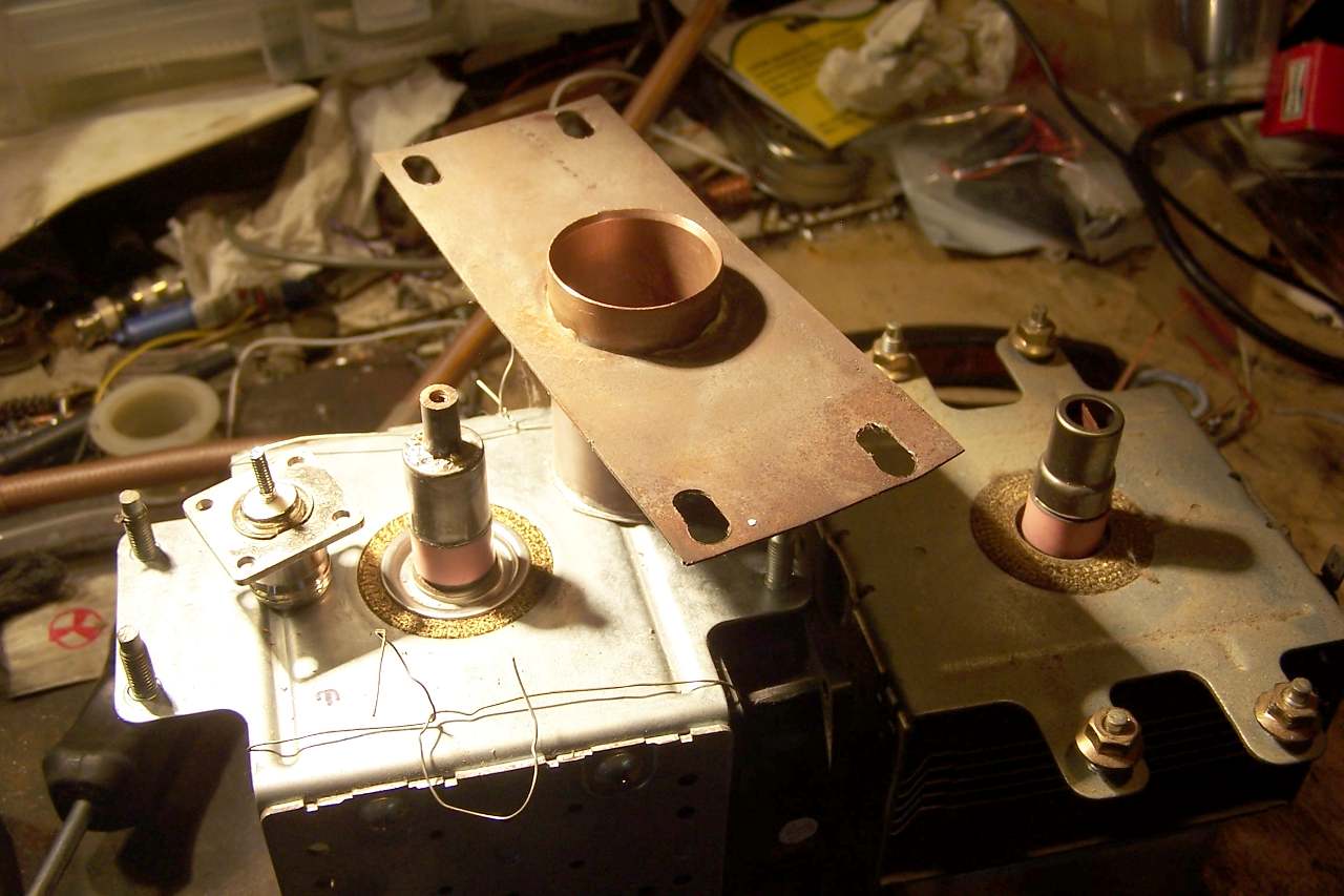

The parts for this, and a different magnetron shown too - with looser tolerances on the ring, but worse antenna end.
The sharp eyed will notice I cut a 45 deg chamfer on the inside of the Cu fitting to make it self center a little better, and bite the gasket harder. This isn't required, but when you have a lathe, there's no reason not to make it nice.
So, how do you make all the connections, and still not have a hole in the side somewhere that will leak microwaves out into your environment - particularly the center conductor? I tried a few things that turned out bogus, and then came up with this rather slick idea that does indeed work. But first, the ground. The female 1" pipe to pipe coupling does this part - one end punches into the gasket on the tube, the other end gets a piece of copper welded over it, with a 5/8" hole punched in it to clear the little protrusion most type N female chassis mount connectors have. But before you solder that endplate on, you first make a piece of thin sheet steel 2" by 5" and make some holes in it - 4 for the standard microwave bolt pattern for this type tube, and one big one in the center, 1.225" or so, to clear the plumbing fitting. This sheet is silver soldered onto the pipe fitting about 3/8" up from the bottom, so it can act like a spring when you bolt the piece to the magnetron, forcing the copper into the gasket. (in truth, this is the belt, the suspenders are elsewhere).
Now you have your basic outer conductor for your first part of the device, the short "adapter coax". Since you silver soldered or brazed the joint that holds these pieces together, you can then solder on the top piece without worrying about re melting that joint. I used plain old copper flashing for this - that's on the thin side, about .020", but for this it's adequate.
Now, assuming the connector is about 1/2" more or less to the "arc danger area", and knowing that 1/4 wave, the amount we want to add, is about 1.1", we need a bit of extension to make that happen, and to match the serendipitous correct length of the plumbing piece. This turns out to be about .488" we need to extend the top of the center conductor on the magnetron. Here I cut, drilled and tapped a 1/4" copper rod (3/8" or even 1/2" might have been better) to 4-40, a standard screw size, and soldered the bottom onto the tube. Since the tube top is stainless steel, you need that special flux you can get from McMaster to do this well - no matter how you sand, file, clean, soft solder won't stick on this without that flux (has some HCl and some Hf in it). You could, in theory, also braze or silver solder this, but since that's also right where the vacuum seal pinch-off is, I wouldn't try that unless I had a few spare tubes to maybe make into garbage learning how to do it very quickly before I did heat damage. The particular tube I used for the prototype would allow me to use a mere 1/4" diameter rod for this, but the one shown next to it would have let it fall inside - so for that one I'd have needed 3/8" or more - no big deal, just something to look out for - the tube antenna is about .6" so you've got some some fudge to play with there.
It turns out the solder end of the type N connector sticks down a little too far, it has a lip, so I simply sanded that off on my belt sander. There's still plenty of meat there, and by golly, it's an almost perfect sized hole to tap 4-40 too - a little large, but tight enough, so I did that. I simply cut the head off a short 4-40 screw, cleaned up the threads, and screwed it into the type N.
So, now it's time to put it together. You put the plate/plumbing down first, and finger tight the magnetron nuts to give it some clamp action - that's the reason we used thin steel as a spring, and used slotted holes to accommodate some spring here. The chamfer on the fitting makes it self-center on the tube nicely.
Then you go ahead and screw the type N connector center screw into the copper threaded rod you soldered on top of the magnetron, till it's fairly tight (don't over or under do this one and strip or break things, but you want some tension on those threads to make good contact). Once you are satisfied you've got it right, you then mark and drill 4 holes in the flashing end to put screws in to make contact, and ensure it won't turn in use and get unscrewed (and then leak microwaves). You can get away with such thin a top as the flashing, because those screws are in sheer, not tension, in use - they need no pull out strength to speak of, it's that one in the center conductor doing that, and to be honest, that alone might get the job done and you not need the steel spring piece. I like having both, myself. Tests show no microwave leakage from this, but low quality coax (for this frequency) will get warm at a couple hundred watts microwave power, so choose that wisely. Teflon is nice...and you want the big stuff (.4" OD), not the little stuff (.2" OD) for this job.
If warming of this due to skin losses is an issue for you - first make sure the copper is very clean, or you can silver plate it, as I plan to do just to make it really nice. You lose about a watt or two in skin effect losses with dull copper, enough to notice and get a little warm.
I've run this both CW and pulsed, using a modification of the same power supply we used for the microwave ion source. Works a champ! Microwave away! Remember, if you're going to run a lotta power, you've got a microwave oven, so make sure you put a screen over any viewports and pay attention to microwaves leaking out through other feedthroughs, as they will if you let them. In my case, all the FT's are faraday caged and lead sheilded for X ray and EMI purposes anyway, but be aware you don't cook your corneas looking into an unshielded view-port!
