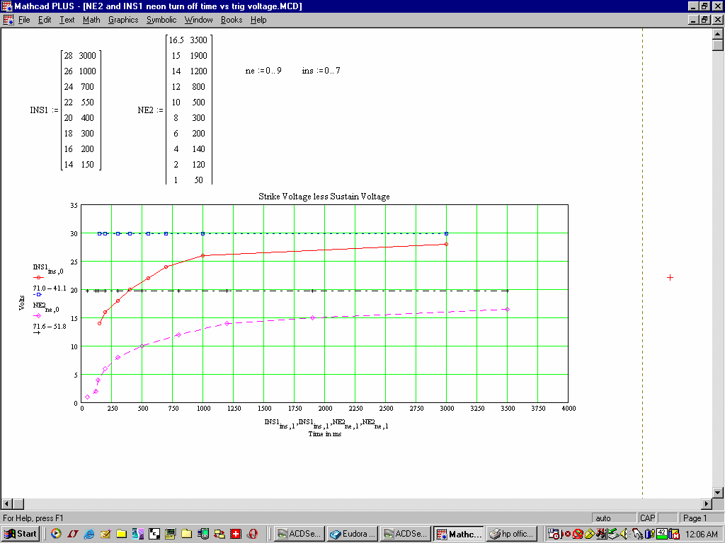

You hit every concept on the head, including the gentle saturation effect where the resistance at 0V is about 2k, while it is about 20k at 30V. It appears that RF-excited neon gets depleted. This is the case with many three-legged amplifying devices.

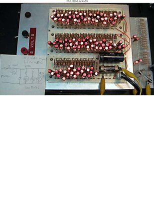

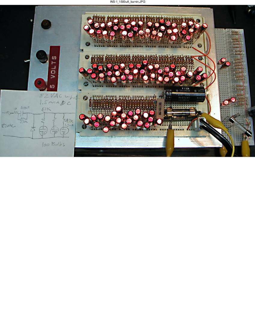

I attached some measurements I did a few years ago on how long it takes for the trigger voltage to recover it's full value after current to the bulb is turned off. This a deionization profile of sorts. The attached plot suggests that oscillation above 4kHz would be a struggle as only 6V out of the 20V histerisis loop has recovered. The measurements show results for the NE-2 and for the Russian INS-1. On a related topic I attached results for burn-in of the INS-1 bulbs over a week at 1.5mA. This shows how poisoned cathodes can clean up.
