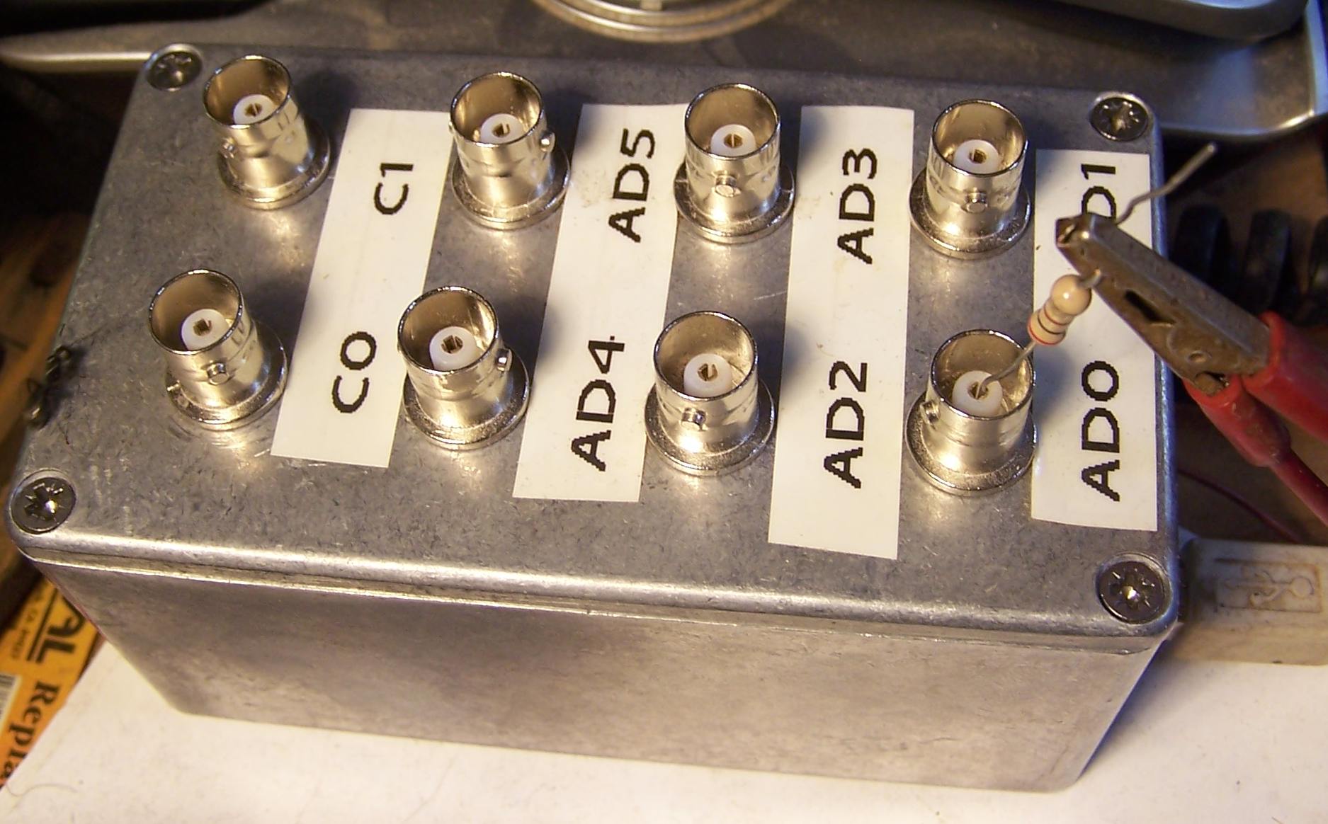

Here are some pix. As usual, click the pic for a large version.
Here's how I made mine look.

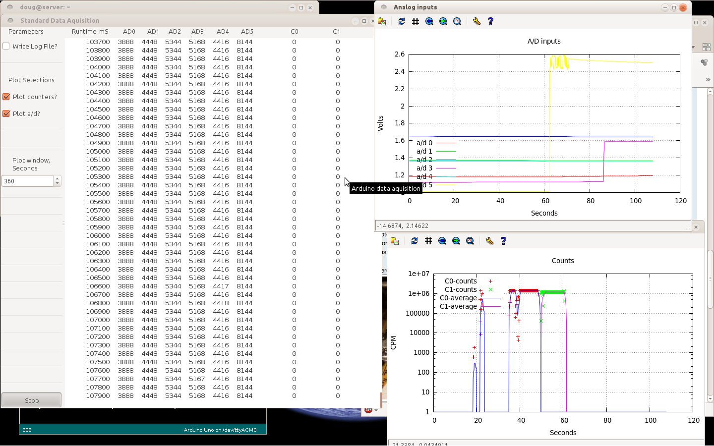

Here's a screenshot with me fooling around with the inputs. I connect the counters (sloppy at first with a wire off a clip lead) to a signal that counts once per two passes of arduino's "loop()" function - note that C1 doesn't count quite as fast - it steals interrupt cycles when a count happens. I later connected a channel to a 1.588v (fairly fresh) AA cell to calibrate things...I tested that voltage with a really good couple of voltmeters. Turns out my particular Arduino's 5v is more like 5.0x volts. That's running off a wall wart. If you run off the PC 5v from USB, you'll have tons of errors as the PC 5v isn't that great as an A/D reference...
Step after 80 secs is connecting an AD channel to an alkaline battery for voltage ref.
