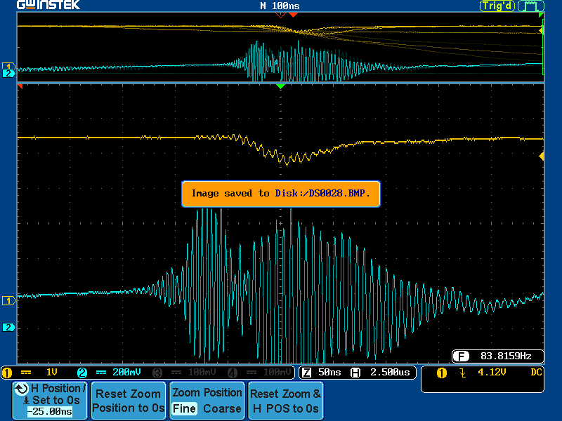

I'm trying to put together a system that needs all that hyper accurate timing to tease apart cause and effect in the fusor. Can't just take data at 2.5 ghz continuously while looking for oddities that might only happen 3-4 times in 5 minutes - that's an overwheming amount of data. But lookee here - correlated within one instrument (and soon across all my data aq).
Blue trace - from antenna picking up emi at onset of a discharge. Yellow trace - neutron detector firing. Long scale at top, zoom on bottom. Nice! And I can grab this with the computer over USB, or if I buy it (likely) ethernet interface. You can see a discharge start, then the main event produce neutrons when the other grid lights off and makes it's own EMI burst....
I can't believe no one uploaded the update I put on this thread recently.. If's the first one that gives multidimensional plots off this log format for one thing. EG the reason for the entire thing to exist at all, so you can mine your data as you please, with arbitrary mapping and presets for all axes and unlimited stored mappings if you like. Stuff you'd normally be into a few grand for.
