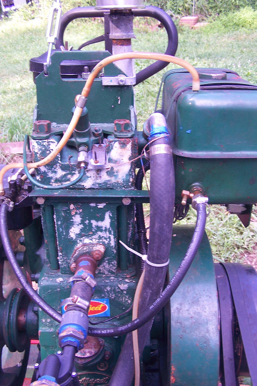

Today I got going on mounting a thermocouple (type K) on the part of the cylinder head that gets the hottest, as surveyed with an IR temp sensor. First, I sanded the spot down, then used a very thin layer of blue permatex to glue down some thin mica (cleaved off a thicker piece) - about 3-4 mils thick. Once that got hard, I put the thermocouple junction (made with oxyacetylene and flux) on top, more permatex, and wrapped around the hot water outlet; hint from Babcock and Wilcox "steam, it's generation and use" - keep the rest of the wire as close to temperature as you can to avoid errors. Since there is so much "shake" in this situation, and its outdoors, I then put the thermocouple wire in a silicone rubber tube and sealed off both ends with permatex again (might as well use it - you'll lose it if you don't). I made sure there was significant unsupported length between where it's cable-tied to the hot water pipe and the ground, so any flexing should distribute over a long length and not kill it quickly. In the pic here, the couple is under a magnet with a couple screws sticking up holding some wax paper over it. When that gets hard, I'll glue some R-Max with the the foil stripped off that side onto it so the ambient air won't cool the couple.
That's my thinking on those issues, of course I'll report if I turn out to be wrong or something is unexpected...this is the life we have while we were making other plans, after all.
Thermocouple being glued to cylinder head.

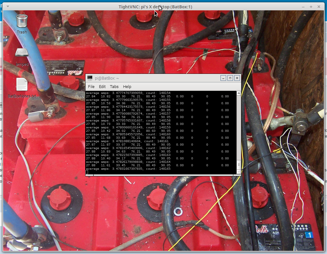

In fact, I can look at that stuff right now without even leaving this post of even this browser page, as I have a tight-VNC window open on it now - I haven't yet put in the web server for the batbox pi which is why I haven't made that set of posts describing it - it's not done by a bit. But it looks like this just running a test program dumping raw data from the arduino and other sources out. I've got a bit of coding to do yet on this one (and one that I've not even started for the machine shop and real weather station and water quality monitor).
Remote screen from a pi in my battery box.

Edit: OK, this is what's running on the arduino in the battery box, which I'm using the pi and perl to scrape up. Even though in this case I didn't need the long serial line and converter, and am just running off usb, there is no difference in how the protocol works, or how I talk to between them - same stuff, only the path under /dev changes. And now I can actually edit the arduino code on the pi from my comfy chair here, and burn the arduino from here as well...
This sketch also collects a few other bits of data, like battery temperature, box temperature (where the pi is, the thermocouple cold junction) as well as lister stuff - and I've yet to add the lister AC amp collection hardware/software, though I do have a tested current transformer. Soon!

Here is the raspberry pi code shown running above. Nothing special, it just requests data from the arduino and sends it to the terminal - it's testing stuff. I will incorporate some pieces of it to stuff this same data into a database.
I am doing some filtering on both machines. I forgot to put a low-pass filter in hardware at the battery net-ampere sensor, which I really should do...and some other details like keeping track of amp-seconds correctly for later conversion to watt-hours.
