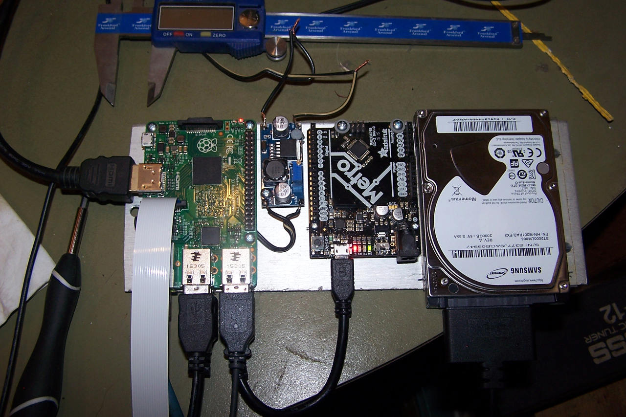

Here's the build - it's going into a cabinet in the wall of my living room, so it doesn't have to be purty:
Just bolt 'em to a plate and screw the plate to the back of the cabinet.

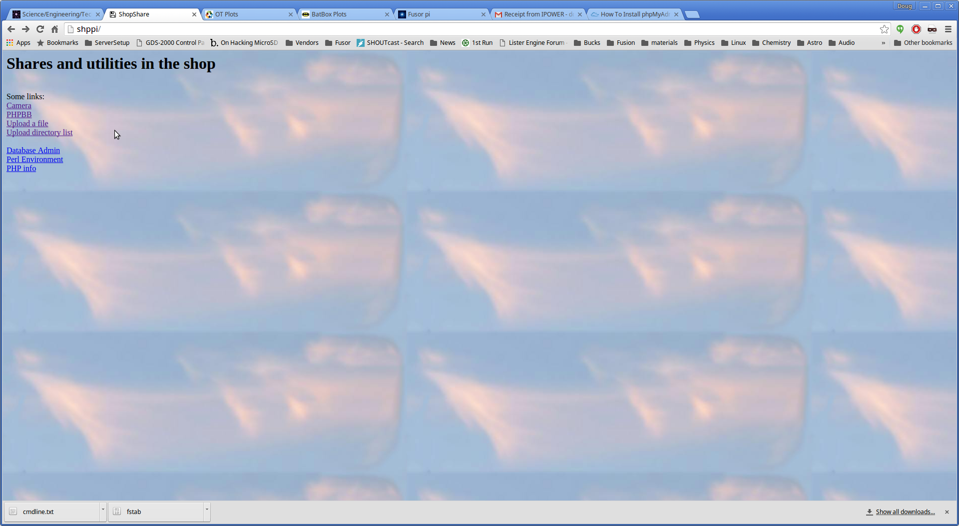

Here's what my web stuff looks like on the pi - and I didn't even have to disturb the cat on my lap to go over there - I got this shot via vncviewer, as the pi is running headless anyway:
Pi screen showing the web stuff.
And here is some of the content. Since this is in use already, I don't include things like the uploads directory (huge), PHPBB stuff (you can download a fresh one, my content is my business) and so on. Just the cool stuff:
