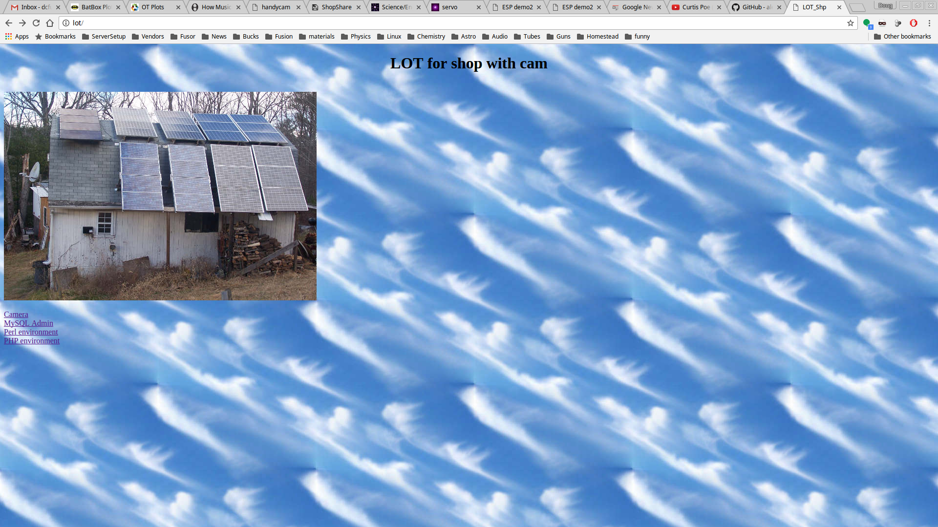

So, at this point, the LOT shop pi emits a webpage that looks like this:
This hooks into my telco LAN, and emits a wireless access point that has a different set of network addresses that are non-routable and non discoverable from the main LAN if I so choose, for security. You pretty much can't find this from the internet, and if you're in my wifi range, you're on campus and inside my kinetic-action range, so to speak...
This doesn't do anything much yet other than exist and isn't even installed in the shop yet - it's in the nice heated space I'm working in this winter for the moment.

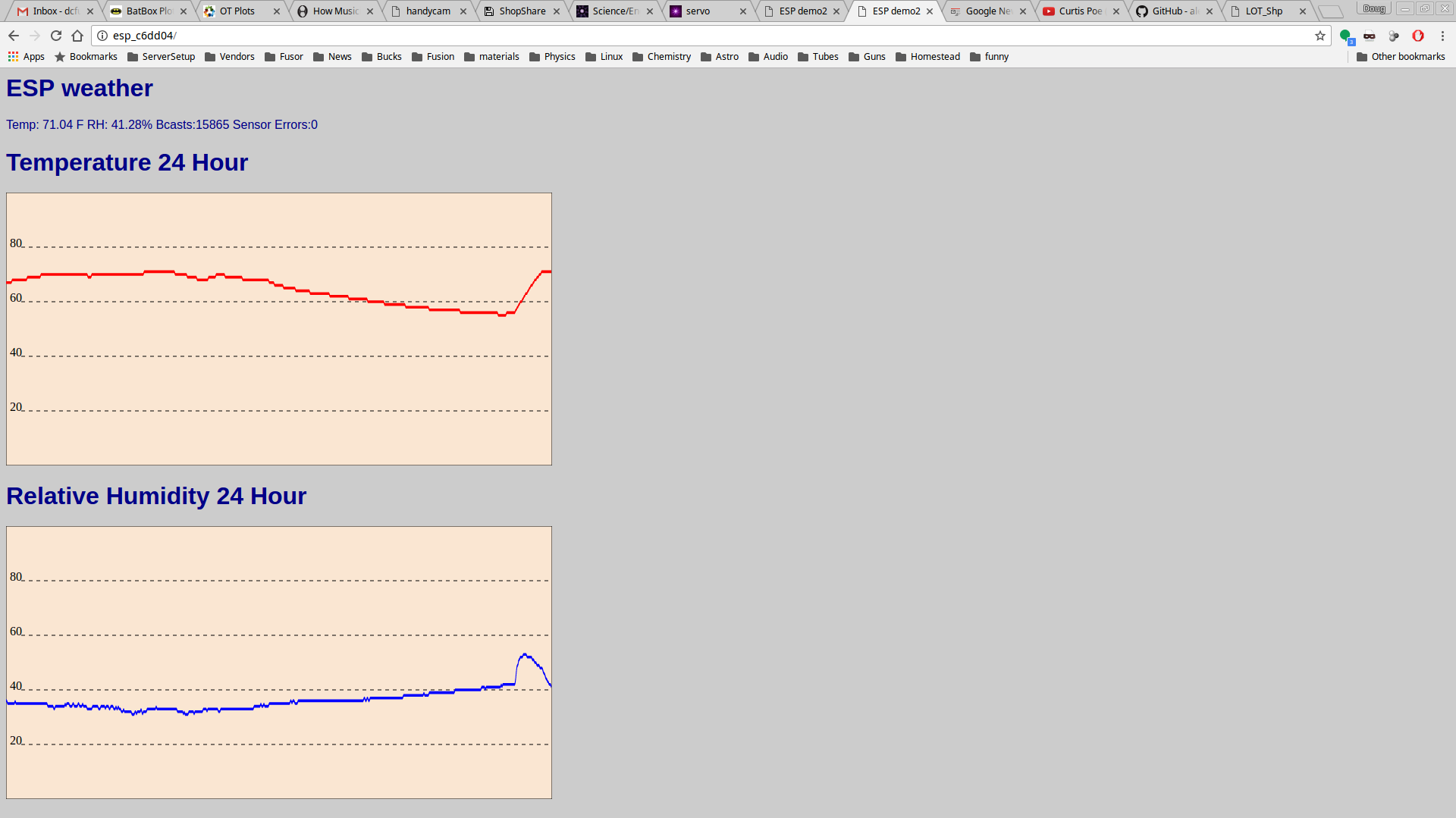

I tried some initial work with the ESP8266's that result in them having minimal web servers for simple stuff. I will probably ditch that going forward and just talk to them from the "master" pi for that building. One reason is there's just no need for that, but the main one is that their webserver is quite limited, and crashes about every 4-5 days for no obvious reason, while the UDP interface seems to stay up even when the web server goes down. But just to prove you can do it, they look like this:
(source code on request)
This is really pushing the ESP (adafruit's Huzzah model) to the limit, resources wise. And there's no point when there's a pi dedicated to this that has nmysql and nginx and gnuplot on it already. The ESP (or ESP+Uno) can just do the real time data aq and control, and talk to the pi for the fancier UI stuff. I am not yet sure if I can do real time hard-deadline stuff in an ESP because it might go off on an interrupt to handle the wifi and mess that up. If that turns out to be the case, that's what Unos are for - total control over timing without any pre-emption I didn't put in on purpose.
This particular shot is from the one over in my living space, since the plot is more interesting - you can see where I turned on the unvented propane heater this morning when I got up, raised the temperature and humidity really fast. The one I'm testing in the machine shop is more or less straight lines just now - that's a lot (many tons of steel) thermal mass and a tight building, if you want things to move, you gotta go over and move them, and even then, it's really slow.
