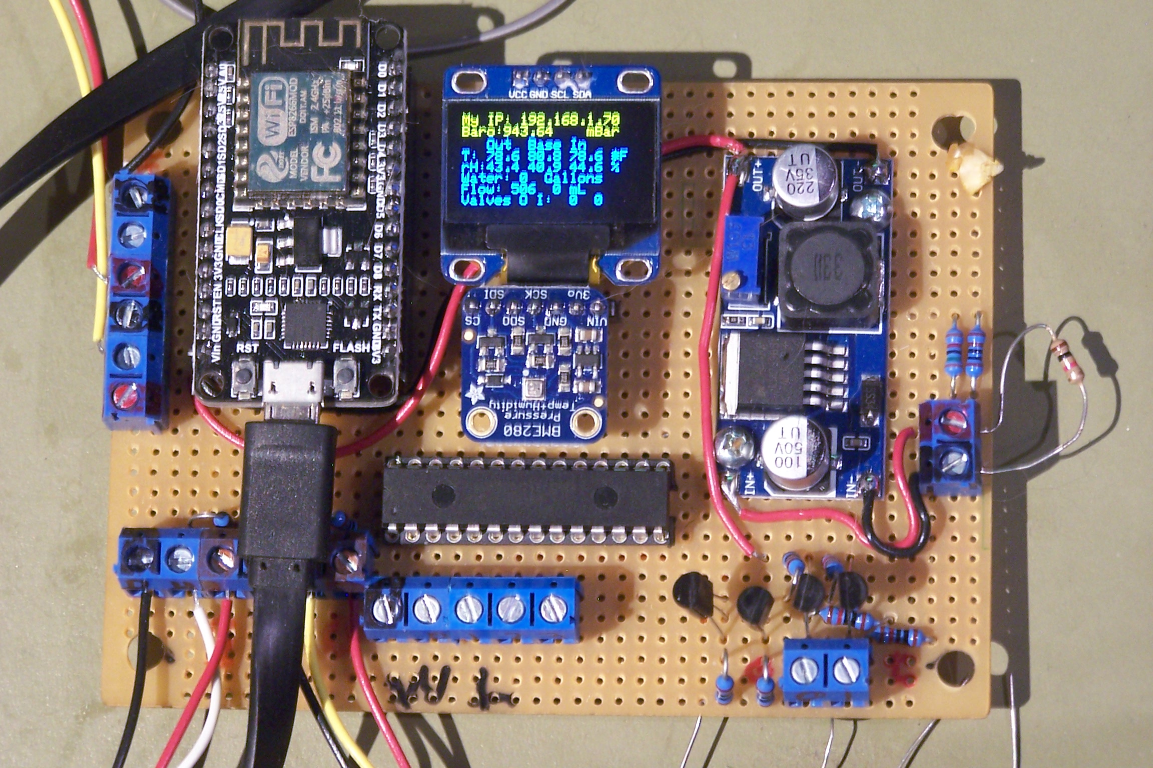

Here's the node hardware, more or less. This runs off the same DC supply that runs the house water pump, and uses some external logic to drive solenoid valves, and obviously some external sensors, but this is the fun part.
The node hardware
