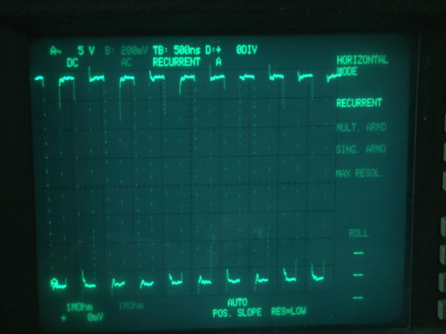

I have built (a year or two ago) a high frequency PSU that can put out a few x100V square wave to a few MHz. It took me about 6 mths to research which components worked sufficiently well to actually do this, then another 9 to build it. Anyhow, I will put up all the details of it here quite soon when I start posting up, in earnest, some of the detail of the experimental work I've been up to.
Here is an example of the output, running ~400 V x 2 MHz into a load [25W bulbs]:

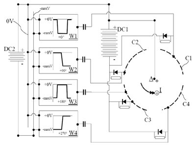

Doug Coulter wrote:I think Chris is driving ion acceleration/control electrodes with this

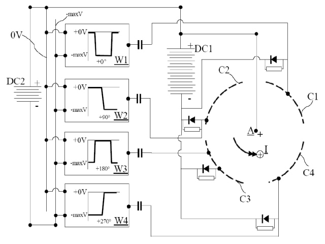

Yeah. The idea is that by creating a rotating electric field I can trap and maintain a circular ion beam (thus requiring only enough input to make up for ionisaton and Coulomb collision losses). So the intention for the circuit implementation looks like;
The theory of this says that the bigger DC1 is, the higher the total charge confinement. But if DC2 gets too small then you loose orbital definition. The limiting case is where DC2 tends to zero and you should then end up with a sort of Penning trap. If you wind off DC2, you face the prospect of losing the 'ion recovery physics' I am trying to create, and you end up with a low-focus cyclotron-like Bq=mw orbit that tends towards a Thomas-focus orbit ['squared off'] orbital shape:
As my device has both magnetic and electric field azimuthal variations, it all gets a bit hairy, and so the stronger I can make that voltage delta (DC2), the [supposedly] better focussed and circular the orbit shall be. You might be able to see from this image the square shape the orbit takes on, hence the desire to boost the available 'DC2' voltage.
This is getting a bit ahead of itself and I will likely need to go over all the theory of this in one place in the nuclear forum for the motivations and origin of this work to make sense. The way this work is going at the moment is that it has already drifted from the original concepts due to side-investigation on side-investigation that have distracted me away from the original concept.

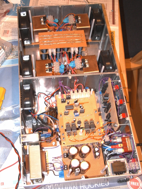

For interest, the insides of this PSU looks like this;

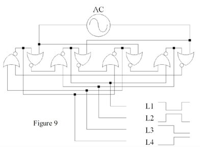

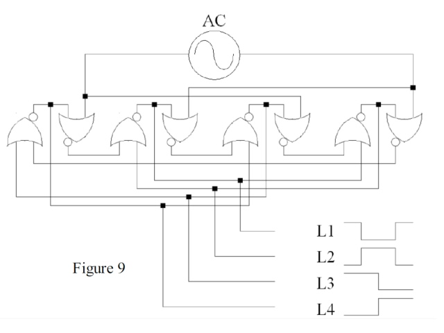

One issue arising is that I need to flick between 4 discrete 'on' states between each of the output states I need, because the signal outputs have to rotate in quadrature. If I do that with commercial grade clocks and some XOR logic, then I end up with switch-on spikes as the registers change. So I also created a 'quad-stable' circuit to do this:
['AC', obviously, means an alternating signal whose Pk-Pk crosses the logic thresholds of the NOR inputs.]
I did try to get spice to simulate this circuit, and I could not get it to do so. This does not appear to be a circuit that submits to usual, or maybe even intuitive, analysis but it does do the job and it cycles discretely through 4, and only 4, output states.
The whole PSU is more cumbersome than perhaps it needs to be because I designed the back-end to be fully-float-able to 5kV and also put safety circuits and EMC mitigation into it. So it has several fully isolated and separate power supplies in it, some operating around ground along with the oscillator circuits, then 3 different supplies to feed the stuff the other side of the opto-isolators (middle of the lower cavity).
