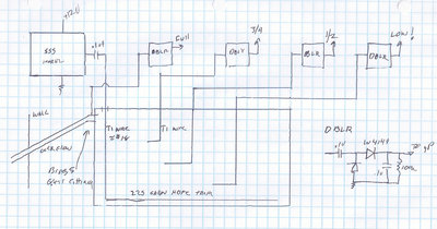

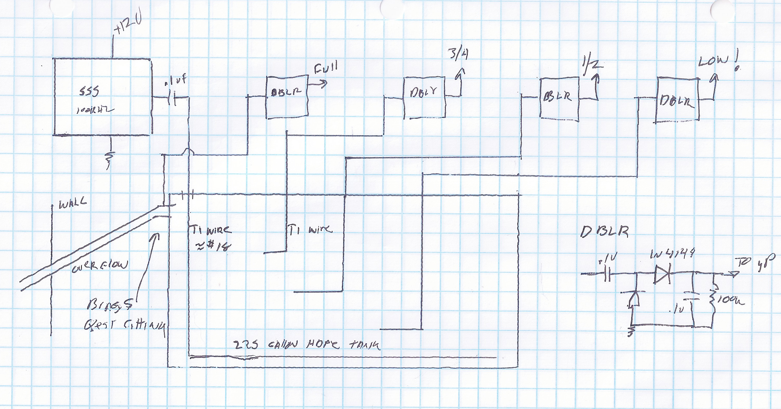

Here's a block diagram of what I actually implemented for my particular case - the concept is actually the important thing here.
Nope, no schiz for the 555 oscillator. If you can't do that, you have no business on this board at all. Any source of medium HF will do here, if it'll drive the load,
it doesn't even need to be 50% duty cycle - that's what the capacitors will take care of to prevent ANY DC current in the sensed system.
Block diagram

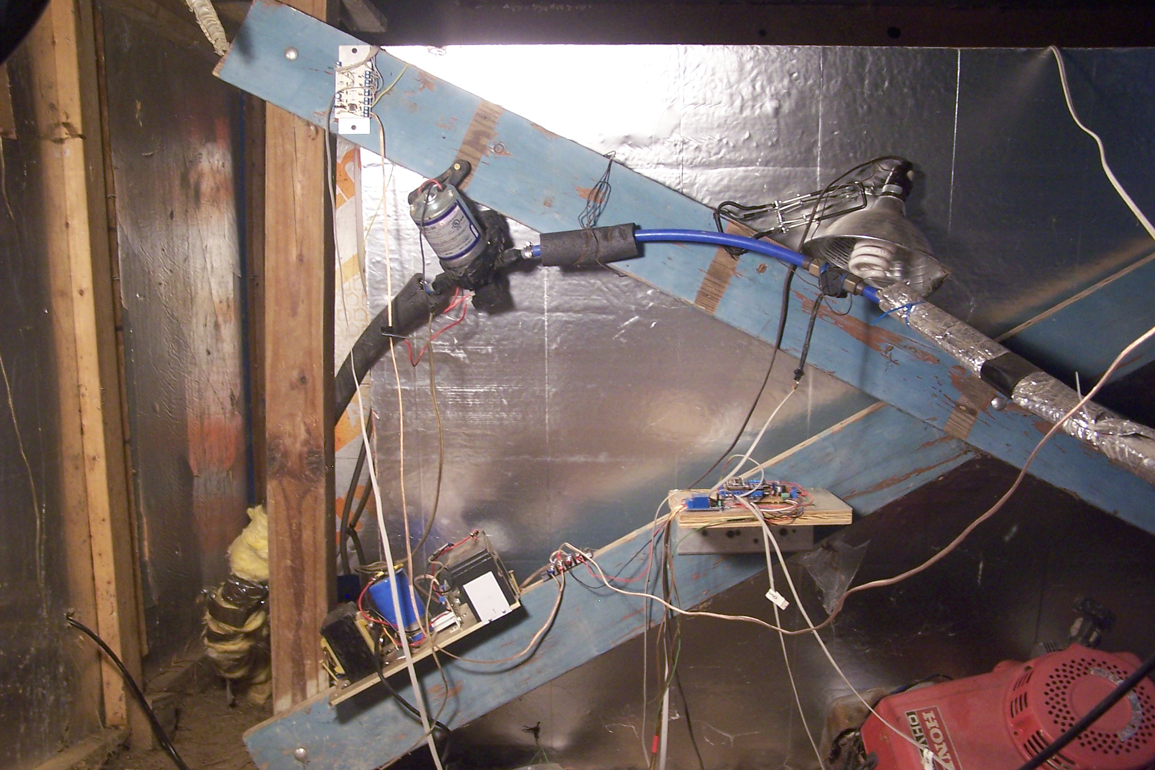

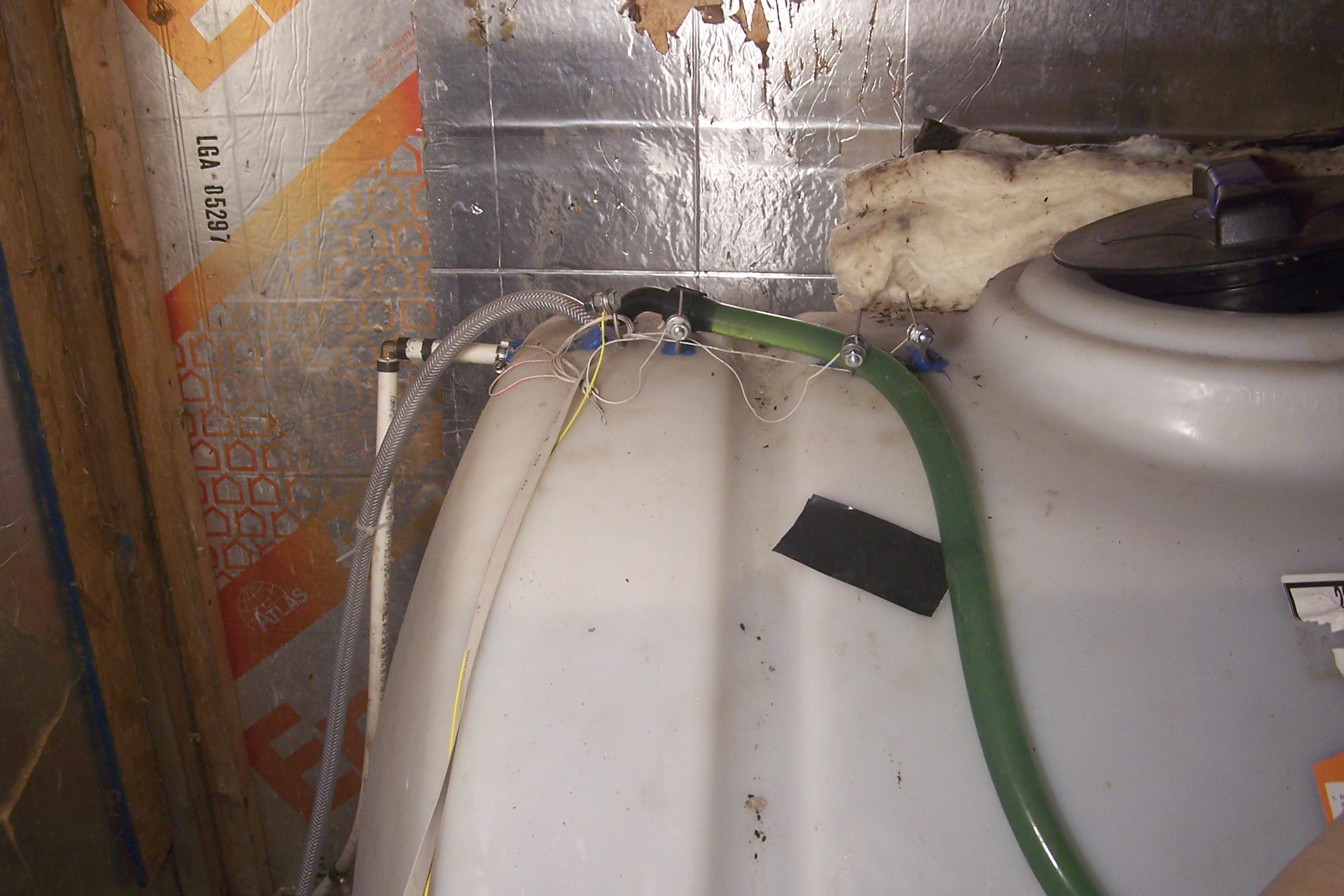

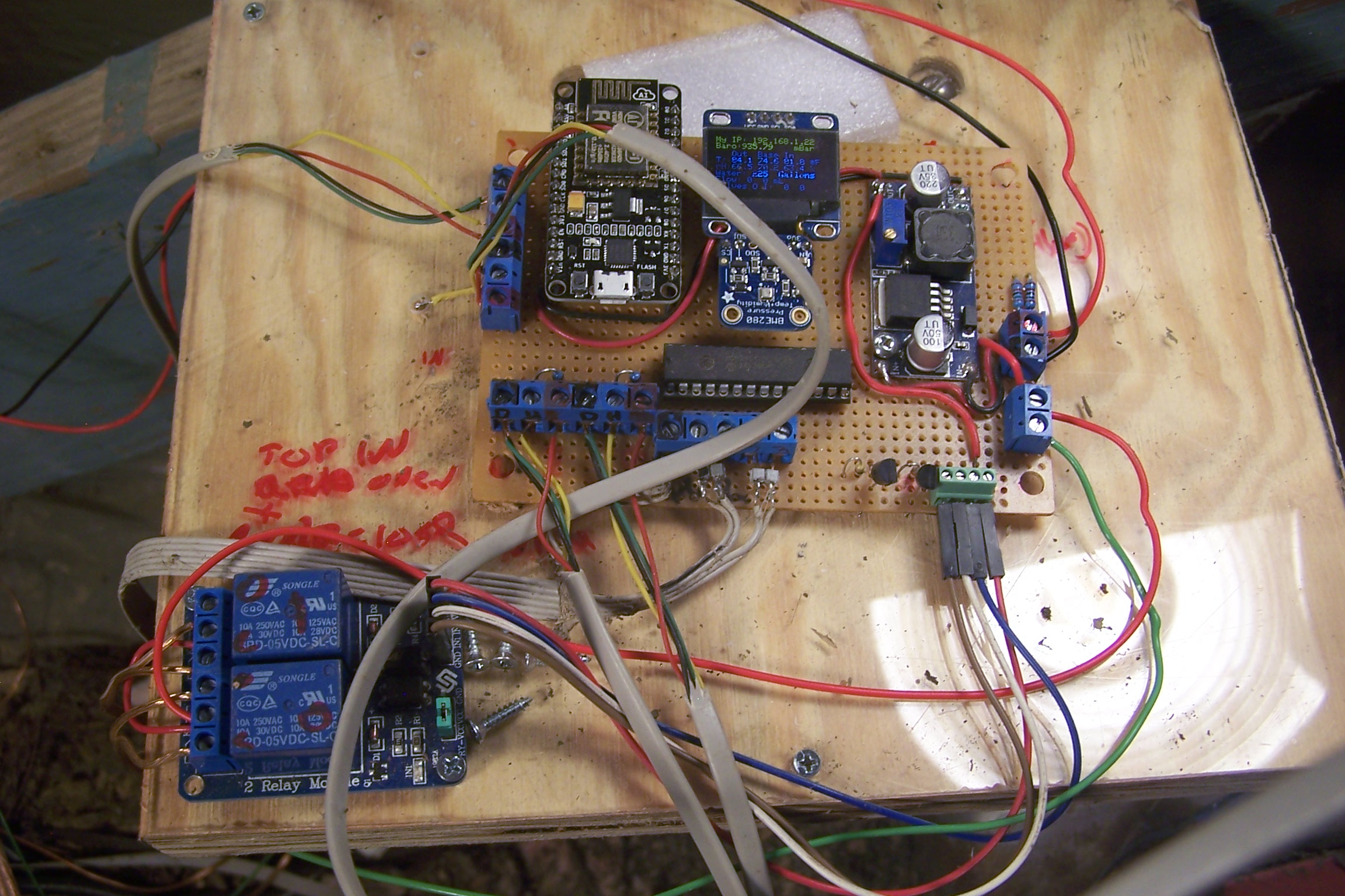

Here are some gratuitous pictures of my setup, including the ESP8266 board (which controls plumbing valves and also senses weather indoor/outdoor) - it acts as a slave to my LAN of things, where a raspberry pi runs a web server (NGINX) and has CGI's to make plots and let me set things like valves.
The sensed object - a 225 gallon tank
Electronics overview, including the UPS and water pump

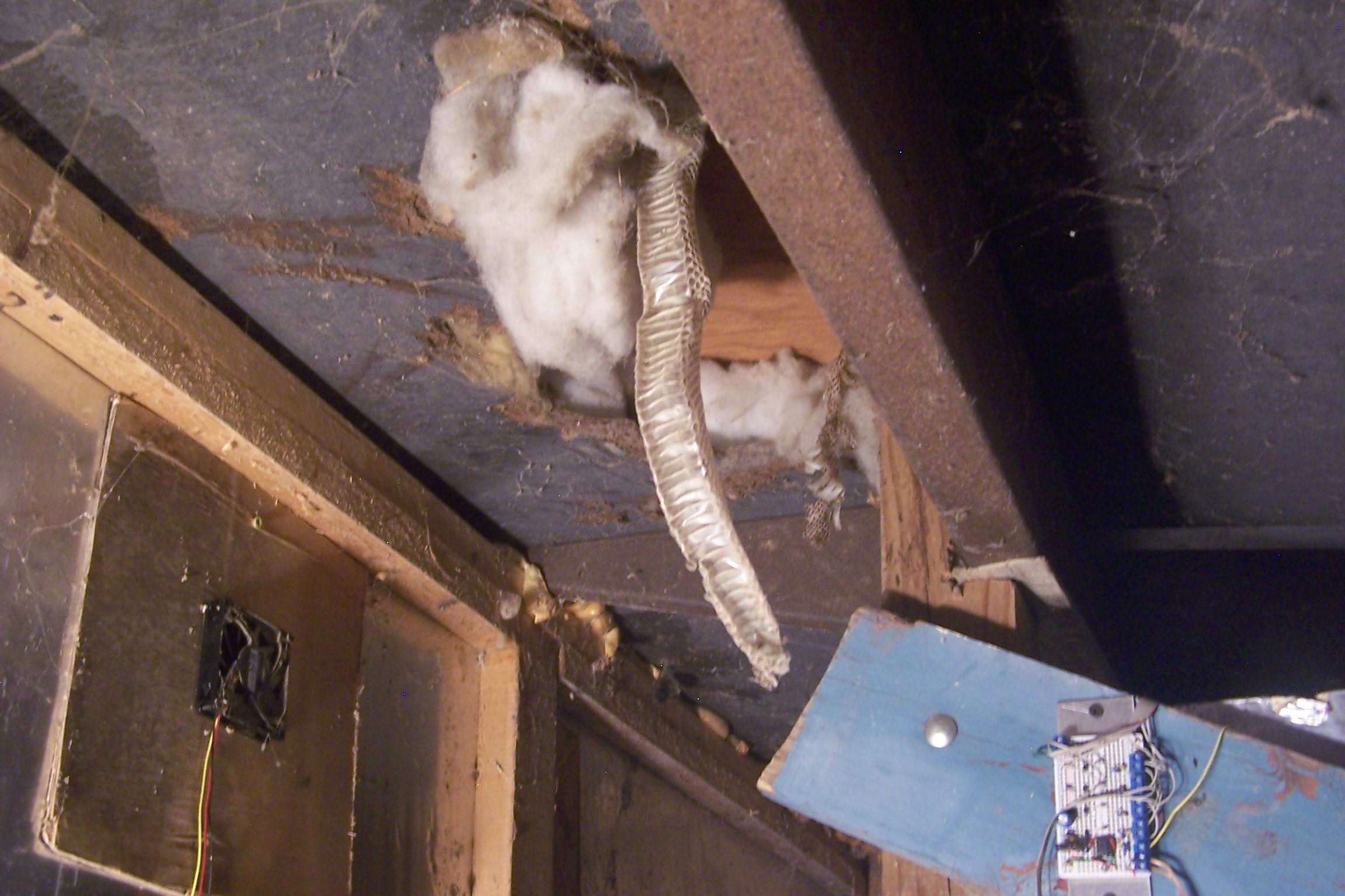

Why'd it have to be snakes? Board in lower right of pic
ESP8266 LOT slave/sensor/controller
I used an MCP 23017 i/o expander on the ESP-8266 to get more IOs for this and valve control. This part doesn't need to be fast, so an I2C interface is fine.

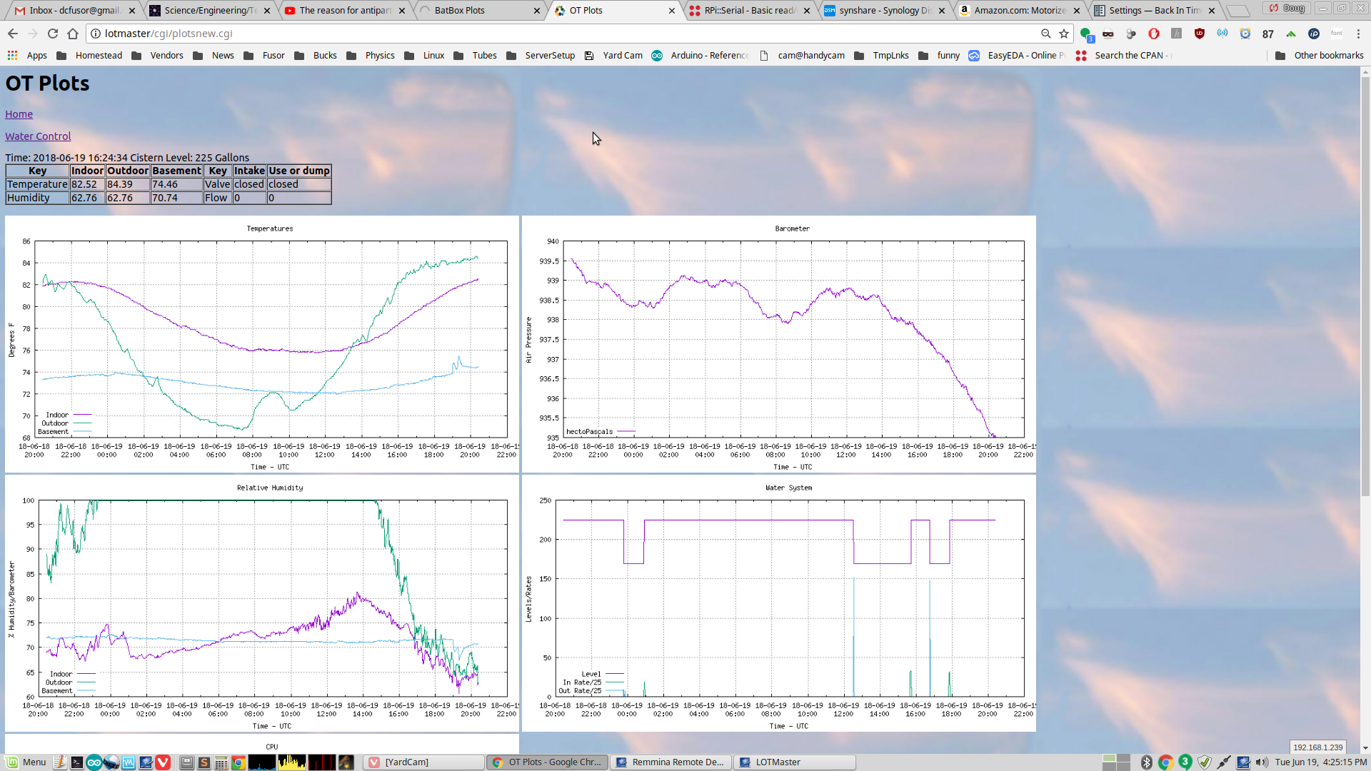

Here's a shot of what I see when I go to the environment page for this building in my LAN of things. There are other pages to control things, and to monitor things like the solar system as well..another day, another post, maybe.
Screenshot of what I see when I surf to this part of my LAN of things.
