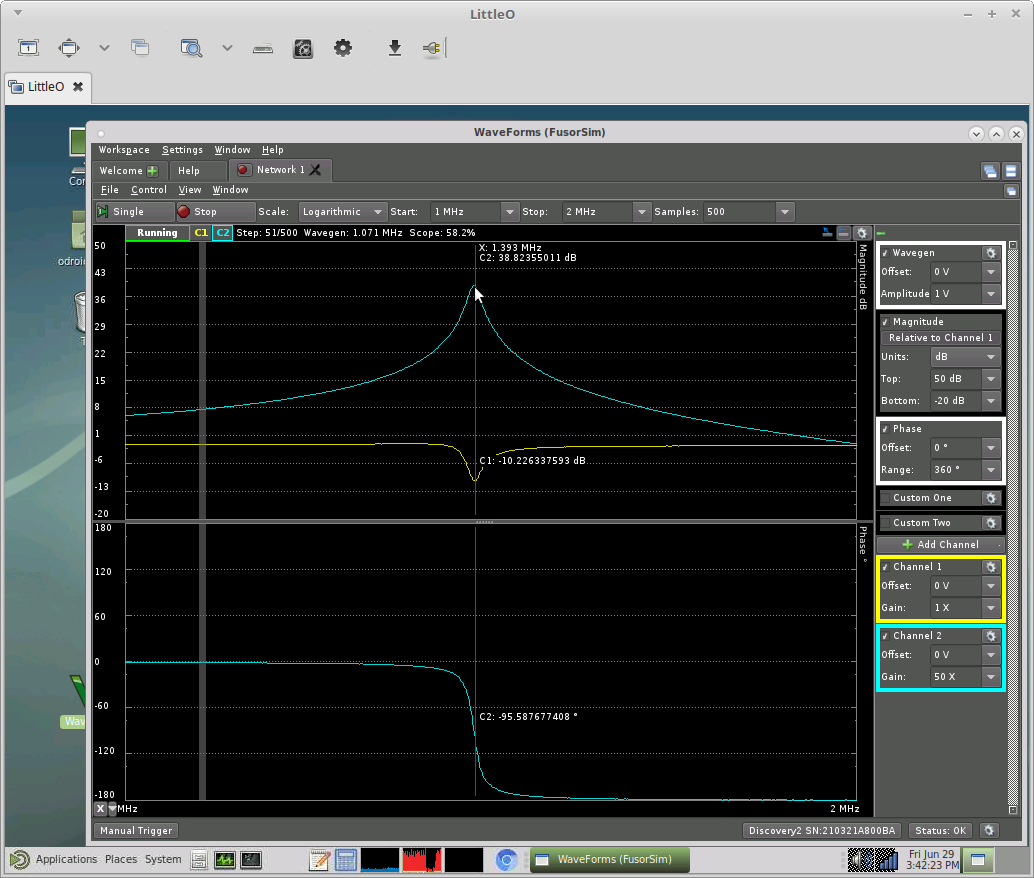

Postby Doug Coulter » Fri Jun 29, 2018 10:46 am
Screenshot of this in action - from my NUC couch computer, over VNC.
Running Waveforms on a series tuned circuit that looks like the fusor with a series L and no ions.
