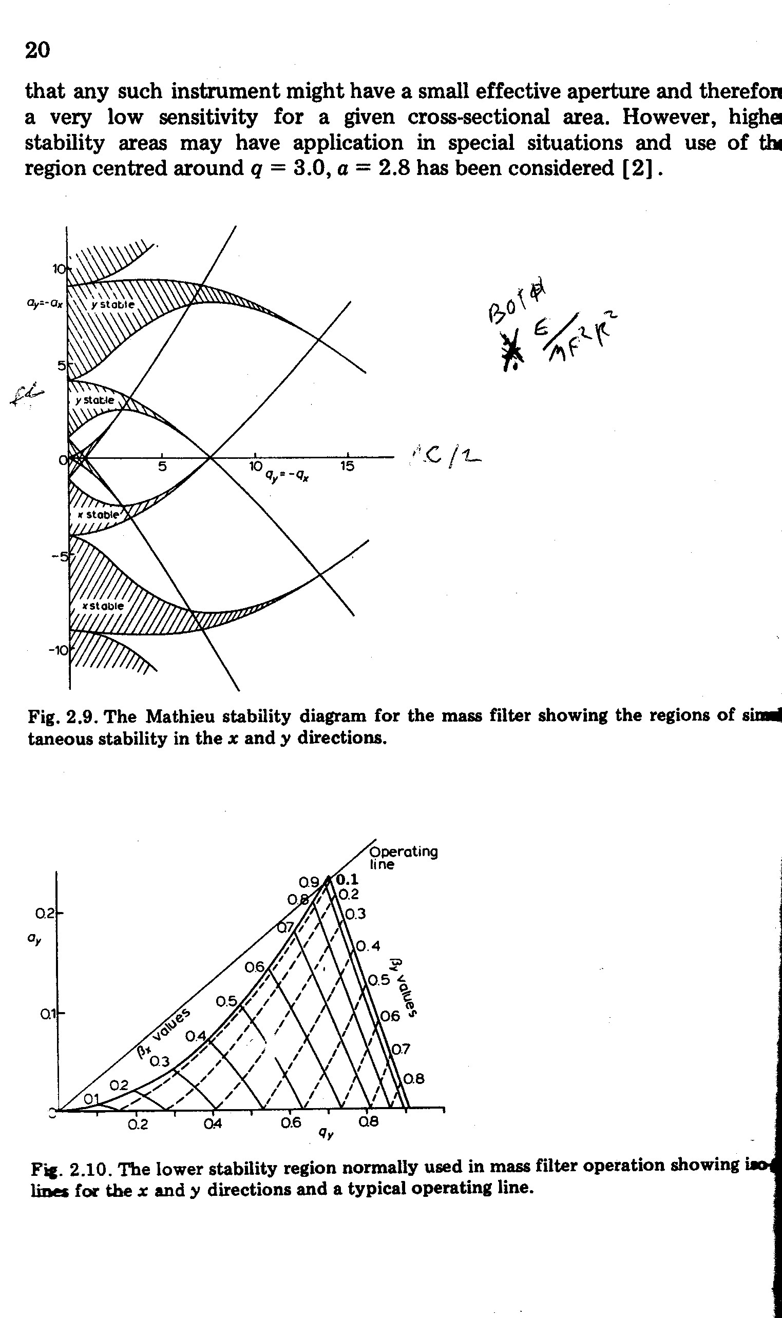

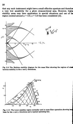

However, the master class (which assumes you know the unit system used, the glossary is horrible on that count) is the book edited by Peter H. Dawson,
Quadrupole Mass Spectrometry and its Applications, ISBN 1-56396-455-4, (AIP) which covers a lot of possible configurations. Seems not much changes other than the factors 2 and 4 in the "a" and "q" equations - which are easy to see in the following code - and at any rate, not all over the place for the purposes of knowing where to begin experimenting.

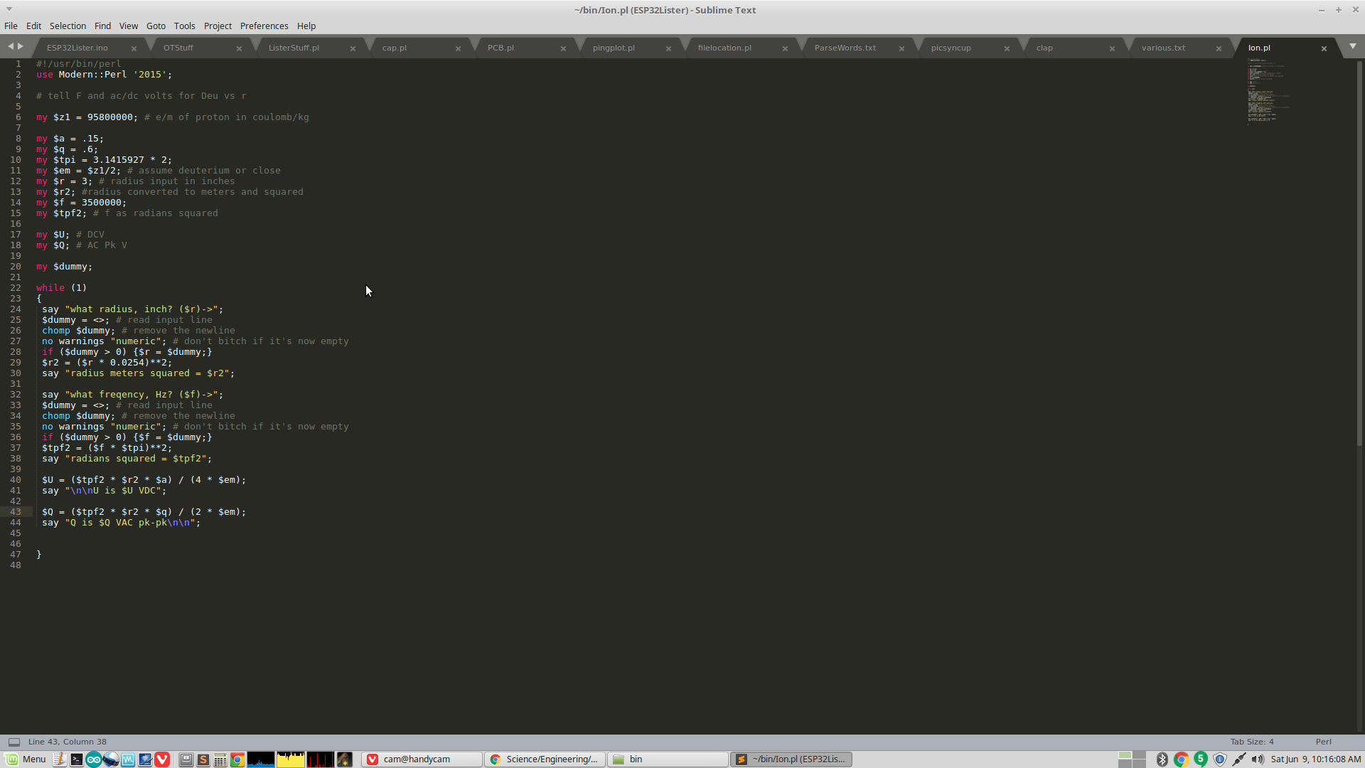

So, here's my simple calculator in cut and paste form:
#!/usr/bin/perl
use Modern::Perl '2015';
# tell F and ac/dc volts for Deu vs r
my $z1 = 95800000; # e/m of proton in coulomb/kg
my $a = .15;
my $q = .6;
my $tpi = 3.1415927 * 2;
my $em = $z1/2; # assume deuterium or close
my $r = 3; # radius input in inches
my $r2; #radius converted to meters and squared
my $f = 3500000;
my $tpf2; # f as radians squared
my $U; # DCV
my $Q; # AC Pk V
my $dummy;
while (1)
say "what radius, inch? ($r)->";
$dummy = <>; # read input line
chomp $dummy; # remove the newline
no warnings "numeric"; # don't bitch if it's now empty
if ($dummy > 0) {$r = $dummy;}
$r2 = ($r * 0.0254)**2;
say "radius meters squared = $r2";
say "what freqency, Hz? ($f)->";
if ($dummy > 0) {$f = $dummy;}
$tpf2 = ($f * $tpi)**2;
say "radians squared = $tpf2";
$U = ($tpf2 * $r2 * $a) / (4 * $em);
say "\n\nU is $U VDC";
$Q = ($tpf2 * $r2 * $q) / (2 * $em);
say "Q is $Q VAC pk-pk\n\n";
It looks like this in a "real" text editor: I didn't do a zip as the above is so easy to cut and paste - the hard part was getting the units right after a little algepbra to solve the original equations in the direction desired - and checking against some working mass spec examples to be sure this wasn't off by 2 pi or c2 and so on.
