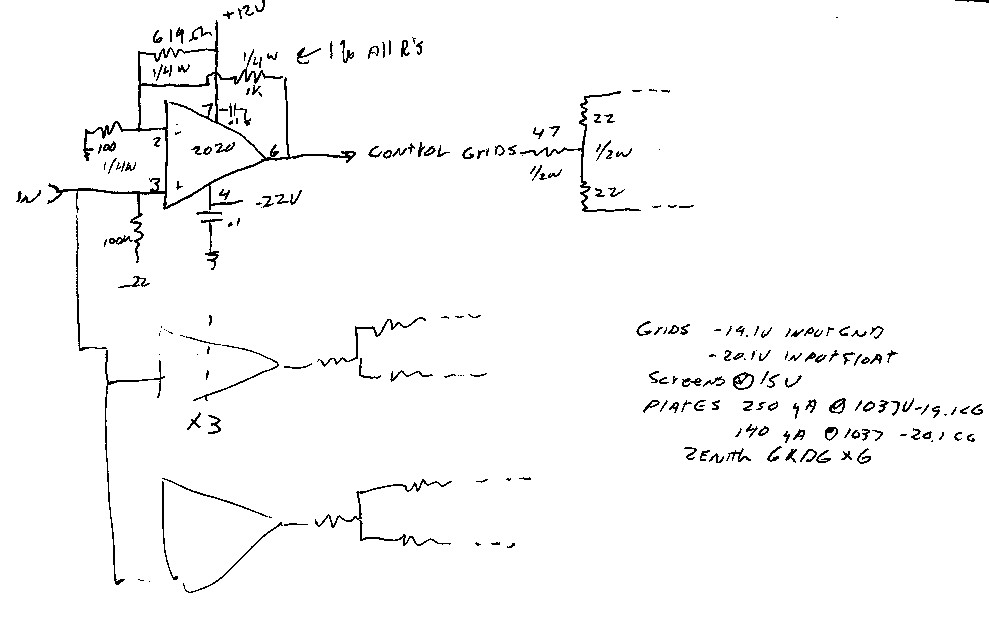

I changed the power supply for the opamps to be + 12 and -22 volts so I could go a little more negative on the output, and maybe run some screen voltage.
To accomodate that and keep the nice (for this) property of it all being cutoff with no input, I changed the offsetting resistors from 1k to 619 ohms. I also put a 100k resistor to the negative rail on the positive inputs (which are all tied together) so with nothing plugged in, it's at the absolute negative limit output of about -20.1 volts to the control grids. With the input shorted to ground, it goes up to -19.1v or so. Both are in cutoff...with +15v on the screens (so...depending, maybe I'll increase that voltage).
For now, not, as I may want to use kickback in the output circuit to get higher peak output voltages at some point - so complete cutoff gives me more of a switch than a linear amplifier, and with the arbitrary waveform generator I can adjust the offset to what I want anyway, should I want to run "more or less pure linear amp" (knowing full well that this isn't going to be the king of fidelity no matter what).
6kd6's are rated at 7kv peak plate volts. I've run them past 12 kv peaks in flyback with no issues if they're turned fully off. They make great switches and decent amplifiers.
During this testing, I had one "rogue" tube in there that didn't match the others, and the plate current in cutoff went to 3-4 ma. When I put in all matched Zenith tubes, it went down to the numbers on the schiz. (I prefer Sylvania for power tubes, so if anyone has a stash, let me know). I have some super-weird GE tubes that are two small sweep tubes in the same envelope in parallel....GE, don't get me started, I bet they're almost entirely unlike a real 6kd6, despite markings.

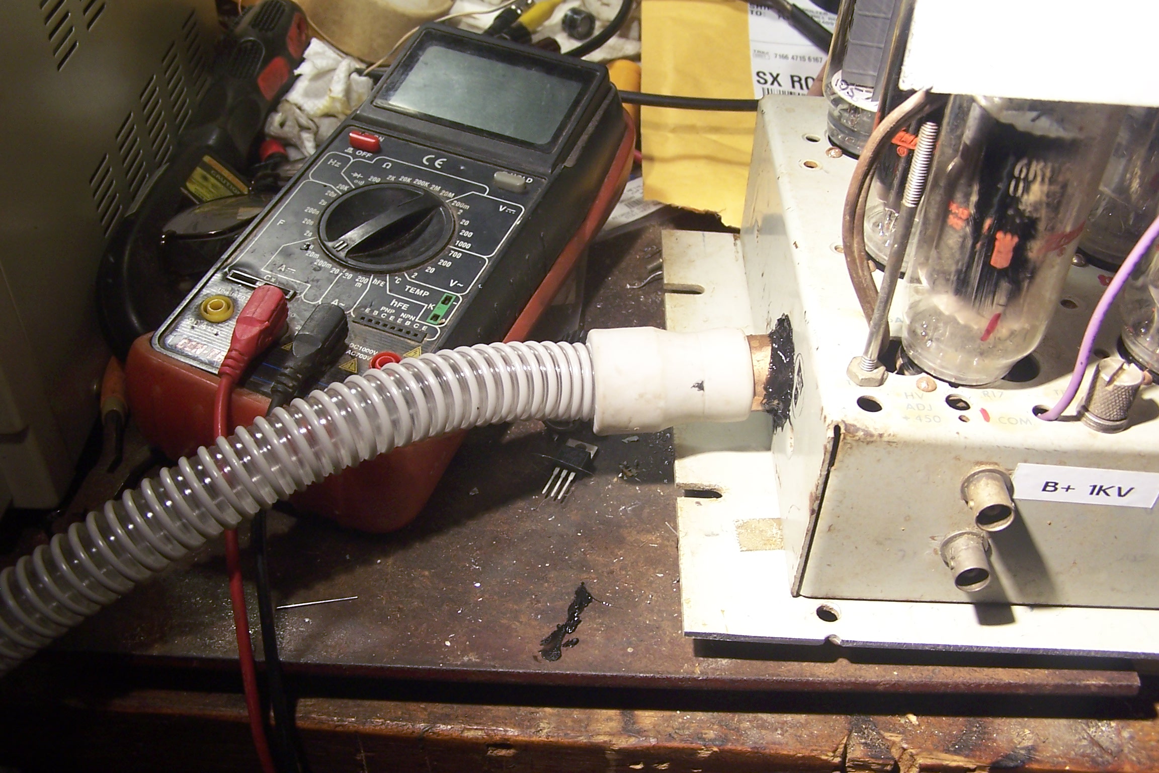

But, so far so good. I have an APAP machine blowing air into the chassis underside over the opamp heatsink I made, then out and up past the tubes...nice quiet blower for this (at one time we scored a bunch of these machines, reprogrammed them to their max output, and use them for cooling other fusor things too - nice and quiet as these things go).
I'm using one opamp per two tubes here as the specs say I can and it seems to work so far (I haven't tried AC real signal inputs yet, just DC bias tests). When trying to drive the control grids positive, they limit to around 5v instead of the 10v or so the opamp puts out in theory. The 47 +11 ohm resistor (effective) plus the opamp current limit agree with this.
Those extra 22 ohm resistors in each tube grid were just there (so I didn't change it, they were mechanically convenient) and used to be all that was there. I added the 47 ohm in series from the opamp output on the advice of the data sheet for driving big capacitive loads - a 6kd6 is supposed to be around 40pf input capacity, and here we have two - a pretty big load for this preamp. That 619 ohm offset resistor is a little more conductance than the 638 ohm calculated, but in tests it works right - the opamp input isn't a perfect virtual ground.
It's hard to believe nothing oscillates here (yet - now go back to your room, Murphy)...I did "the right things" but it usually also takes some luck when there's this much gain and this much bandwidth at the same time in the same box...
preamp schiz as it is now
Belated note to self - "enable" is high true, pulled up to 5v or so internally. Short to ground to disable.

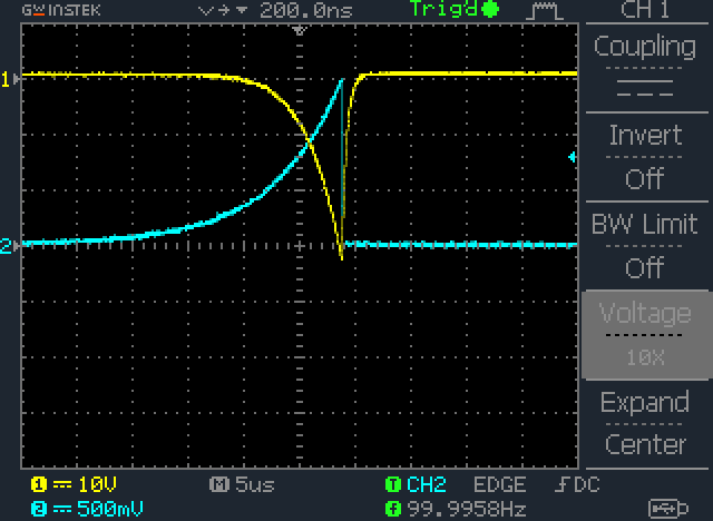

It does seem to have a very slow turnoff time, which is puzzling to me...
This is with a 2100 ohm load (2k wirewound + 100 ohm wirewound), tapped off at 100 ohm with a .047 uf cap to a 10k to ground and the scope. So, roughly 20::1 attenuation.
Doesn't seem like the capacity of the cable to the plates (about 4' of coax) would make it that slow...I'll have to test more.
This is not full drive and you can see the DC bias is below effective cutoff here.
scope, input vs output of amp
So, doesn't turn on at zero - this is easy to adjust for. 300+ma at 1.5v input...not bad. ~~ 630v plate swing here.
I'll have to measure that cable capacity - a really rough slide rule calc shows me ~ 200pf which seems high, but then it was a HV-connector cable, not a normal type of coax (scrounged thing, I didn't think a BNC type connector would handle some of the possible HV peaks here).

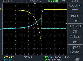

Re: Big Video Amp - more screen volts
I put the screens at 27.9v or so, which was the handiest voltage I had around that was in range.
With that, the idle current with input open is 4ma, with input shorted to ground it's 7ma (which is about 1v less negative on the grids in this setup).
With a 1.6v input signal, offset .8v, it swings the plates nearly to ground (would be the next major div). Full drive would be around 3v input.
This is with the 2.1k plate load. Note the scope point has an additional ~20::1 attenuation before the probe. Every major div is 200v for the yellow trace.

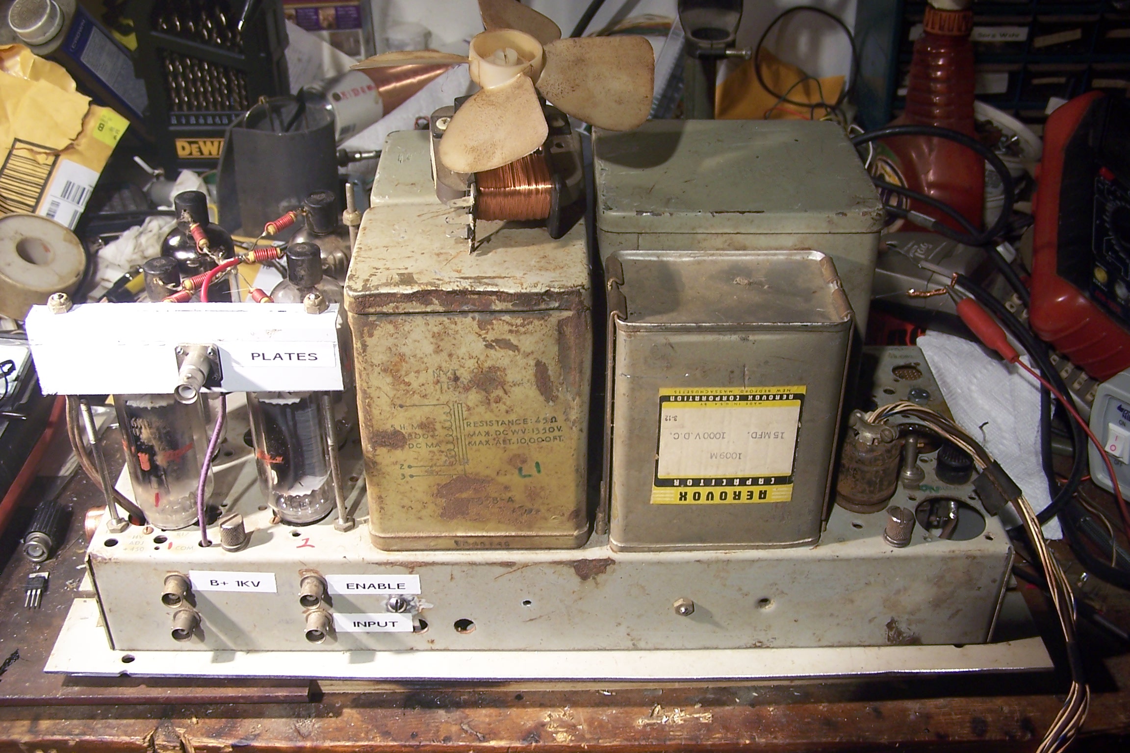

A little cleanup, mount the fan better...and this will be done for now.

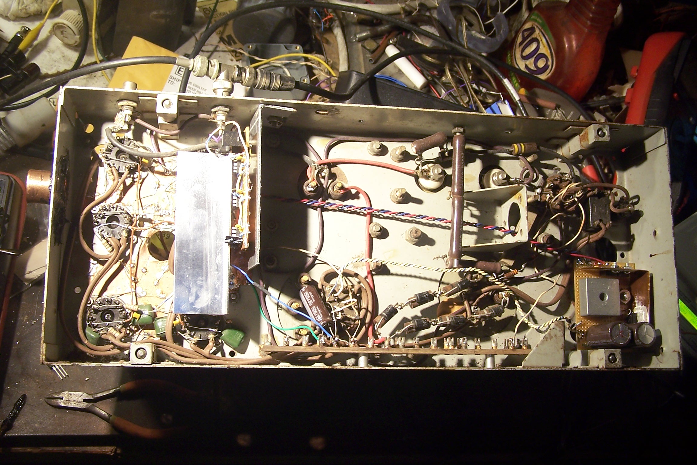

Almost dressed up - no problem with someplace to go.
the nasty underbelly

Gotta mount that fan...I think. But there's some cooling for those opamps and the underside generally via an APAP machine that makes 15 cm Hg pressure - a lot goes through that hose.
cooling for the semiconductors and bleed out to tubes

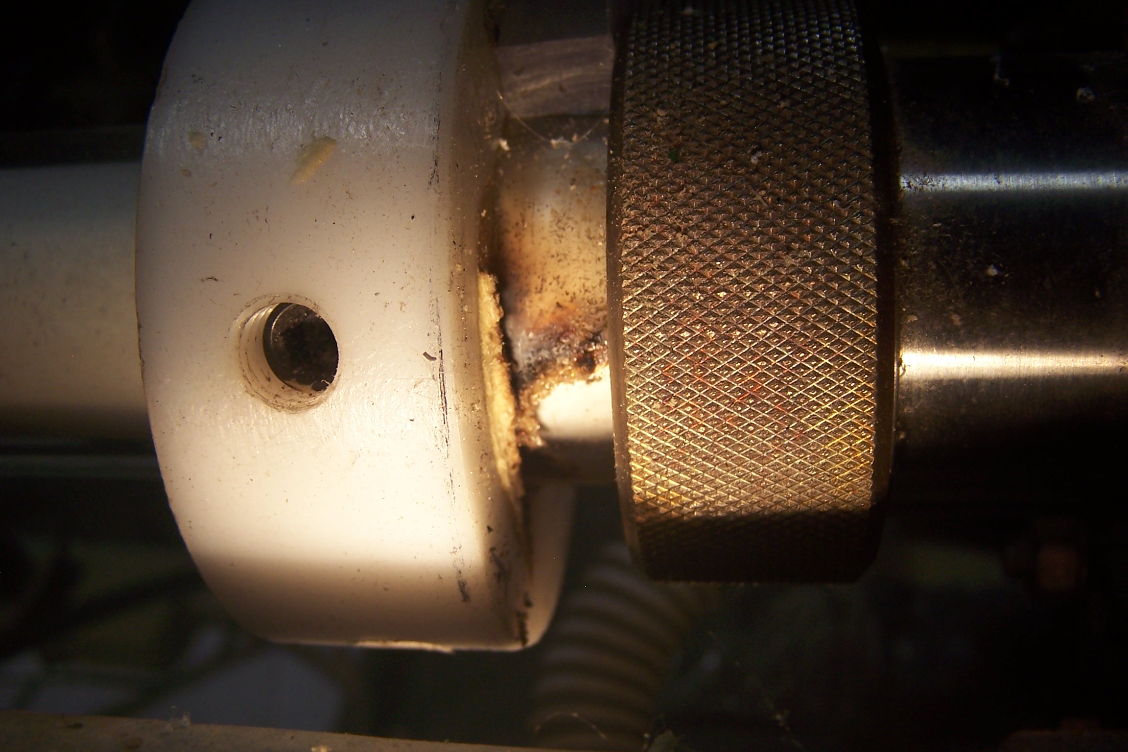

New tests, find new limits of things....in this case dielectric loss probably.
In the video above, there's an HDPE ring with setscrews in it, and a spacer that keeps the feed through from creeping into the tank past the O ring.
The spacer in this case was a bit of "R max" polyurethane foam insulation. Was being the operative word here.
I'm giving away the punch line too soon. I ran up the power, found out how easy it was to trip my "safe space" breaker, so I pulled it down and doubled it in size..
And I smelled burning plastic in the shop..but couldn't find a trace of that in the amp itself when I was in there. Hmmm. I did melt the hot glue holding the beaker windings on - going to fix that - but not the the stink point.
So, crossing my fingers, I ran the power up again, this time higher, as it didn't seem to top out quite as easy...smelled that nasty smell of modern plastic going - surely it wasn't the WWII navy iron - and finally caught the smoke in the act - that foam spacer. Took it out of there after making a clear PVC (yeah, I know but in a hurry) ship to replace it temporarily and it looked like this - having burned itself and even melted some of the hdpe.
After some prying and scraping
Cleaned that up some and now it draws less plate DC current for the same output voltage, though I'm not completely sure I'm trusting that HV probe at this point - seems a little low for the watts while the neons around the place are HOT RED, a lot more so than with the knight-kit 40w amp (as it should be). With 10x the power in, I think I should see 3x the volts, more or less, and I don't yet.
This is all going to change dramatically when there are ions in there - load capacity goes up, draws current when the output tries to go positive, and loss R goes up, so the series tuned match loses Q and its input impedance goes up (and less step up). So there will be some adjusting to do, and I don't see how I can avoid doing it inside the room unless someone spots me a humanoid robot that can turn tuning dials and pots and flip switches...
