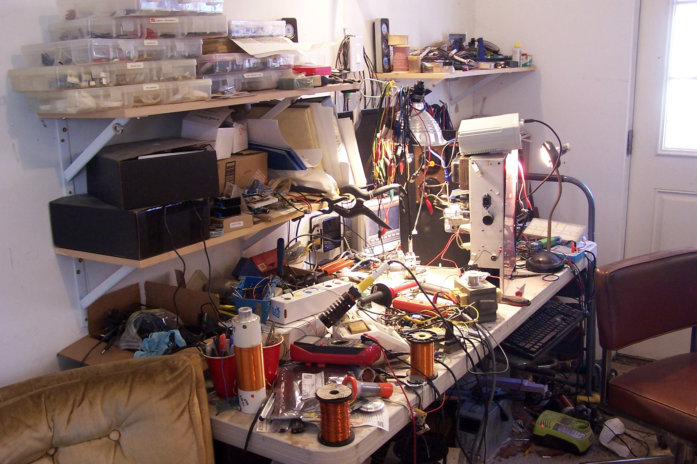

FWIW, the intel NUC you can't quite see in the picture above, just behind the amp, went up in smoke, won't get into bios anymore. I'm copying the disk which seemed to have survived now. Looking for a used one about the same generation so I don't have to buy new ram and disk too....this one's ddr3l and sata, much newer and they need ddr4 and nvme. I'm hoping all the pies and odroids on the table and shelf lived...
And this is why you use tubes on fusor stuff - they eat lightning and don't even burp loudly.

Looks so far like what fried was the wifi card in the nuc - the antenna is in the top plate and is apparently what saw the "hit" - which might have been just plain capacitive coupling....thank heavens it boots again now that I took that out - and now I should add some deliberate shielding there I guess. These compact little things aren't easy to get apart to modify, but in this case, it might be worth it. Even used ones sometimes are north of $1k. (saw one for $2300 on ebay, but I think that was a stupid-tax collector trying to score). And that's for the 4th generation (Intel is on 8 now, moving to 9).
