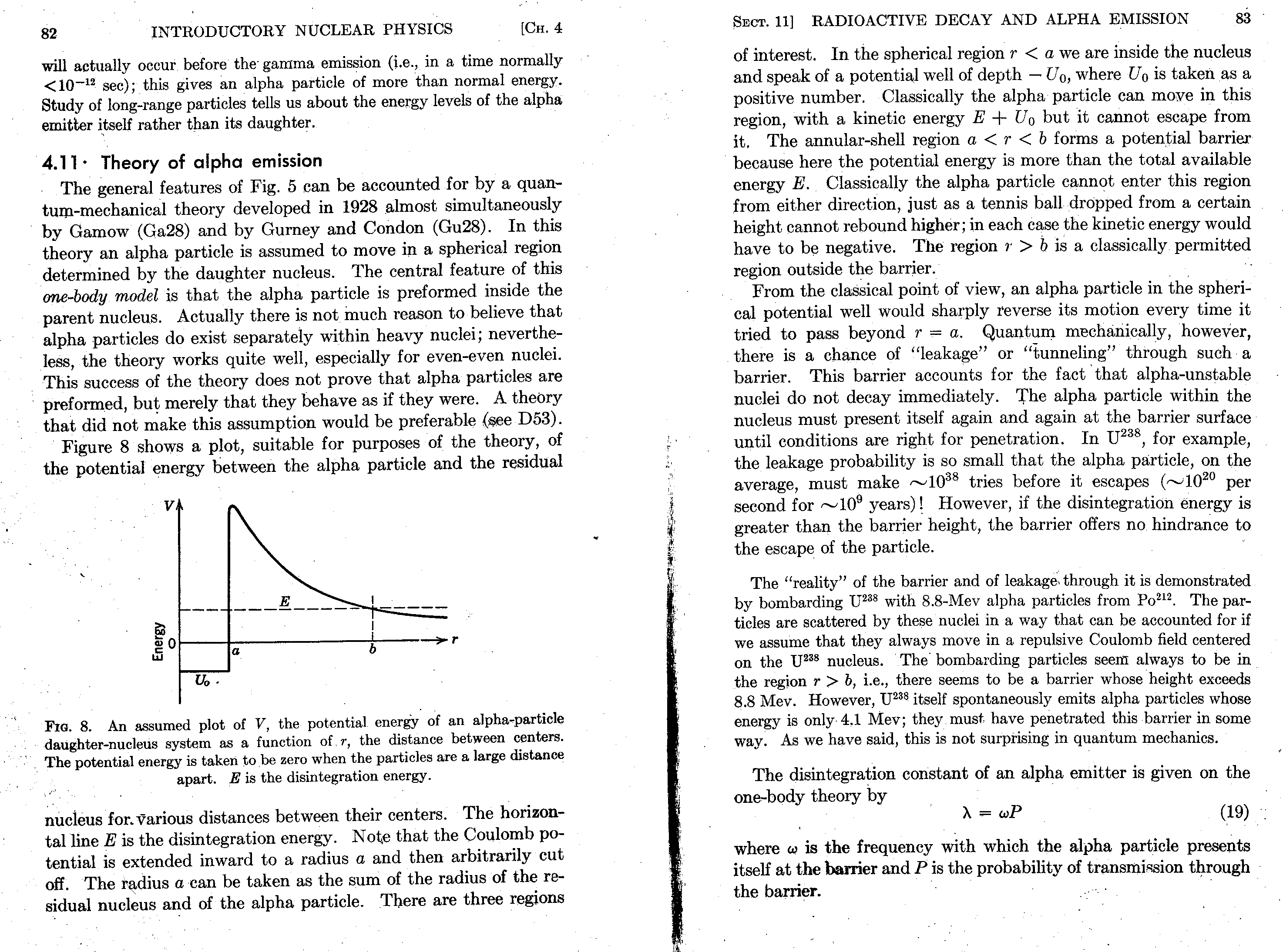

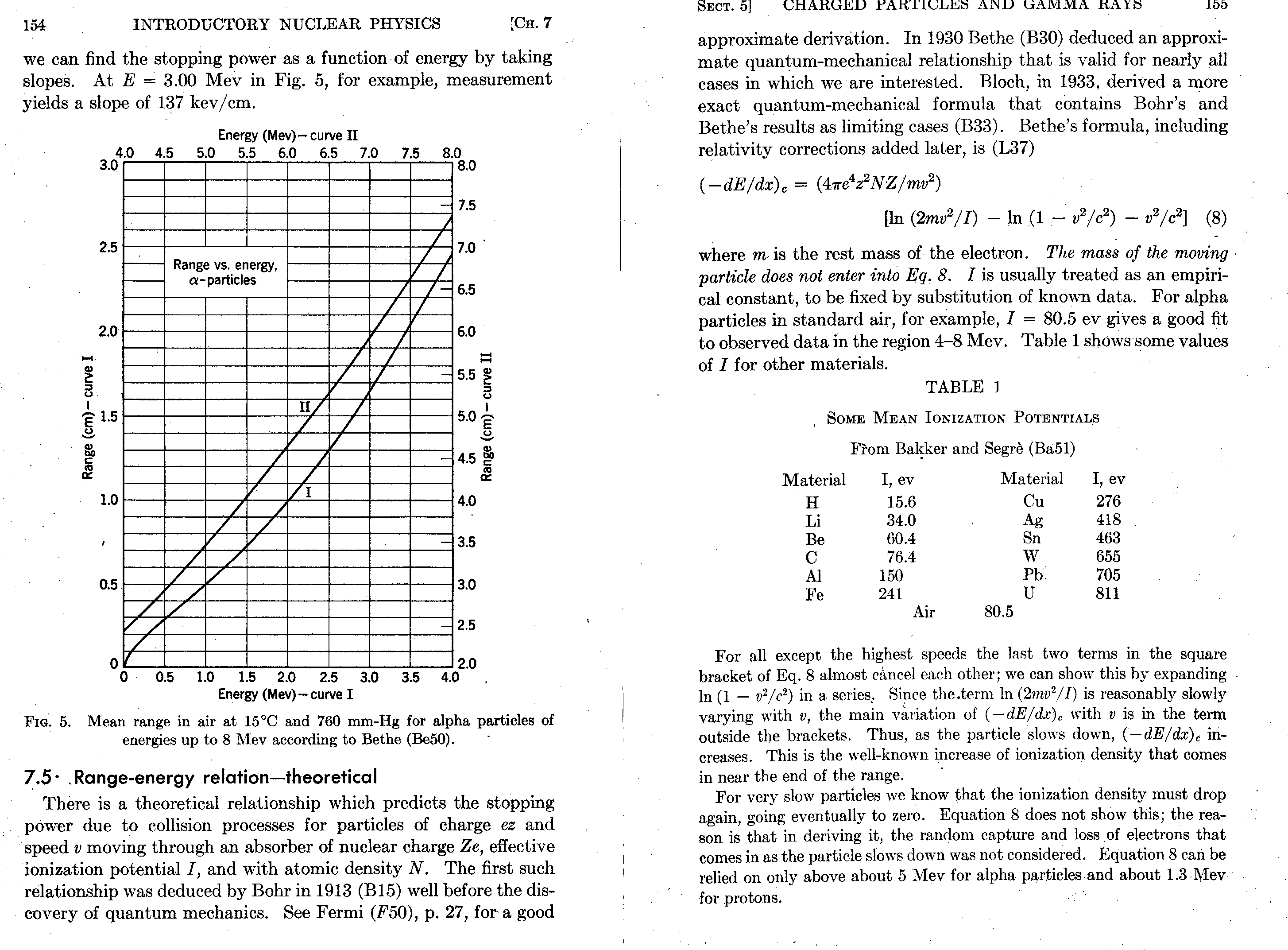

It's hard to see how neutrinos would affect alpha decay if the models are correct....all that normally should take is something that gets the internal sloshing in a nucleus going better, or less random -- which normally takes megavolt energies, though a little energy might give it a bit of bias. Other types of decay have more to do with things neutrino.

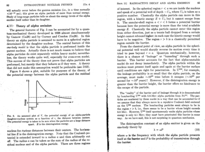

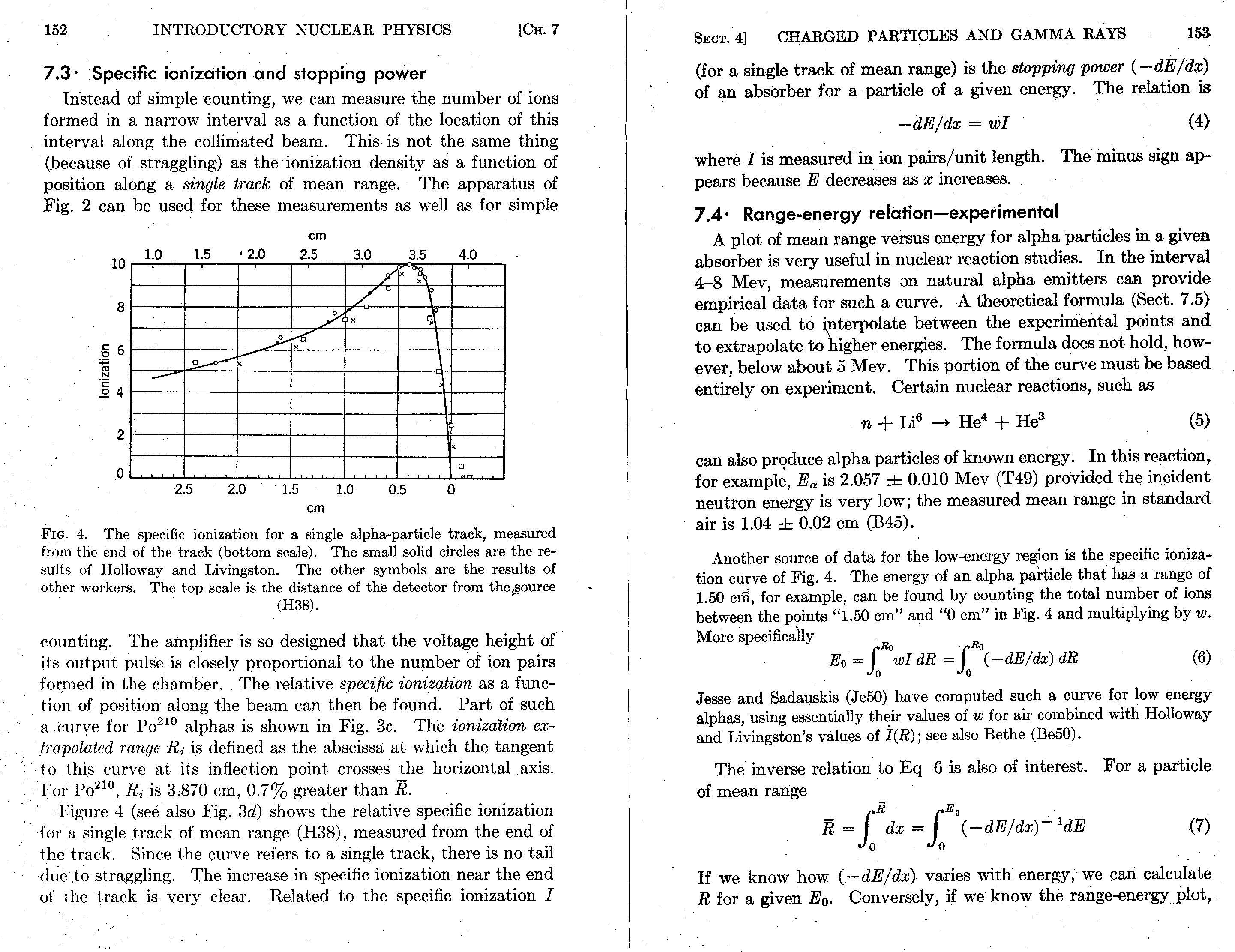

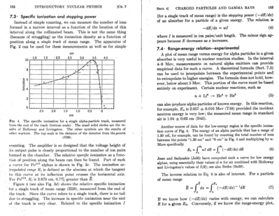

Here's a few scans from Haliday -- Charles, you really want to own a copy of that one (info elsewhere on the board). Here's some theory on alpha decay, that still stands up today. There is a huge correlation with half life and alpha energy -- just a little more energy makes the half life a very lot shorter.
(this leaves out some details elsewhere in the book re fine structure) Here's the ionization produced by an alpha vs distance from the source. As you can see, near the end of their range (lower energy) they do more. This was done with a tiny flat two grid ion chamber moved on a micrometer towards and away from a sample.
As always, click the pix for a readable size view, the board makes thumbnails of anything big. Also, print kinds of stuff is a lot more readable and a lot fewer bits if you threshold it to B&W and make it a gif. Jpg's don't compress text very well. (I use "the gimp" for this)

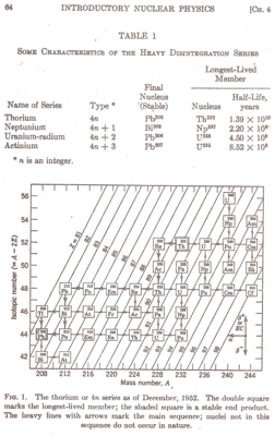

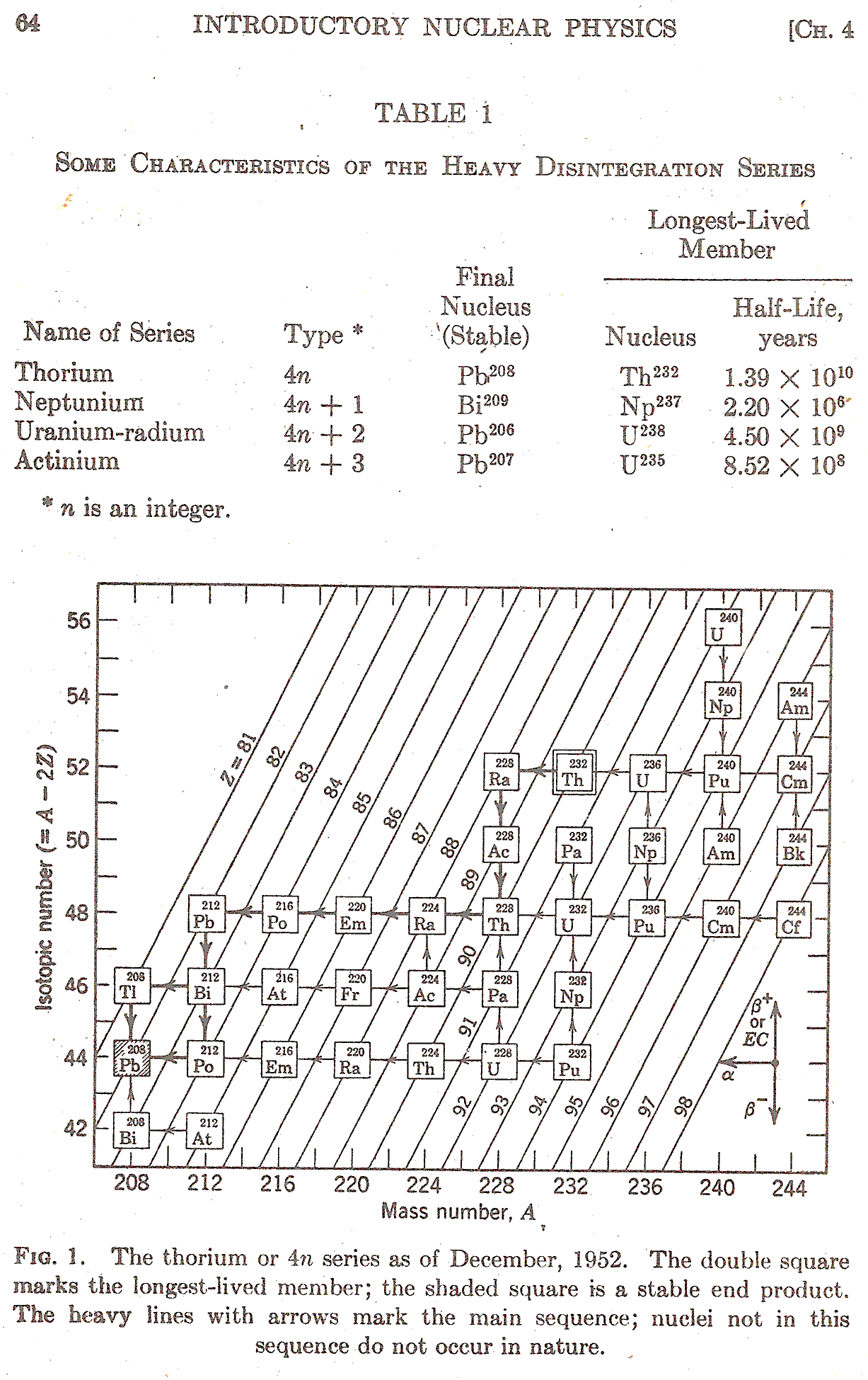

Here is what wikipedia knows about decay chains. This is the neptunium one, and the good news is that it takes a loooonnnggg time to make any radon, so this is a good thing to test with.
And here's what wiki knows about amercium, using their book gathering tool.
