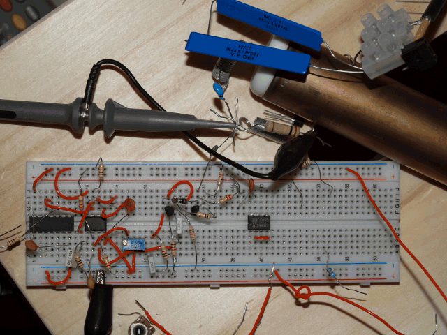

I did say I'd wait for different components. But call it an obsessive-compulsive thing; if I can spend time trying to tie up a loose end, I usually do. So another day was 'spent' fiddling.

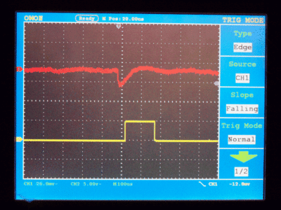

And... success! First off I picked higher input resistors than Doug's circuit as I felt this was a problem before. I replaced with 200k and 1M off the pnp base. This suited the BC557 I was using perfectly at 5V, which is where I will be running it (through a regulator, so as to keep a 'known' voltage setup). I think the BC557 has much the same voltage characteristics as Doug's choice and even slightly higher gain, albeit worse noise/speed no doubt.

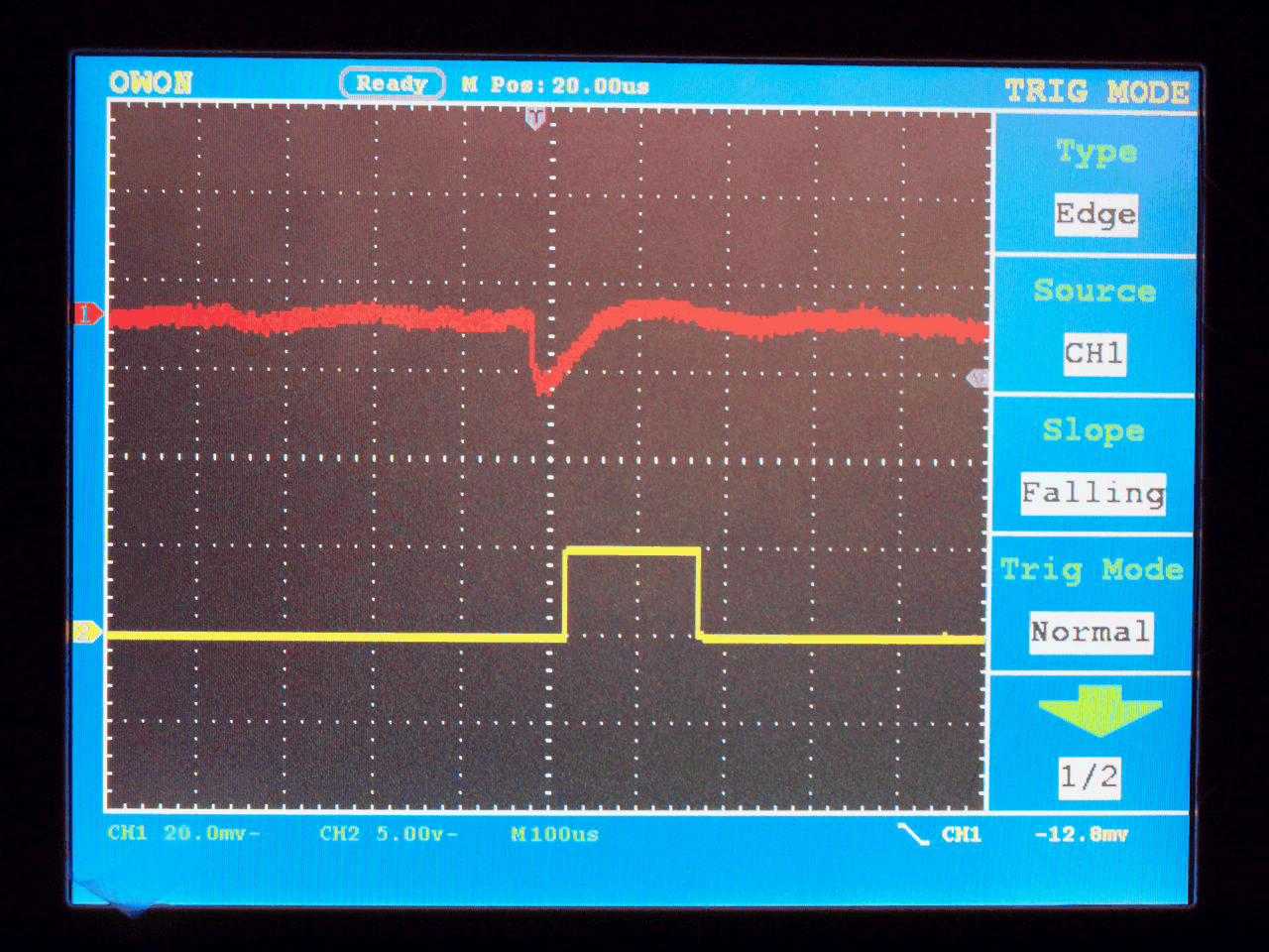

After various fiddling, I got a nice copy-cat trace giving me a 200-500mV response to a 10-20mV input off the tube. Joy! That's a signal I can now do something with!
It then dawned on me (a 'doh' moment) that Doug may've picked the 15k with a view to having the tube output come straight through the coupling cap, as per the tube spec sheet with the resistor tying it to ground. So I decided to ease off the high resistances to see if that gave a bigger response. It didn't. But what I did find later on (during various experimentation) that the circuit sometimes went a bit potty after turning it off/on. I'm no whizz with such things, but it seemed to me that the circuit was self-exciting itself on my breadboard. Not altogether surprising, but I went back to the higher resistances anyway, 200k and 1M, and the problem went away.
I then put the signal into a LM311 so that I could threshold it against a voltage set by a 220k resistor and 10k pot, to give ~0-200mV setpoints to threshold with. Then I fed the 'pull-up' [low] side of the LM311 into a HEF40106 to clean up the signal.
Initially I got a lot of 'bounce' from the noise being carried through in the signal, so I changed it over to a 'pull-down' output with a 10nF cap to low, which removed the bounce completely (I used 1k pull up and 100 pulldown, so I suppose that's around a 1us RC 'anti-bounce time', much less than the pulse period).
The results are very satisfying:
Here is 3 days work!:
I did go back to 50Mohm to try to keep the pulse length short, but it didn't seem to make much difference. As Doug says, it looks to be a capacitance thing, and this isn't a tiny tube! But it looks like it is going to top out at around 1,000 counts/s, which appears to be the price you pay for higher sensitivity. It does seem pretty sensitive, though. Some interesting 'day-time dependency' I have noticed already - come the afternoon there are so few background neutrons about that I couldn't make consistent progress, then in the evening there are bags of them falling from the skies!
So, now all that's left to do (!!) is solder all the bits up and get used to how it works with some trial background measurements.

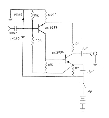

Good show! Looks like so much delay in the final output sq pulse that it could have been looking at the post pulse overshoot...but what works, works. We have this advantage over this non-living stuff -- it has to sit there and take it while you beat on it till it works. But there's usually some beating involved...
The gain of that circuit is set by the ratio of the output collector resistor to the input emitter resistor. The two transistor chain (with the bypassed output emitter) has gain ~ Hfe1 * Hfe2 -- huge.
You can certainly make a circuit with ~60 mhz bandwidth oscillate (bonus if you can get 3 or more frequencies at a time), particularly with all the parasitic 5 pf caps to ground and other signals you take on board with a kludge board. For your final build, you might want to look at the pix of mine -- that one is very carefully laid out, even on perfboard, to limit those sorts of things.
Yes, we just put the coupling cap from the tube right onto the input. I biased it the way I did (and the way I bet you'll wind up with) because the noise injected from a bench supply will definitely create tons of false counts in the presence of a fusor with its little arcs and corona. Hence the use of a battery, inside the box with the preamp, all shielded, and zero ground loop issues where it matters. Even then, there are issues when our coffee can shield is a little loose or all the screws aren't tight.
This required the rather large emitter resistor in the output transistor. The first transistor tends to bias itself to a fixed voltage, which is whatever is 1 Vbe with the bias divider. If no or a very small emitter R was used in the second stage, the DC gain becomes so large that you can't get a stable bias, especially when you're working with 6-9v variability in the supply voltage - areal wide range. There is of course a little DC NFB due to the output collector resistor tying to the input emitter resistor, but that's still too much DC gain to use over a wide supply voltage. And of course, in our case, we were trying for direct drive for the counter, and a few mv isn't enough for that, so I went for gain to get 3-4v pulses directly out of the preamp which at least can go down a cable without additional noise pickup there being an issue. The main trick there was having that much available across the output transistor, and not already all used up in the emitter and collector resistors. If you're only getting a couple hundred mv...it might not be all right just yet. Should be more like 2-3v. Could be you need more HV supply volts? You want to go up into the range where nothing changes with a change of 50v or so on the HV.
If you are looking to get minimal transistor noise, there's often a curve in any low noise transistor data sheet that shows what collector current to bias it to to minimize total noise ref the input for a given input impedance. This is trading off voltage input noise with current input noise in the transistor. I used levels similar to what we used to use in phono preamps, as the impedances are about the same here (the input R). Somewhere in the 50-100 ua region is usually about right (and then you select the input transistor collector resistor to just turn on the output transistor at the resulting voltage drop).

I think the delay is partly my anti-bounce scheme. But what I get in return is a pulse length proportional to the charge in the signal.
I'm also thresholding the pulse quite aggressively. I'm missing out maybe 30-50% of the pulses, but as you mention, what we have in the tubes is a random direction of ionising projectiles, so it should (supposedly) all remain in counting proportion and I can afford to do that with the sensitivity of this tube. A higher threshold also shortens the pulse time a little (gets to the threshold a bit later, and back again earlier).
Also to comment, I do get a bounce after the bigger pusles, suspect that is just the current layout, but, all the same, by aggresively culling the threshold I eliminate the double-count.
I would have liked to do 'no' processing, but there are some benefits to this scheme. Once I collect the pulses I can reject them if they are too long or short. Genuine pulses are in the 60 to 120us range, and I can reject the rest as noise, which is usually 'spikes' (<<10us) or long periods of fuzz that appear in my pulses as a >~1ms long pulse. Easy to reject during collection by audio jack with the computer (also another 'additional benefit' of the longer pulses this tube makes; we're talking 'AF' here rather than 'RF'!)
Yes, I would have expected a bit more amplification here. I don't know which way you are suggesting for the resistor-calc gain, but if I am using 1M feedback then presumably it should've been more gain? May be it isn't because of something to do with the particular output from this tube. Also, I am using a 2n5551 as the npn, which has a slightly different 'on' voltage - do I need to find one with the same 'on' voltage as the pnp?

The gain is set by the negative feedback from the output, through the load R, to the emitter of the input. The circuit is an opamp with open look gain >>50k, so that ratio sets the actual gain. The bias network has no effect if the emitter of the NPN is bypassed as shown -- there is no AC signal on it at that point (the .1 uf being huge in the context of the speed of a pulse). There is, however, some DC feedback there, to help it stay biased in range as the supply voltage changes over 50% or so with a battery. This keeps the bias resistors from having any effect on the AC gain as a nice by product.
(I'm going to go find the schematic so I can see what I put in for the pnp emitter resistor, be back soon) OK, it's 10k/2k, which in the standard non-inverting opamp formula gives gain of 51 (with a hell of a lot of loop gain to make it frequency-flat). You can check that with an audio input and just scope both input and output. Should be dead on at 51 and not vary with supply voltage at all. I used the rather large 10k value as the only bad effect of the high impedance is to slow down the pulse a little bit when driving capacitive loads like coax, and then only on the transistor turn-off side of the pulse. During the onset of the pulse, the transistor drives as hard as need be (that negative feedback loop) so this impedance is different on the rising and falling edges -- this doesn't matter in this case, as the onset of the pulse from the tube is fast, and so is the preamp. During the back side, the pulse decays slowly, and so does the preamp. If you want to use tweaky words, it's an ideal "matched filter" for the actual signal. In this case, it lets the design draw lots less power, which is what I was after. http://en.wikipedia.org/wiki/Weiner_filter
Theres no need (and no desire) to match the Vbe's of the transistors, just bias the pair up right it all that's needed. Here, I specced a fast, low noise, low current "audio" transistor for the front end, and a regular old switching NPN for the output, because noise doesn't matter there, but output drive peak current does -- again, even a tiny cap, like a couple feet of coax, draws infinite current with 1/infinite risetime. I did it pnp input, to match the signal characteristics. The pulse turns that one on (well, both of them), which is quicker in transistors -- on time is faster than off time, which also matches the signal here. While turning on, full current from the tube is hitting that base, during the off time, only the bias R is turning it off, so the speed is asymmetric, again, just like the signal. Gives a little extra noise rejection without actually slowing anything down. The fact that the pnp collector is driving an AC short circuit makes it faster, as it doesn't have to charge any capacitor (internal to the xistor, or external) during the pulse. The input to the second stage looks like a short circuit to ground for AC.
As you can see, there can be a lot more to even a simple circuit (or would that be especially a simple circuit) than meets the eye at first. This was all pretty well thought out.
I've been using variations on this circuit since about 1972, when I stole it from a Marantz tone control buffer... It's pretty good for many things in the mid low-level domain, as changing the various values can set it up for fast or slow, low noise for a given impedance and so on. If this guy doesn't do it, you can go to a more "heroic effort" but usually you don't need that.
Edit: Added a copy of the preamp schiz so you don't have to flip around to see what we are talking about here:
edit: modified diagram with battery symbol reversed
The protection diodes should be 1n4148 FWIW, unless you have low leakage versions of the germaniums shown.

Yeah, that diagram confused me at first, before I went 'doh' after wiring the neg to 'earth'. The battery symbol should be upside down - it's the earth being pushed up so should be attached to the 'long' line.

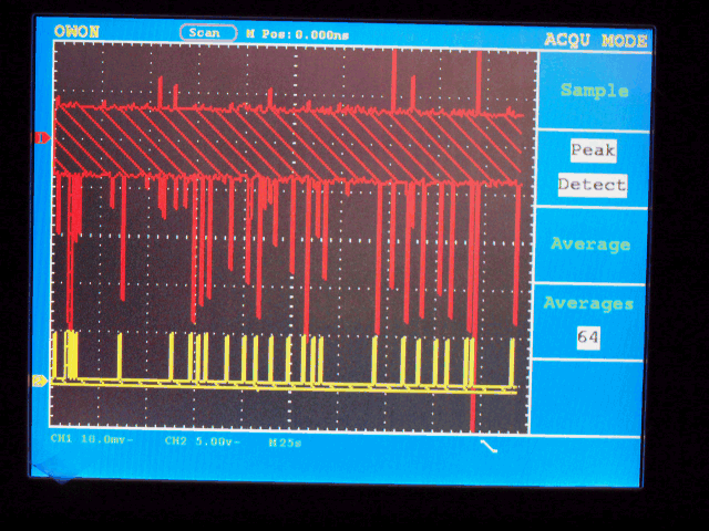

I had a poke around on my 'scope and, cool!, it has peak detect also! Well, it should have, seeing as it is only a digital function. I think it is absolutely a great bit of kit for £200. Impossible to do this stuff without it (and, indeed, it was impossible for me to do it when I first got these tubes... 'cos I didn't have it!!)
OK, so the longest scan is 200 s per division, but you'd not see all the background signals if I used that timebase, so here is one at 25 s per division (i.e. ~5 mins total horizontal) on peak detect:
I set the threshold to ignore anything below 0.2uA ( which is 20mA looking at this plot as I have a 100k to ground). I'm not really missing many potential counts, whilst not getting any false ones. It even correctly missed out on a few 'noise' spikes (such as where it matches the spikes above the top peak) - I have an additional 150pF in series and stuff much slower than a few 100us doesn't get through. (The only one that did register wrongly was when I switched off the light which was next to the bread board, at ~220 s, just before I took the shot of the 'scope screen in the dark!)
I also connected a 220k resistor and a small cap back into the feedline off of that crate I posted on last week (which is providing the 1900V I am running the tube at). This gives a 'kick' back down the line for the electronics to register, which it does perfectly without any multiple counts (providing there's no noise, of course). So, potentially I might make up a box to connect this with the crate, then it'd be a fully sealed box with just the screened power coax running into it from the crate. And I think I can also run this just off an internal battery for a long while - the power supply wasn't registering any current at all to run it, when it wasn't counting, so I ran it powered up through a 10 ohm and got 20mV drop. I think if I assume 5mA, conservative, then that's probably about the current draw, which'd mean a regular 9V battery should power that for a few hundred hours.

Looking good! I looked up a standard 9v alkaline on digikey and the data sheet shows 100 hours (to 5.4v) at 5ma -- in other words, 5 ma is a real battery-eater. 4 days for a few bucks. Now the original 150ua I designed that to draw doesn't look so dumb. Those specs are always quite optimistic in my experience. There's a lot of air and packaging inside a 9v battery, not so much is actual battery.
