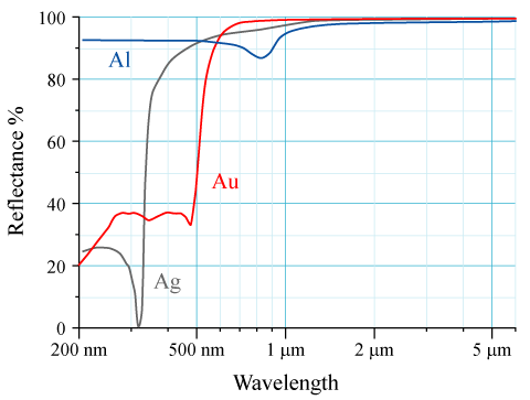

Plain aluminum takes a big dive in reflectivity below about 400-450nm. I can vaporize it right off the surface of the glass. There are UV enhanced aluminum coatings but they still only reflect about 91%. Dielectric is about the only way to efficiently move the beam around at about 99.75%. They are only $125 a piece at thorlabs!

Looking for the charts (haven't found them yet) but Wiki says this under aluminum:
Aluminium mirror finish has the highest reflectance of any metal in the 200–400 nm (UV) and the 3,000–10,000 nm (far IR) regions; in the 400–700 nm visible range it is slightly outperformed by tin and silver and in the 700–3000 (near IR) by silver, gold, and copper.[9]
It could be the best and still not be good enough, of course. I know silver has a hole up there somewhere - you can use it for a short-UV pass filter.

By the time you bounce off a few mirrors to get where you are going the mid-90's add up. Second problem is the power density, the beam output on this laser is pretty tiny, about a half mm or less and stays pretty tight. Add that to a pulsed beam that has peak powers in the 10's of kW, that is enough to vaporize the aluminum.
Take a look at the graph on this page. Typical non-coated front surface mirrors suck at these wavelengths.
http://www.ofr.com/oc-12_metal_mirror.htm

Yeah, I lecture people all the time about what things like .9^N work out to, but it's interesting that even their mirrors aren't claiming better numbers than just plain Al (as I linked above) or even going back in time, John Strong's numbers, even with the MgF. Funny thing that. I was thinking you need at most two mirrors - one for focus to spot, one for XY movement, but I could be wrong about that. No lenses for certain!
