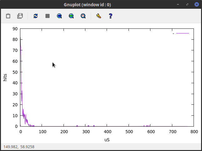

Here's a timing jitter on the pi data aq project. Good enough for what I want - worst ones are in the 600us range, and usually much better.

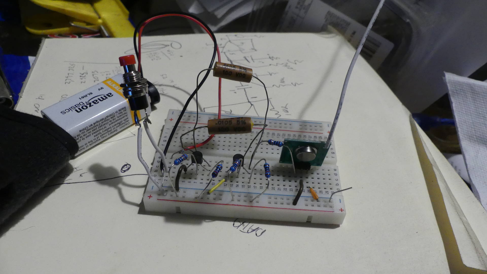

So, I've been "chinesed" on my little mailbox project. I ran across this: https://www.mpja.com/315MHz-Remote-Cont ... /31960+MP/
A transmitter and reciever for ~ $3... for 315 mhz (more or less).
OK, it was likely near-useless for the original purpose, so surplussed, but it can easily be bent to my desires for the mailbox indicator.
It's a Pierce oscillator using a SAW device, one transistor, on-off modulation via another transistor. Simple, almost the same thing I'd already proto'd up, but different frequency, fine.
The receiver is a preamp, a superregen detector, and two sections of an opamp used as gain and thresholding. It toggles randomly in the absence of signal (and also sometimes when signal is there).
No DC restoration, so it'd take some fancy error-detect munging to use for what it was meant for.
No biggie....
I modified the receiver to sit at 0 output with no signal.
I made a little multivibrator to modulate the xmitter with at around 650hz (what I got with standard round number parts values, like 10k, 100k, .01 uf).
I took advantage of the characteristic of the lm358 opamp being better at pulling up than down - it's as good as a diode for this, and simply put

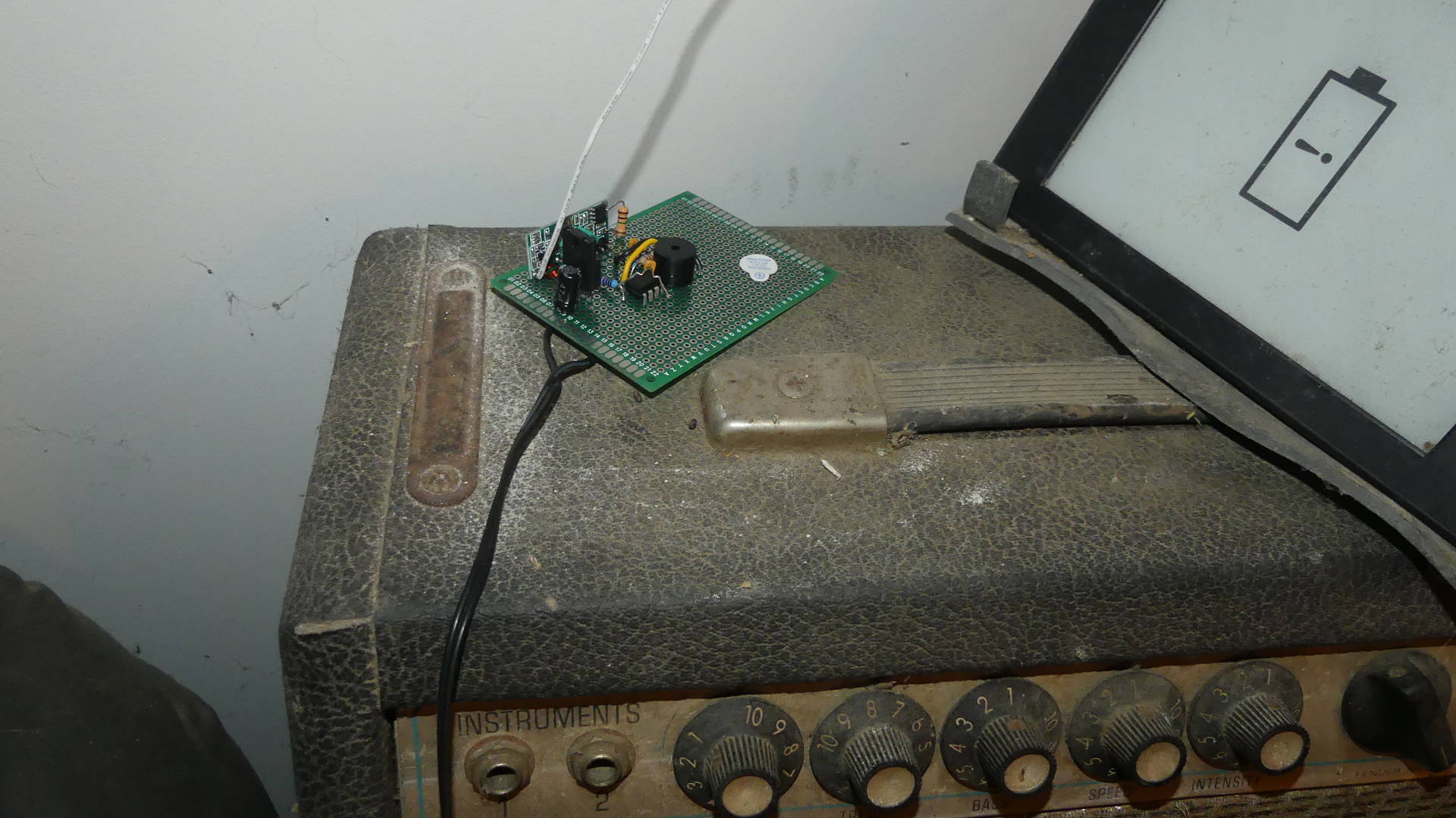

a 100k/.2uf lowpass on the output, feeding a comparator (another lm358) that drives one of those little beepers...and we're done, no need to have a computer watch this, it's been running
a few days with near zero or zero false alarms, and has considerably more range than needed. I'd guess half a click. At 100yds it's near-overload on my SDR dongle.
The plan is to repackage this stuff off protoboards, and put the xmitter in the mailbox, run off a 9v battery and a burglar alarm magnetic switch to go when the mailbox door opens and beep me here inside.
Moderately elegant I suppose, I'd hacve a little more satisfaction had I made the receiver myself, and it'd work better too - but it's that enemy of the perfect - good enough.
I'll do a proper writeup once I get things packaged...with schematics. It's really simple... I'm gonna be real glad when winter abates...between the short (no power) days, cold (takes hours to heat the shop with a few trips to add wood to the fire)...other winter infrastructure, it's been silly busy but not with physics. So I haven't been posting, my bad...The good news is my health is getting better and letting me catch up and even improve things despite weather and "life".
No biggie....
At least this was fun, and gave me an excuse for the RTL-SDR radio dongle I bought for myself, which is a cool toy. Not noise-theoretic or anything, but it's amazing for something gumstick sized.
And it let me measure that this xmitter was really 315.065 mhz...nice debugging tool. It will have some uses on the fusor/ion trap stuff...not to mention just being entertaining.

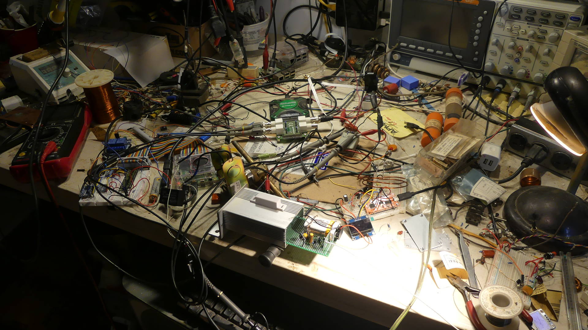

If a clean desk represents an empty mind, well...good things to come? The data aq and control for the new ion-trap recirculation tests is coming along apace. Raspi 4, 8 15bit ch of a/d sampled at 10hz, 2 12 bit DAC channels, and control outputs for gas control valving. There will be an arduino nano clone or two added to be fast frequency and rad counters, and some more a/d and digital io stuff. All that is going into a nice new rack panel to be installed up at the new rig. I'm just doing the coding and prototyping for now, since the weather in here is salubrious compared to the shop. I'm hoping to get automated gas control really hammered down so as to add it to the other fusor setup.
This design looks like it will (finally) be modular and general enough that people might want to duplicate it. I'll be putting the software up on my github repos for that.
The idea is to stuff the acquired data into an SQL database, with a design such that what each channel is, and some code to translate the raw data into real units will also be in a table in the database that can be edited to accomdate whatever lashup. This will be controlled by a runtime GUI program like the one I use now for Fusor1. There will be some nice plotting code that can take the results of a run and plot it, using the schema data and code to translate channels. There will be both 2d and "4d" versions of that, and both will be able to plot from the database in real time during a run.
Given how this kind of thing works, the database server can either be on the pi, or on some other machine on the lan, as can the other applications.
I have a lot of this now, but it's special purpose dedicated to Fusor1 with some things hard coded that don't generalize well.
