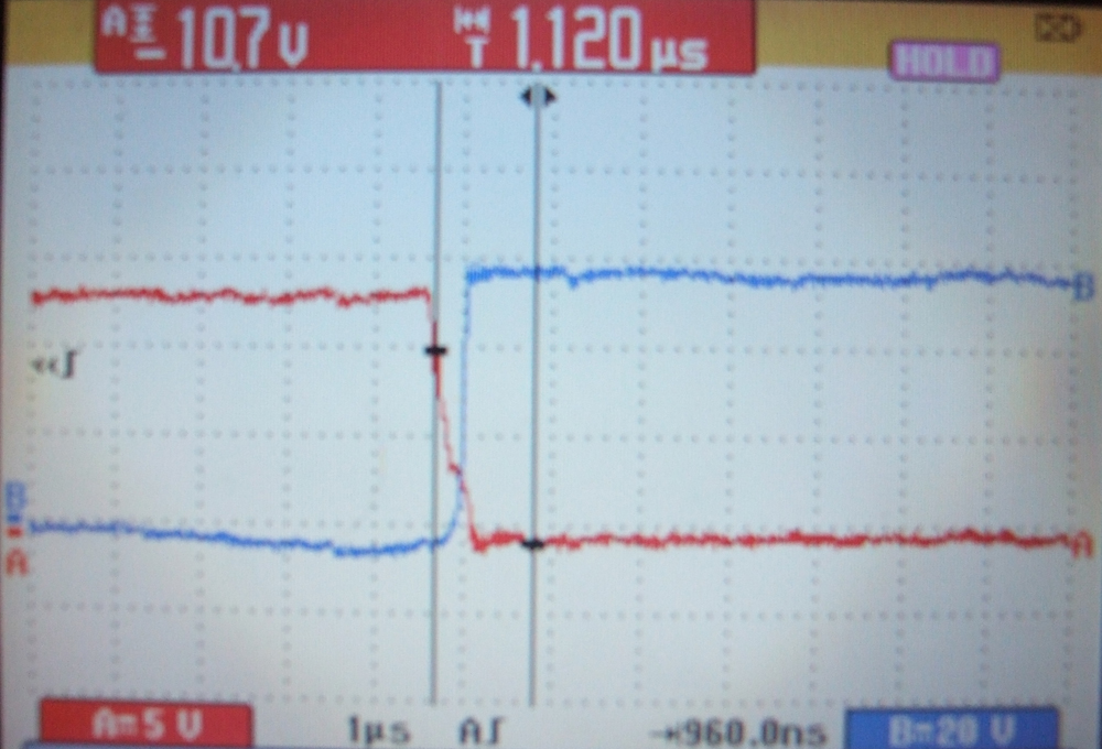

Wow, if you're pulling the "on" fet a few volts off saturation there, you're going to have troubles later -- that's going to be a lot of watts loss into heat, with attending problems.
Hopefully I'm reading that trace wrong (is it 20v or so per div)? It could be an artifact of ground not being ground everywhere (check right across one fet, source to drain), so you may have to look at that one, in this case it would be good news actually, as it would mean something other than fets ->>>> smoke.
Good news on the floating scope test! That's unusual, it must be a good one. I know you can't pull that off with older Tektronix or Flukes. Haven't even tried it with my expensive new digitals.
Yes, you probably need to increase the snubber cap till the resistor get a little warm. I pulled those values from an offline switcher I took apart recently, and from the browning of the PCB, I'd say the R got warm to get the job done. but if you're not having other issues, it may not matter too terribly much. I've gone up to .01 in extreme cases, but that burns a lot of power at high bridge voltages and these speeds. Or burns up caps if they aren't really high quality ones.
It looks like you are hitting some issues with the transformer. You may need some series L. I get it here by just shifting some of the primary to another place on the core, it's free that way.
It looks like some kind of very high Q resonance at about 3x your drive F if it can really pull those large fets out of saturation. I'm hoping that you are seeing some other artifact, but I can't know.

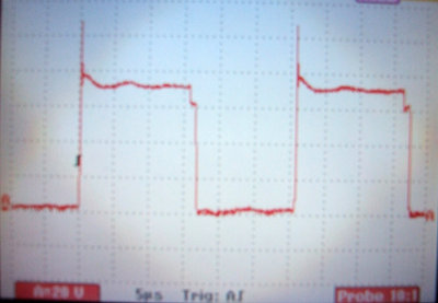

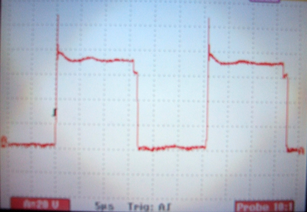

drain to source ho2, 20V/div
Re: Burning FET's and driver troubles
That's a much nicer looking waveform, I must say. Notice you can see the time-varying current draw during the fet on time? It's a tiny resistor after all, and in the right place to use for that.
That spike on turnoff is due probably to turning off too fast, or mistuning. The trick for asymetric on-off times uses a single resistor with a diode across it as the gate R most often, though a diode is a "hard" conductor and sometimes needs a resistor in series with it too (usually much smaller than the one it is paralleling). But again, most of that spike might not really be there if the current is high at the time of turnoff -- could be picked up on the scope probe via magnetic or cap coupling.
You can see current is peaking right at turnon, once in the middle, and again at turnoff -- and that's why you see the big spike at turnoff, at that point a lot of stored energy in the output circuit that has to go someplace.

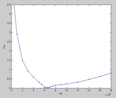

The easy way to measure resonance (at low levels) is simply to hook a resistor in series with the primary and use a signal generator to sweep over a large frequency range. At resonance, the drop across the resistor (or the volts across the primary) will show that the transformer is drawing less current. I've got at least one that shows several resonances. What I see in the current waveform is one about 3x the drive frequency. I've made that work here, but it's a probable cause of the kickback at turnoff. You want to fine tune for minimum quiescent current draw (with no bleeder load on the stack) in any case. That resonance test is pretty easy (if you have a signal generator) and will get you close. It will change a bit at full power drives as the magnetic material isn't perfectly linear. But not a whole lot, just enough to make a slight retuning a good idea.

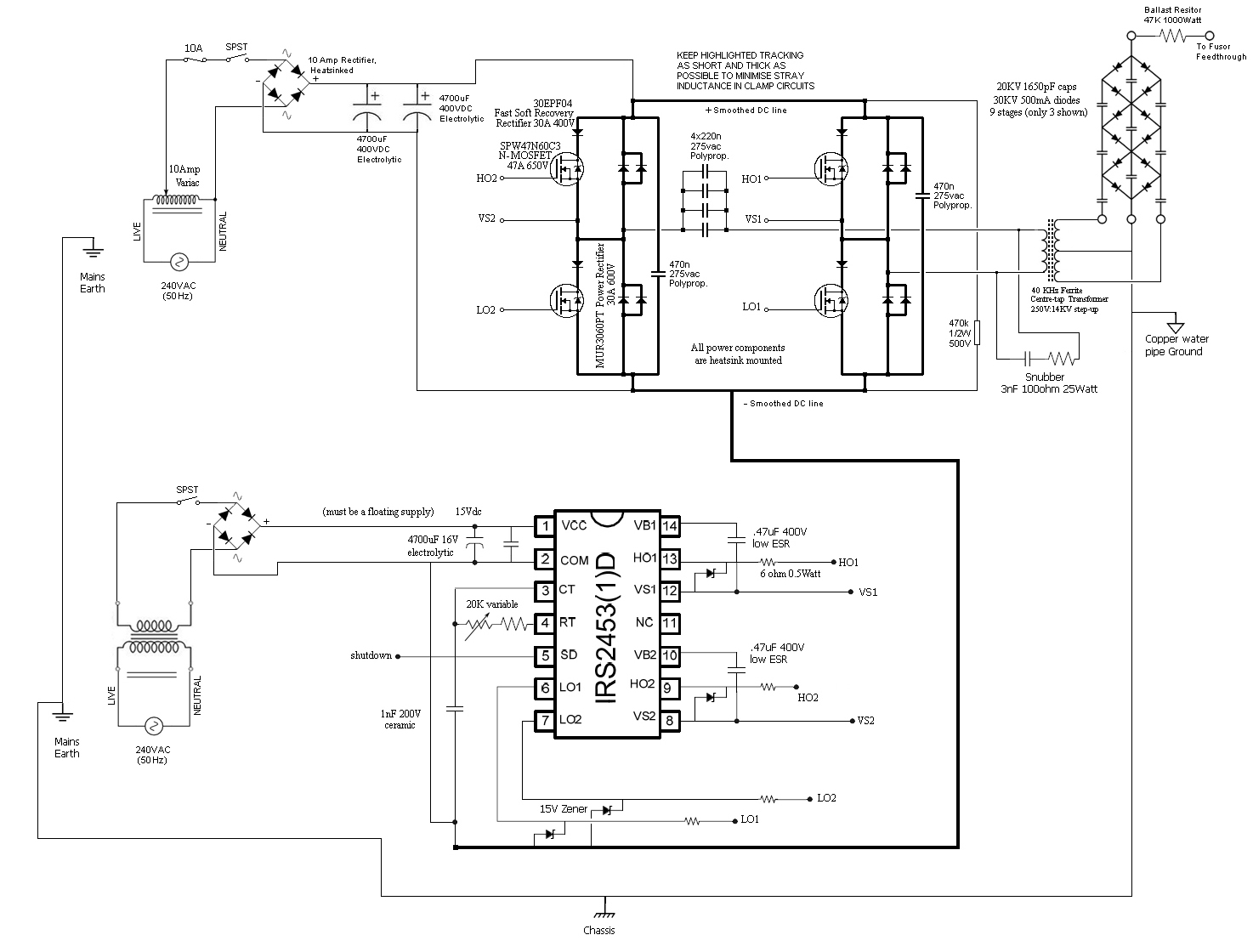

I have attached the latest schematic, complete with earth connection, zeners, snubber, etc. I may still add return diodes on the fet gates. As you can see from the schematic, both supplies are floating. This is the only arrangement that I can get to work. I also performed that resonance measurement on the transformer - there is a definite volt drop across the resistor (110ohm) at 63KHz. This is a big surprise for me! I modified the driver to be tuneable at around 60KHz, then I reconnected everything and tuned for lowest current on no load around that frequency. I will post some wave new voltage waveforms and some current measurements ASAP. For the moment, it seems to be working fine at its new frequency...
Xfmer Freq setup.jpg (29.96 KiB) Viewed 7902 times
Oh, you'll always have some loss -- luckily (!) the transformer doesn't have infinite Q or you could only drive it with a sine wave and have the drivers live. In fact, that's what the series LC in the trick circuit I posted above kind of accomplishes.
I'm not surprised you need to float the supply at all. When you get currents as high as the bridge is seeing, it's all too easy to have ground circuit drops and noises get into things you'd rather they didn't. There are tricks (star grounding) that often work, but sometimes take more effort that just having what amounts to an extra wall wart in the thing. I've been known to do just that and simply solder to the AC input pins to avoid the wasted space on some power strip I plug the whole thing into. Cheap, quick, floating, all the good stuff.
If I were to find I needed more gate drive, I'd use more or less a circuit I saw in the Pressman book. Basically just two transistors, one NPN, one PNP, emitters together, bases together, collectors at the (driver, 15v) rails. I would have about a 47 ohm resistor between the bases and the emitters to avoid a bit of crossover glitch, and some small (10-20 ohm) series R to the fet gate. For the lower sides of the bridge, the "rails" for these emitter follower buffers are obvious - the negative rail and the same power the chip is running on. For the upper halves, the lower "rail" is the fet source connection for the upper fet, the the upper rail for the buffer will be the Vb pin on the chip. If it turns out that this is too much current drain for the bootstrap switch to drive, you could add a diode like they do with the older chips that didn't have that built in. For example, this datasheet shows one. This needs to be a fast, HV diode to work, as it must stand off peak input HV minus the chip supply when reverse biased.

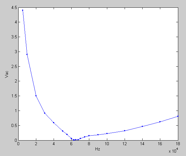

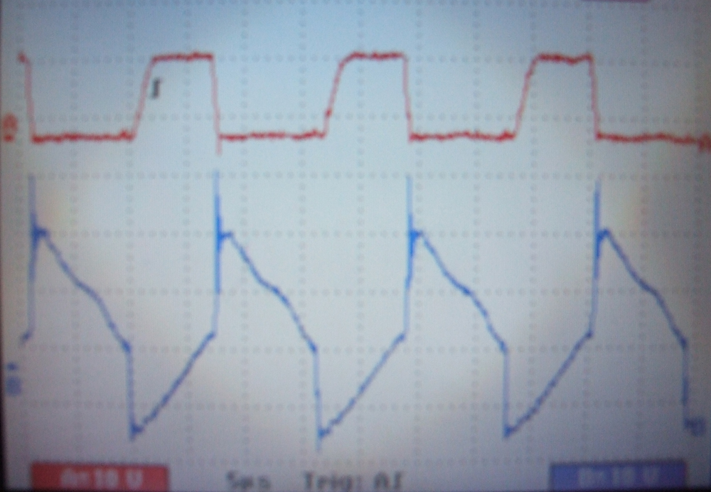

Some more results: After having tuned the driver circuit to 63KHz, I had a look at the voltage waveforms on the gate of one of the bottom fets in the bridge, compared with the output (drain) of that same fet (see first pic). Whilst watching the waveforms, I tuned for lowest quiescent current in this frequency region. At 66.8KHz I heard a distinct buzzing, sizzling sound (which did not sound very healthy). I'm presuming that this is the entire system hitting resonance - the variac current dropped right down to 175mA and the output waveform became really unstable. I reduced the frequency just off this point, down to 65KHz, which pushed up the current slightly (226mA), but stopped the noise, and stabilized the waveform. So I think I understand what you mean now - you want to be close to resonance, but not on resonance. The more I increased the voltage, the more I had to reduce the frequency to keep the waveform stable (and prevent it hitting resonance), and at 40KV the frequency is down to 60KHz (out -of-circuit measurements made on the transformer in my previous post put the Fres at 63KHz). There is a slight glitch on the bridge output under no load, but it does not seem to disturb the secondary much. In fact when the glitch is not there, the secondary voltage starts to look almost triangular, and the whole thing is too close to resonance. Under load the bridge output is distorted and there is some ringing (see last wave pic)

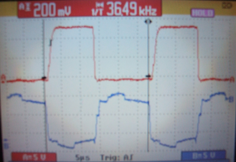

I found a similar low quiescent current point at around 36.5KHz, although the output waveform is not as smooth - this seems to deliver the same KV voltage for the same current draw on the variac (but I did not test it under load).
Itried to look at the frequency response of the transformer on the network analyzer at work, but the analyzer only starts at 300KHz. This driver circuit appears far more stable and resilient than the previous one (controlled by a TL494), despite driving fets that are somewhat large for it. The driver IC seems to take the hit before any fets burn, which is fine by me (and which has not happened since I put the zeners in). I have attached the current artwork.

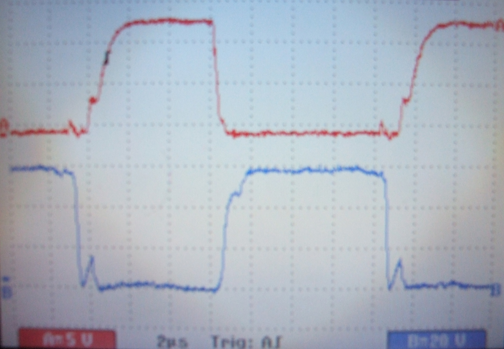

red = gate, blue = output (drain) @60KHz
red = gate, blue = output (drain) @36.5KHz
black = deadtime, red = gate, blue = output (drain) @60KHz

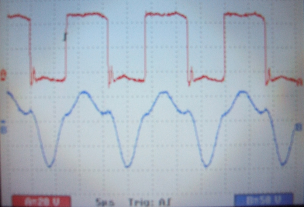

red = gate, blue = output (drain) @60KHz, with plasma load

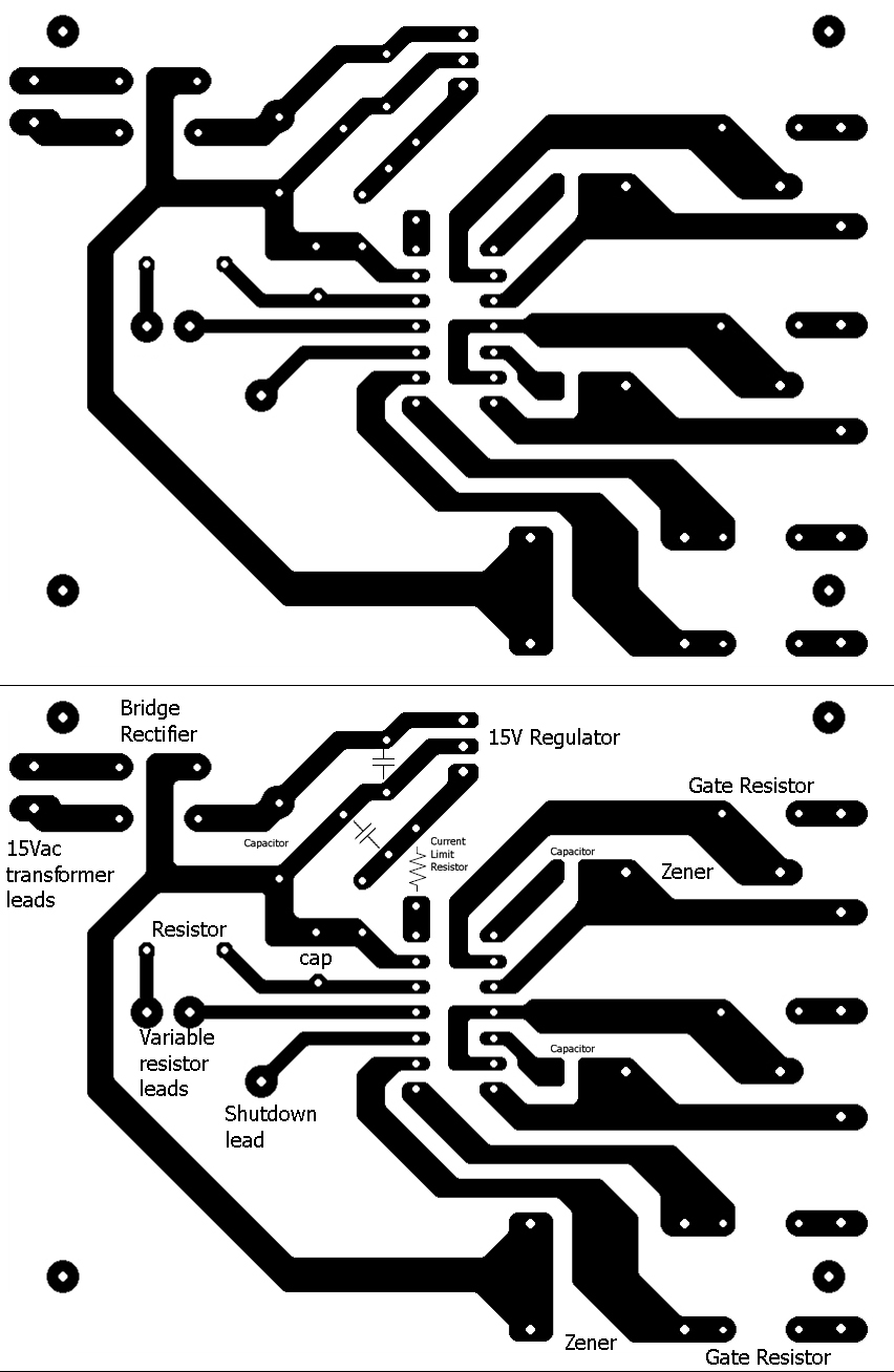

current version pcb layout

Pulling the fets out of the on state looks un-good to me if I'm interpreting that scope shot correctly.
If you look at the on-resistance specs for the fet, this implies some amazing-big currents you shouldn't have no-load or low load. It doesn't add up with the quiescent current you're reporting.
Something is still a bit odd. I'd love to see a pic of that transformer.
You might need to widen your sweep of the transformer characteristics. One of the ones I'm working with shows 3 resonances and only one of them is the right place to run.
Having the resonance rise with drive is normal (a little bit) but too much means you're trying to get more than the core can do in V/turn at this frequency.

Which scope shot are you referring to? The last image (with the blue trace slopes down and to the right after turn on) is with load, and is pulling at least 2 amps.
I will post an image of the transformer and some specs - it is a bit unconventional. And I will check those on-resistance specs...
Oh, sorry, the bottom one -- a few amps should not pull a fet out of saturation by volts -- that would imply an ohm or more "on" resistance on the fet -- and the ones you're using are in the milliohm range when on I think -- the smaller ones I use are. That or some measurement issue (ground not really ground or something else dropping volts). I see you're having the same issues with close ups on scope screens as I -- hard to read the legend on volts/div in these. I'm usually to lazy to use the scope itself to save a bitmap on its SD card, as it takes a long time to get into the computer for posting here, myself. But that bottom shot shows (I think) volts happening across a fet that's supposed to be "on" at the time, and at most you should see millivolts there.
