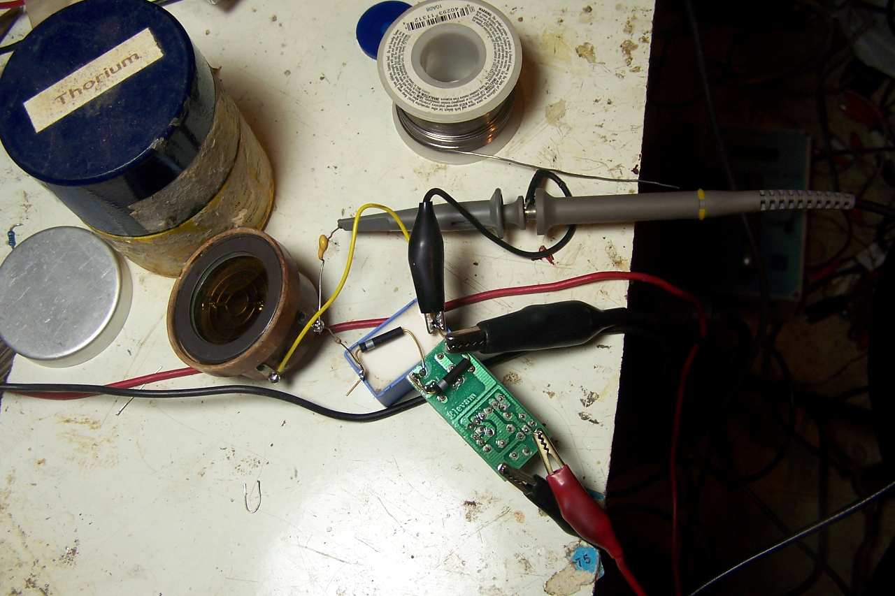

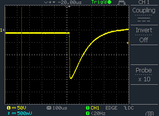

I've tested the tubes now, and they work fine. They want 300-320 volts, which I get off a 12v input, 1kv output CCFL with ~1.7v in and a volt doubler on the output, using a 1 meg series load resistor for the geiger tube. I used the series caps on the CCFL, and a big .47 uf filter cap, no noise is visible (it's overkill for this job).
Pulses are about 200uS wide, which is on the slow side, but good enough for this work, and nearly 150v tall (and, if you reduce power volts, they just don't fire at all, characteristic of the geiger phenomenon) -- super-excellent for EMI rejection. There will have to be a bit of current limit to drive CMOS off this without blowing either it or the tube -- remember, a coupling capacitor exists, and can store some energy, so to really current limit to the same level on this tube (and high current fries them) I should use a 2 meg series R to the power, then a two meg in series after the coupling cap to the transistor or cmos input, for the tube to see ~1 meg under worst case conditions with the CMOS limiting at GND and Vcc. Else peak currents in the tube can come from stored charge in the coupling cap and its own discharge current, which is only limited by the external components. I've not yet figured out what the third electrode is, probably a shield, and I'll try grounding that (or whatever seems to not be a bad idea after an ohm-meter check). I get Anod, and Katod -- but I don't read Russian on what that other terminal is for, probably noise shielding.
There are a couple possible ways to regulate the HV, and it's not that touchy (as a phototube would be), but I think maybe the CCFL, operating so close to one diode drop (or one Vbe), will be highly temperature variable. So, either I can use some diodes and an emitter follower to provide a voltage that tracks the tempco, feedforward, or use a measurement off the HV into the PIC and the PIC pwm output through a CMOS buffer and LC filter to make the roughly 1.7v the CCFL will need. Heck, at 10 ma, I could probably just use an unbuffered PIC pin and an RC filter. Note that this plays well into battery operation. The CCFL is drawing about 10 milliamps under counting load, and only needs 1.7v, so I can run the CPU off 3 alkaline (or one expensive lithium) cell and have portable operation self-contained, assuming rs-232 output will do here. An LCD display won't run without fancier power supply considerations -- they really need 5.0 volts. In this application, I should be able to program the PIC down in clock frequency quite low to save further power draw, and hit something under 20 ma total draw, well within decent lifetime for AA cells, and make this small. It would be easy to add a clicker to this as I have everything else here -- I'm a big fan of audio outputs, and JoeS has shown the way to do it with minimal power needed.
Scope trace of output, 1 meg, 47 pf, scope probe
And here's the rig, hopefully not too complex?
Test rig for new geiger tubes

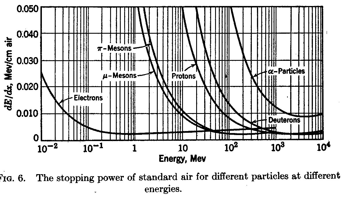

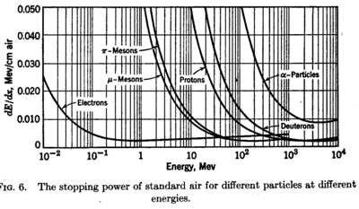

BTW, everything has a dip in beta sensitivity around some energy range -- see Haliday, at a certain speed betas just don't interact much. The important question is -- how about the betas from our activations, not what about the ones from particle accelerators.
particles in air - stopping power
As you can see, in the range of our interest, the curve is pretty flat (and remember that some betas in silver, a high Z element, will become gammas on the way out). Can anyone cite an actual reason that we have to extract 100% of the energy of a beta to detect it? It is pretty easy to detect them with scintillators, though due to the plethora of non-one-shot energy loss mechanisms in matter, hard to get extremely precise energy data for each one. And pointless in our case, the beta decay doesn't make mono energetic betas -- recall the story of the neutrino?
