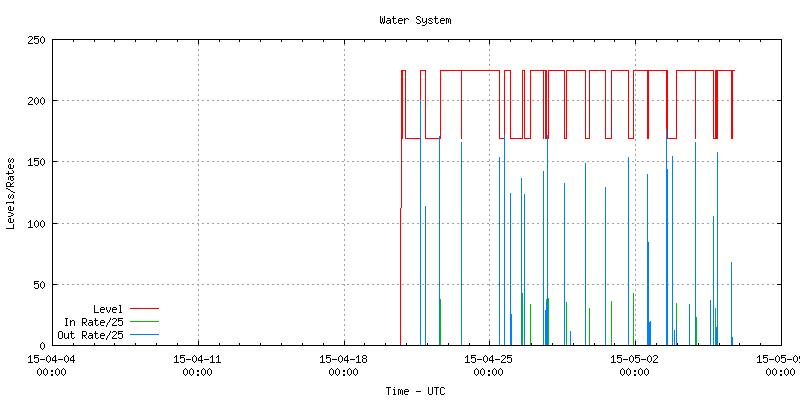

Testing the final (for now) sensors - water flow.

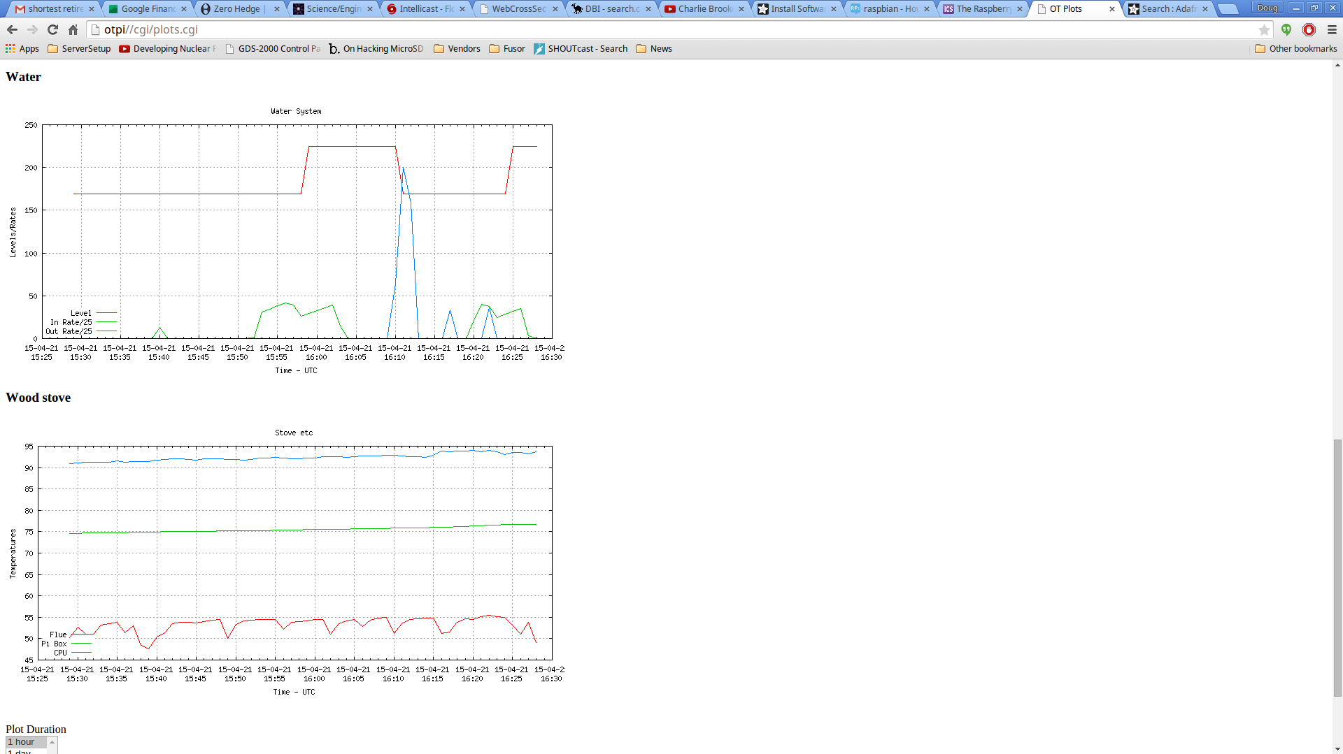

Interpreting this - I only have 4 discrete levels in the cistern I monitor, and they are (very) approximately 4ths of the total 225 gallon capacity. As time goes on and I eyeball when they actually switch - for certain, water will get much lower sometime this summer - I'll make the reported values more accurate, but they will always be steps, unless I find a way to get tricky and actually use the a/d inputs in some fashion to show values between the discrete levels via how hard the highest "true" sensor is being driven. Might happen, but no point holding your breath, it's just not that important for managing when I use a lot, or a little.
So, I was a little under full - not really down to 175 gallons as reported. I turned on the inlet via the cgi for that - the collection system is full - and waited to see it hit the overflow state, then turned it back off. That's the green line at the beginning around 15:52 (before that I think was a glitch, the vane sitting right on the edge of a count or something). When I saw it hit the overflow level, I used the water control cgi to turn the intake back off - and you see the green line go to zero again. That's how it's supposed to work. Not being able to resist, I then went and used up some water gratuitously, just to see the other sensor work. I'm guessing that peak (blue) is on the rough order of 6-7 gpm (pump rated at 5 gpm, but running on 18v, not 12v rating here). That took the water level out of overflow, so I came back here and let in some more - you can see the green line rise again around 16:19 (these are all UTC, which gnuplot understands and lack the complications of daylight savings time).
And oops, already showing me some value for my work - the blue peak just before and just after I started letting water back in are that leak in the toilet - I wouldn't normally have known until it ate a lot of water, it's not in the building I currently live in so I wouldn't hear the pump. (I fixed it temporarily by shoving it closed tighter with a stick...here in the sticks, we just get 'er done sometimes). And again, used the cgi for water control to shut off the inlet once it was going to go on the ground anyway - who knows, with this weather the water in the collection barrel might stay good a few days, and I can use more of it. When it's hot, or the water has pollen in it (there was a real gully washer last night and this is super clean stuff) - things grow in there and that's why there's a dump valve too...sometimes the better part of valor is just to dump the stuff if it isn't highest quality - and that's why I'm mentally modeling a design for seriously sensitive water turbidity detection that will work in the conditions that obtain out there - sun sometimes, freezing sometimes, wet sometimes...high winds, you name it. No, the cheapo ones for dishwashers are not even in the same order of magnitude sensitivity as what I want here - they can tell filthy water from merely unacceptable water - several orders of magnitude worse than the gov specs for drinking. I get the good stuff often enough...I just need to know what I've got without hoofing it over there and checking...it'll happen at some point.

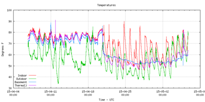

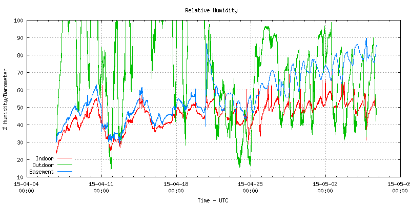

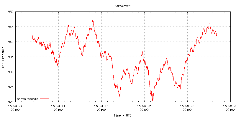

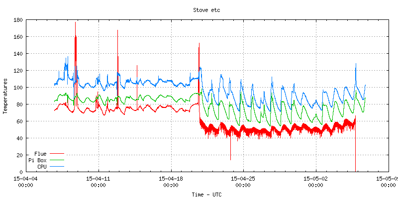

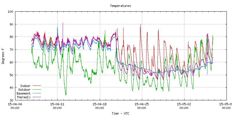

Here's some fun plots that this can and does serve on the web. This is all the data I've gotten since the beginning, including bench testing in another building, it's pretty obvious when I moved it - and also when the thermocouple amp failed the other day - I will be fixing/replacing that for the eventual woodstove installation here where I plan to move and have what most people would consider minimal living standards, compared to living in the shop as I have been.
You know, a real stove, plumbing...and so on.
Month duration, more or less
It's also obvious that when I moved it to here - the water level sensor got hooked up. Works quite nicely. I added an auto-fill option to one of the CGI's that once triggered (that's still manual after I check on water quality) - does the job nicely with zero waste and overflow. Ah, more showers for me now possible!
