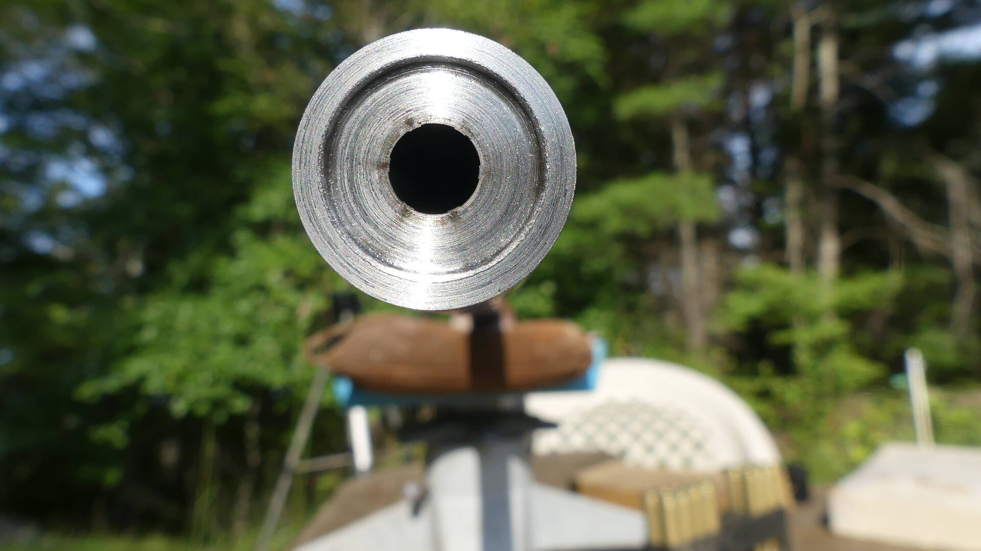

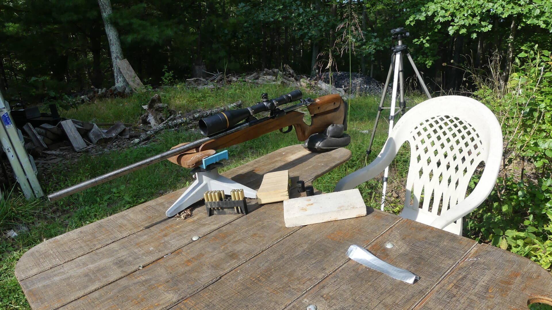

In this case, I'd been building up some parts for Swedish Mauser (6.5mmx55), and was having trouble getting what I thought of as the second best (certainly the 2nd most expensive) Douglas barrel to "shoot" - the real meaning of gun control - hit what you aim at, and only that. I had a collection of parts for this round laying around as I was kind of doing the "try everything" approach, thinking of possibly competing in class F long range shooting....health and other issues probably stopped that, but it'd be nice to have the good rifles for sale if nothing else.
I had a rusty old A&B barrel of heavy contour in the pile, rotting away. Well, that won't do, so I decided to thread and chamber it for my test harness action and give it a go, despite some rust also inside the bore. Not a lot - but I considered chopping off a couple inches at the end, which would have made it a bit shorter but still fine for benchresty kinds of uses (20 to 22" depending on how you measure).
The A&B barrel blanks were from MidwayUSA as their "economy" brand when I got them. I also got a Shilen - it's real good, and another A&B, lighter profile, pretty good, and a Kreiger - full bull, 5r fast twist, likely VERY Good (definitely very expensive...) but I've not machined that last yet - waiting for another action and a stock I don't mind really carving up for a barrel that's 1.4" diameter - end to end.
This one shoots the best of those yet tried. After that is the Shilen, and after that is the other A&B, and FAR FAR after that is the Douglas. Some of this is almost certainly my own variability and that of the stocks and actions (all of which I've worked over, but you know how it is). I'm going to keep messing with the one that stinks, just out of curiosity. It looks reasonable in the borescope...maybe some big void in the metal I can't see or some weird vibration mode? It's always good to learn things!
I didn't cut it yet (and may not!) - stay tuned for a long video about the whole process - how I do it on my affordable tools (no fancy CNC or flood pressure cooling during reaming and so on, just the home gamer stuff). But this one - like another cheap A&B I also have - shoots, and I'm frankly amazed, as this is with cast bullets, used brass...and the picture of the first 8 shots from it at 70 yards looks like this: For the first 3 shots I was aiming at the staple at the bottom (one shot had gone over the target before this). The second 5 - 3 in the same hole(!) were holding on the bull, on that shaky table with a bit of a pounding heart...I'll take it! There WILL be a rather long video at some point - if nothing else, I'm not done thinking and I need to justify the killer computer I built to ... edit videos --- (and play chess).

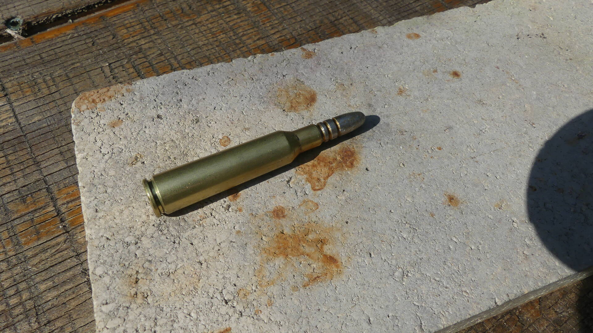

I went to "warm it back up" and verify my download for cast bullets - which was fine at 1710 fps - and gheesh, the shot went through the same group hole near the bull. I didn't believe it myself till I rode downrange for a closer inspection. Holy smokes!
Then I tried some almost full power loads to knock any burrs and rust out of the barrel...these were 120gr Nosler BT, 39 gr Varget, Win brass, CCI primer. The first power shots out of the thing made a 1" vertical string, all touching. They were going 2680 fps roughly - the first was faster, I guess because of some tight fit issue. This made a real mess in there - it's still soaking in various changes of copper solvent, as the bit of rust inside really scraped off a bunch of jacket material. Once that starts to look half reasonable it might be time for "shots of record" and final tuning - it's still not even bedded, though the barrel touches in a spot where I hadn't relieved enough stock to clear this profile. Interesting.

I did some more work on that project. Last night I cold blued the barrel, just to make it look less nasty, it's not going to be a beauty queen, sealed it with Tung oil. Looks OK. Did some fiddly work on the stock and trigger guard and bedded it - now for the really hard part - Brownells says wait 2.5 days to shoot it.
I also finished modifying and polishing the bolt face - it was originally for 8mm mauser, and the 6.5 swede has a slighly larger case head, so some things needed to change to make it feed smoothly. I also cut a 60 deg chamfer on the front of the chamber, and then used a dremel with a tiny buffing wheel to make a mirror smooth curve for easy feeding. Straight ammo seems to be helpful in shooting straight, and if it gets a lot of scraping and forcing going in, it doesn't stay straight...
