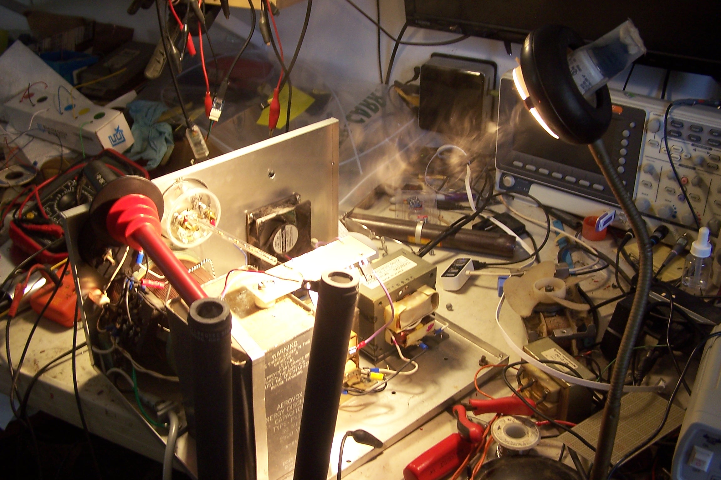

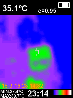

Of course, with two of those 100-something watt resistors as load - around 100ma at this setting...there is smoke, but it's only the load smoking!
For once, it's the stuff that is supposed to smoke.

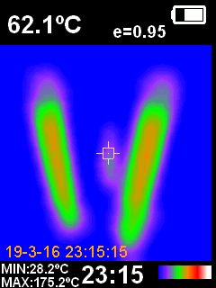

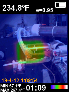

With a bonus cheap IR cam pic of the load Rs.
Yep, they get hot.
Yep, they get hot.

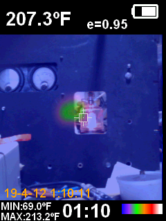

Only one transformer got warm enough to come out of the background here. It's the GE one that needed extra turns on the primary to match the other.
I think that hot spot in the foreground is just a reflection from a bench lamp. I couldn't feel anything warm after turning it off there. The transformer was just
barely warm to the touch.
Where most of the other 25 watts went.

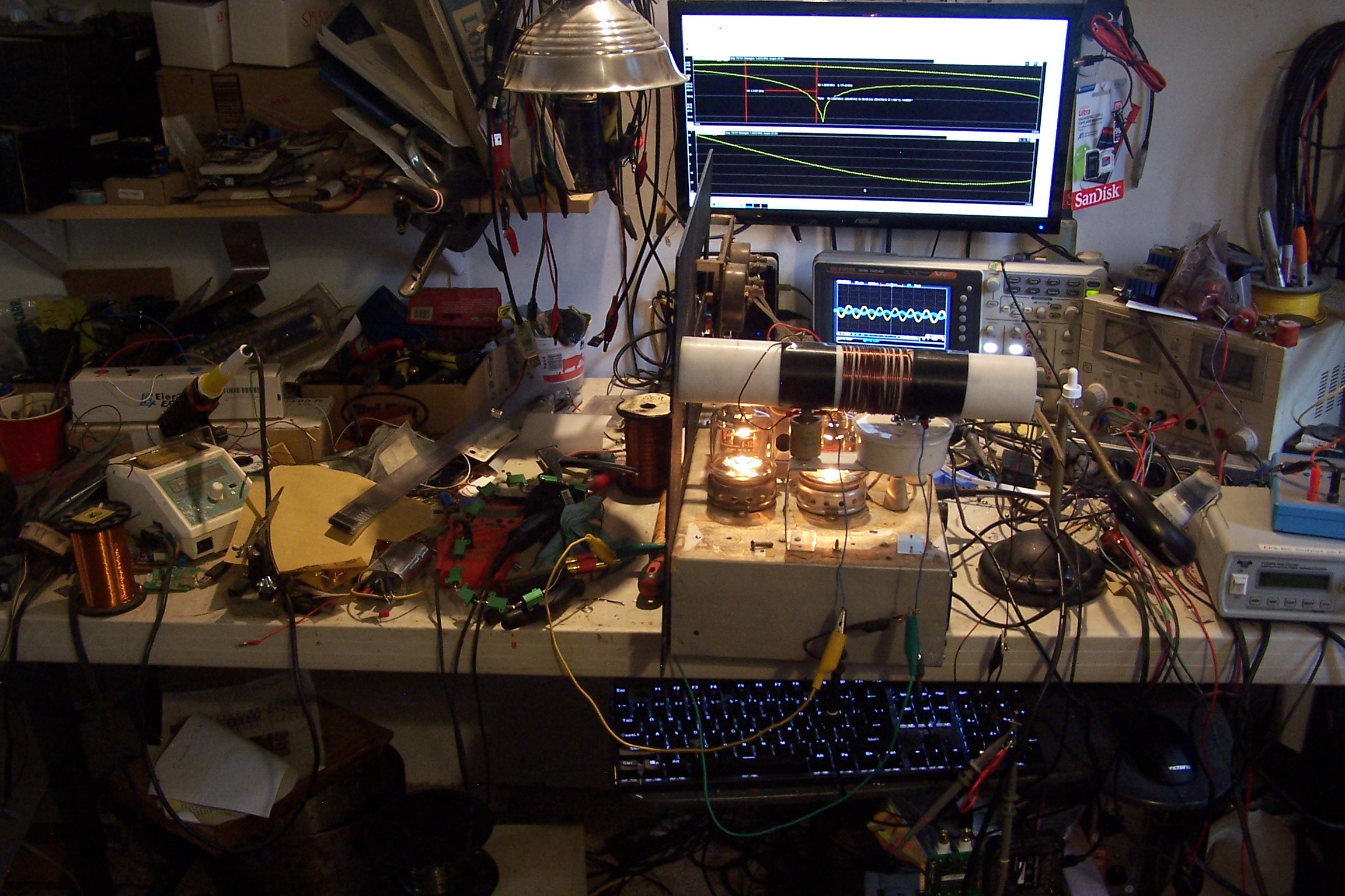

Well, nothing goes as fast as you wish, I suppose. I'm trying to get within around 6dB of what I think the design parameters should have been...I know I'll have to change stuff, but I see no point in starting way the heck out either. C'mon good solar weather!
So, here it is now, having its output isolation transformer being tested for impedance at the tube end vs load at the fusor end, with a dummy load that approximates what it would see tuned off to the capacitive side a little (since I didn't have quite the right one for the dummy and I don't figure I'll be out of range).
Looking pretty good, the coupling is better than I expected, resonance on the secondary shows up clearly on the primary side as it should, resistive load shows up as it should, voltage ratios closely match turns ratio...I have to hope that 3/8" thick teflon will stand off 50kv at least...and now I'm just making all the little accomdations for the connections it will need in the real world prior to power tests on the dummy load...which can't last long as that load (10 100 ohm 10w resistors) will go poof pretty quickly at the predicted power. But it should only take a few seconds at power to see if I CAN get to power with the other values inside the amp for protective bias and grid leak value - pretty sure I erred on the safe side with those.
Transformer primary - 60t #14 around 4 6" long, .5: diameter type 61 ferrite rods
Secondary - 30t #14 on the outside of the pipe, centered as shown. Right now loaded with 100pf and 1k for testing. Awaiting a new input cap for the main pi network from HV stuff. The one I have in there, while correct value for the F of interest, is at best a kludge of 20kv caps in series-parallel, and at best 40kv peak.
The new one will replace that 100pf cap with a 1000pf pi network input cap right there on the chassis where the current is. Then the only remote is the pi inductor and fusor RC load. I'll be tuning the C out, and the R looks like most of a megohm, depending on how many ions are present.
Thus making this match a bit of a bear - kilovolts of RF and "no" current - it'll be hard to measure the actual load as losses will be high in comparison.
Maybe I will get the QSO with Bob going...
Messy bench, but fun.

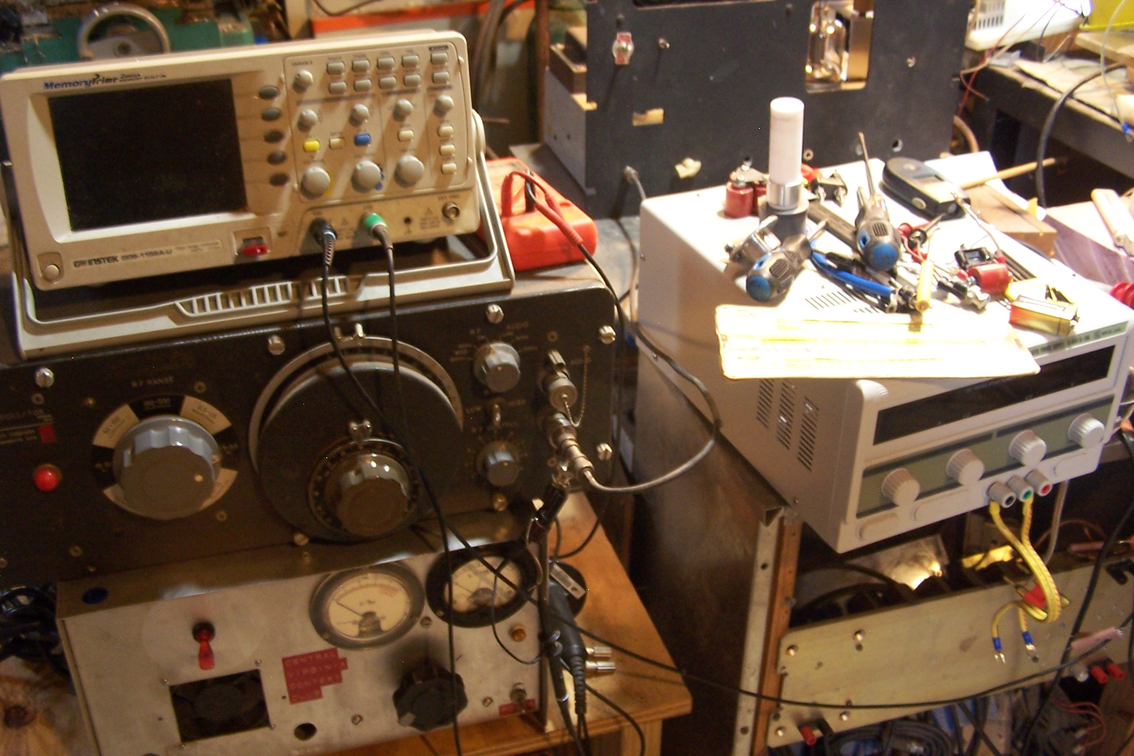

Well then. Testing this thing is the greatest challenge so far. First light - using 5 100ohm 10w "chinese" watt resistors - smoked the dummy load in 10 seconds or so, barely even managed to get a reading on the pk-pk output on that.
So I rummaged and found a 50w Ohmite "american watts" 500 ohm R and fired it back up, along with a higher voltage rated freshly calibrated scope probe, since I couldn't tap down on this load. I must have gotten 20 seconds or so of operation before the signal generater started beeping frantically, putting out wrong stuff, and blowing its fuse. I know I'm not backfeeding its output, must have somehow gotten into the AC line, which isn't a 3 terminal thing, has a very wimpy looking common mode xfrmr, smallest I've ever seen...and what looks like 1n4007 diodes of which two are now 0 ohms either direction. Which I found out after I put a "penny" in the fuse box - on strand from stranded wire, which survived - the line cord blew...(!) and this computer reset from across the room, as well as the printer in the next room. The closer-in raspberry pi didn't blink, of course - which is one reason I use one at the fusor for data acq and some of the control. (all things running on the same 120v circuit). The pi has a somewhat larger capacitor to power use ratio and can take short line dropouts too.
So...I guess I either fix this siggen power supply and cord, or go to the good old "eat lighting without a burp" GR tube siggen, and maybe test on the porch, only bringing out the test gear required. Whoda thunk that a mere 1.5kv pk pk or so 1.6-2.0 mhz sweep would do so much to things here - not one wire in the system, even the 120v, is even a tenth wavelength, and the dummy was on 6" leads hanging from the transformer....zowie. I never did get above around 1kv on the main plate supply.
Now I'm going to have to run around and see if anything else blew. Usually not, but...it pays to check before those things are needed and trusted to tell right answers next.
And maybe look for a lot better dummy load in case I want to test at power for long enough to set and read scopes and suchlike.

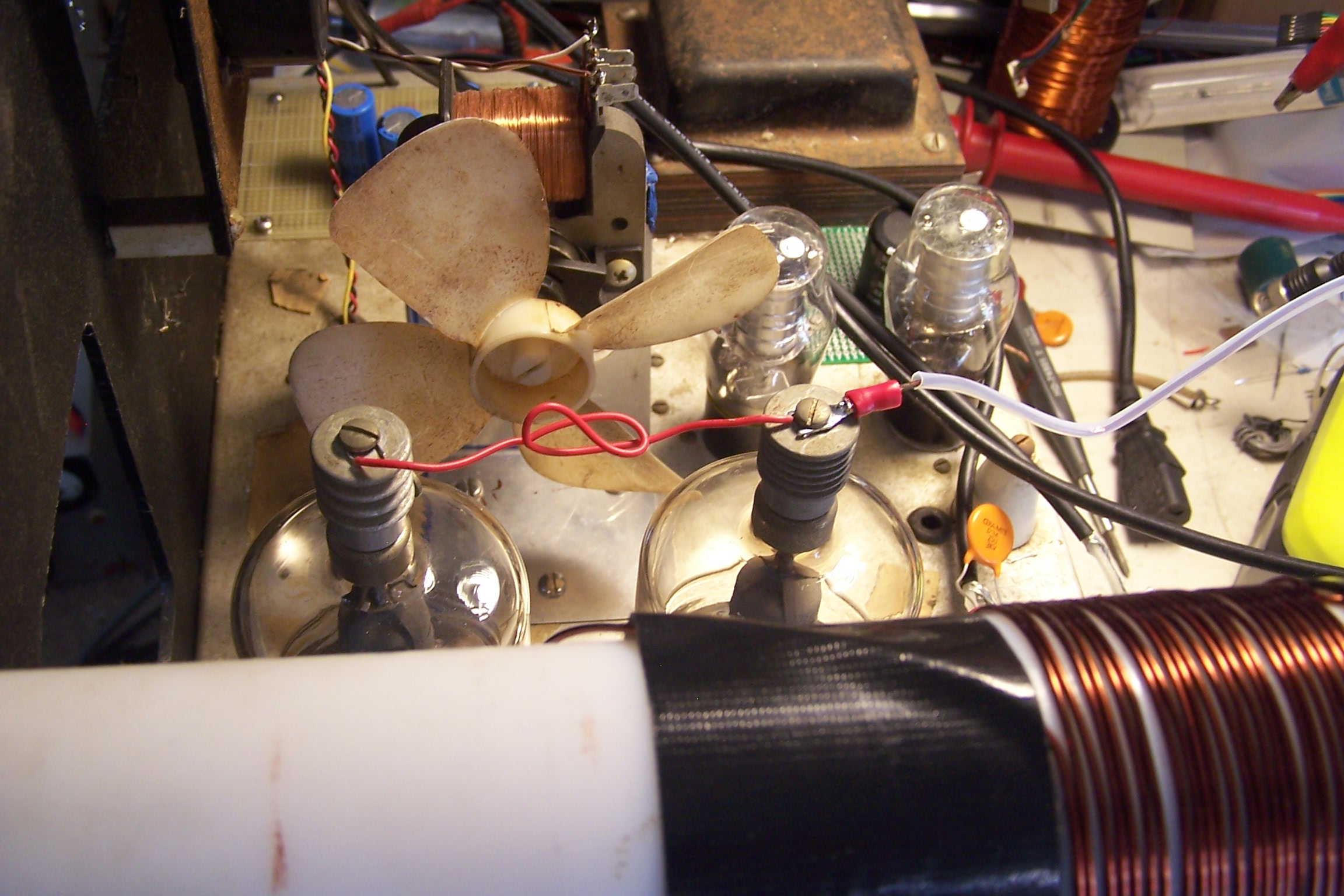

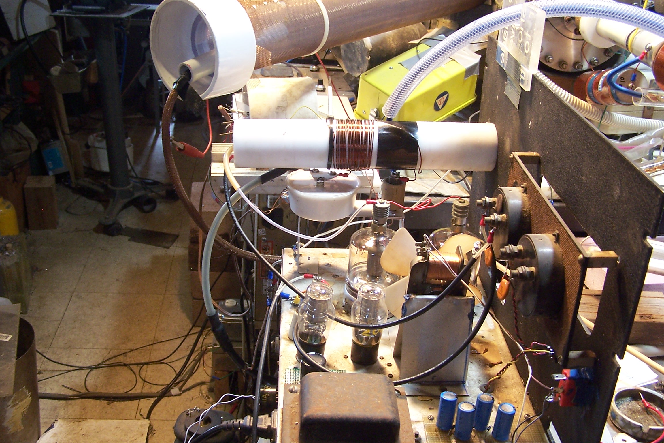

I guess you aren't even to the point about worrying about how to cool the tubes yet. In the photo I don't see any kind of fan or provision for cooling the tubes. Eimac sold a glass chimney for putting around the bottles, and you pressurized the chassis and had some air come through the socket, but most through holes between the tube and chimney. Heathkit took another approach, just had a fan blowing across the tubes in the SB-220 and the successor HL-2200 amplifiers.
Re: 4-125a amp for fusor ion trap
I guess I wasn't concentrating on showing that aspect. The person who went before on this chassis didn't do anything (but my guess is it never worked).

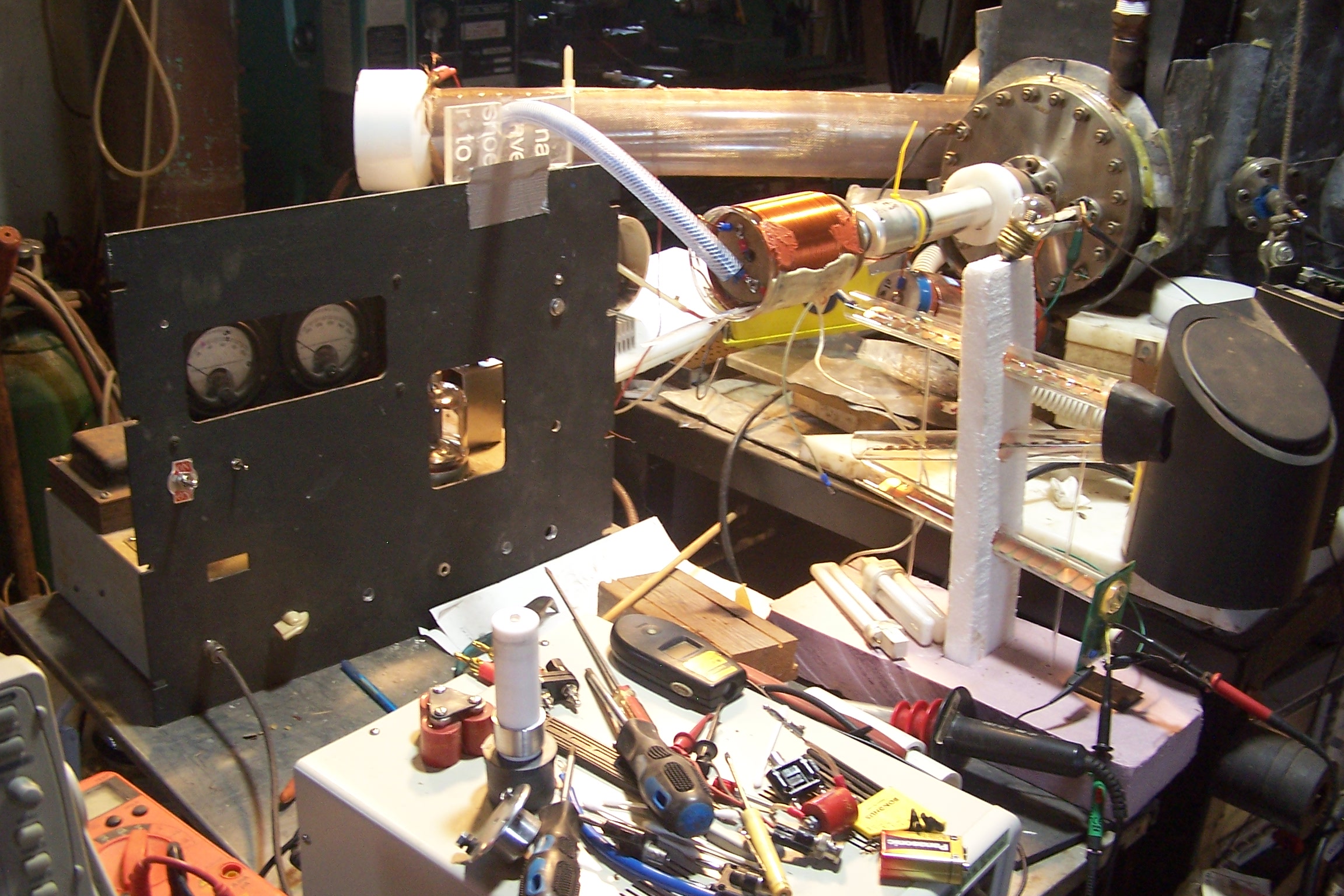

I changed that with a big noisy fan from a microwave oven up top, and a smaller (with an ouch price) pressurizing the bottom chassis where the 6146a and filament transformers live.
Top fan, kind of blends into the scenery
I did actually get the plates to glow dimly at one point, but everything else went poof right around then. I didn't get the feeling the tubes got hotter than design values. The paint is still red. The scope didn't show any parasitics (1 ghz scope). Output waveform as expected - not real pretty since it was basically just an inductive load with a large inductance so the top half of the wave (the kickback part) was a little short in duration. Didn't get time to push the "save me a picture" button on the scope.

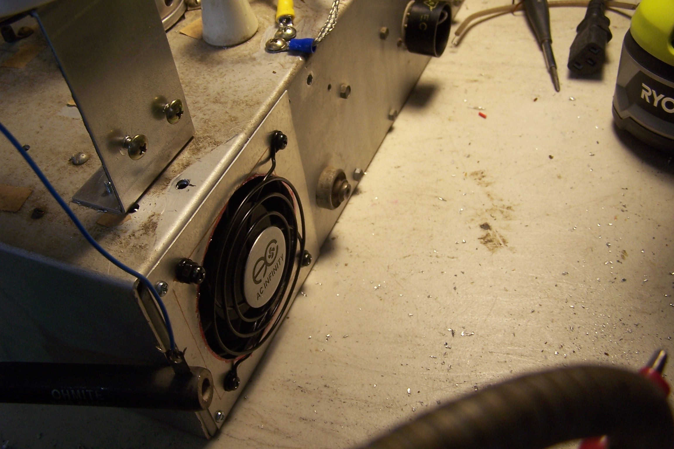

I also push air into the bottom, at the 5v transformers, which exits past the 6146a into a hole under the topside fan. A little probably gets through the holes in the power tube sockets.
Smaller new fan - that was expensive (rare size)

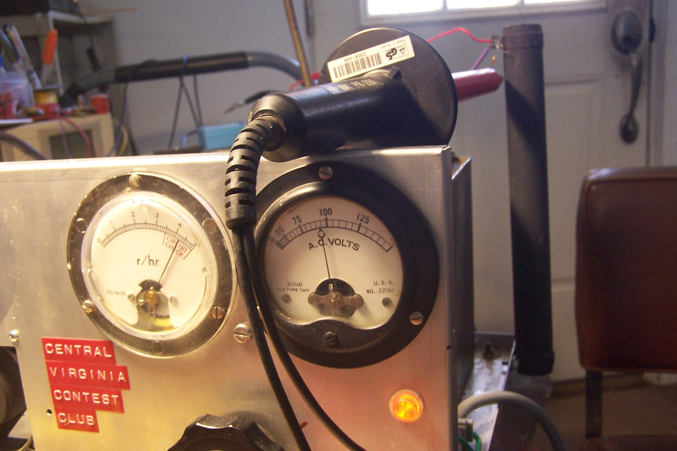

Controls and monitor

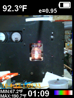

Warming them up real nicely
Not quite smoking...skin losses?
Tubes not that hot on the outside.  That microwave oven fan is a real blaster.

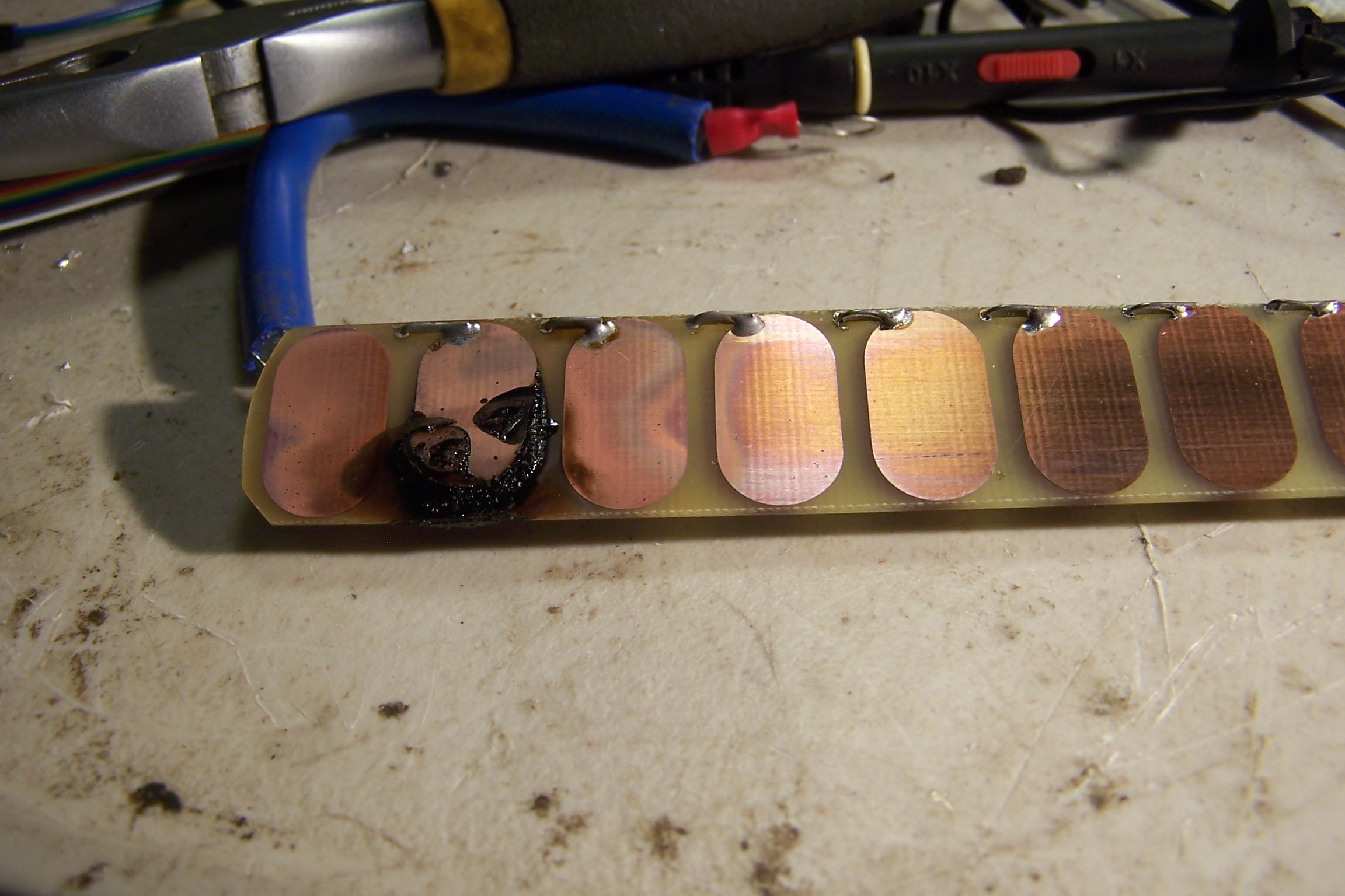

And...my HV probe fried. And did so before I could recalibrate the actual gain/loss of the probe - it's off by a factor of "several" low here - there's no scope setting for oddball probe divide ratios which this is. So I guess I'm back into making PCBs again once I find the artwork...because it was the board itself that went up, near the input - the fields in air are fairly fierce there as it's close to the point at which the fusor grid connects to the outside world. Every gas lamp and tube in the shop lit up, this thing makes real power even though I'm not yet matching it correctly.
Not sure why this failed, or why it failed *there* - insect?
The inside of that quartz tube is going to require some serious cleaning too - this really emitted some junk and made quite a stink. Even half an hour later it's stinking up this room where I brought it to take the picture. Wow.
