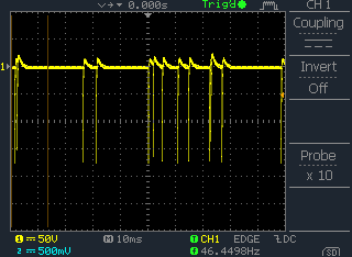

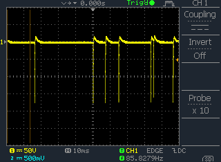

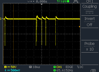

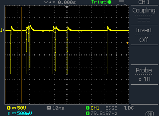

Re: Standard counters - scope traces
Here's some data that illustrates what I am talking about here.
Notice the frequency of triggers on the scope. On the calibrated 2" tube dowwnstairs, this source (a lamp mantle) reads right around 6k cpm, but of course due to the random nature of radioactivity, during two minutes returned counts from under 5500 to over 6700 -- that's just how radioactivity is. Even at this extremely high count rate, much less what you'd get off slightly activated silver! Note also that pulses right behind one another are pretty frequent -- truly random timing, eh? Further, ones inside the "tube ion sweep time" are smaller then ones in isolation.
This has really messed up some programmers here, who make rotten assumptions -- just like the scope frequency estimator does in these examples. No, you can have 1000 cpm and all 1000 counts come in 100 us on a phototube, you can't depend on them being anything like evenly spaced. I didn't select pictures for this, I just hit "snapshot" 4 times -- a decent sample.
The source in this case is a lot less hot than say, some of the U ore I have, or a smoke detector source, a staticmaster source, and quite a few other things considered safe enough to sell on the open market to anyone. I'd say this is plenty sensitive enough!
This tube counts about 1/sec with the usual wide variation when no source is present other than the rest of the universe. Nice to have a way to be sure it works. We find significant noise in 10 second counts here...but silver is so quick to decay, longer periods are right out, so we use the good old eyeballs to average over the noise. I'll take a decay curve next time I have some hot silver so you can see this. There basically isn't any point at all in being able to detect less than 100 cpm activations in ten second counts - at that point the SNR is pretty horrible, and you have to strain to see an exponential in there.
