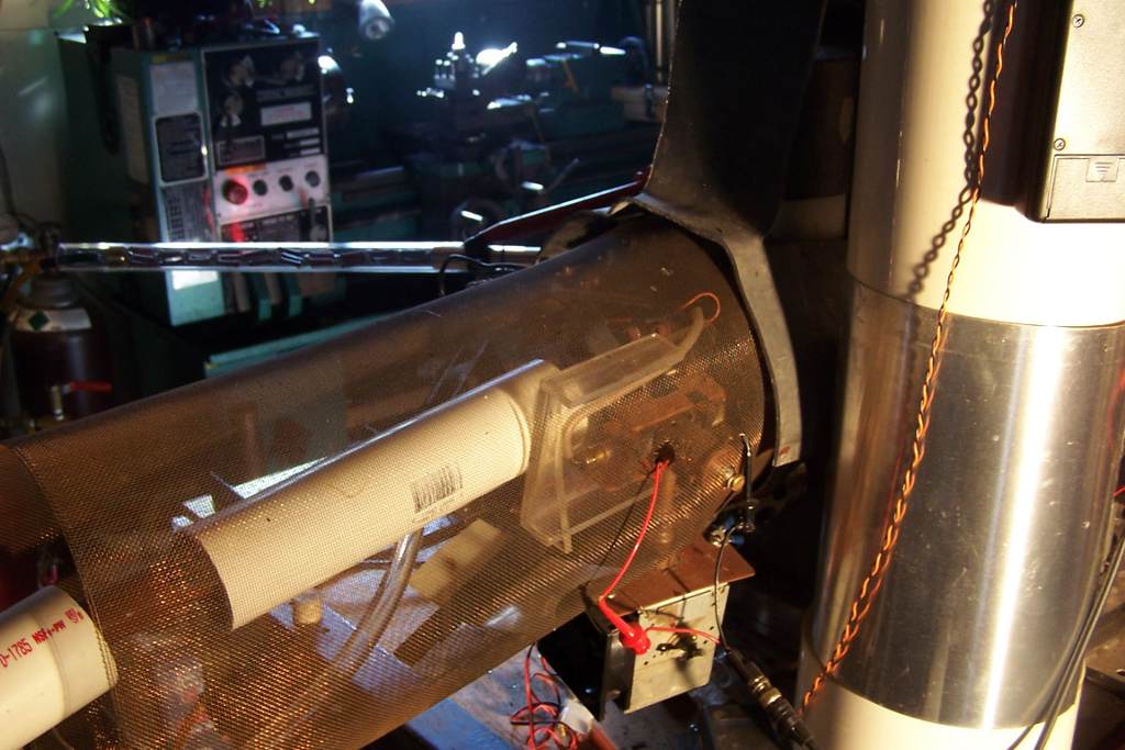

There's a lot more going on in this picture (some not related, but good to know about). For now, the Cu tubing comes into the screen from the upper left of the picture, goes through the glass inuslator to another piece that winds up going in the end of my microwave ion source and on into the tank. At that end there is a 2" (roughly) piece of .005" ID cappilary tubing to slow gas flow, not needed now, but very badly needed when I was trying to do this the old way. Letting the gas in through the ion source theoretically means the pressure is a little higher there and letting that work down to lower tank pressures, but it works well enough without that feature, and I now do have troubles with the gas in the glass tube lighting up from the ion source "pusher" voltage, that I'm going to go to just putting it in the tank elsewhere.
The point of some of this is it's no longer important just how long the needle valve is open. It more or less instantly pressurized the Cu tubing, and that then slowly leaks through the cap tubing into the tank, so the timing for the valve opening isn't real critical -- a second or so open lets in one standard slug of gas, which does take awhile to make its way into the tank, but not so slow it's a bother. If that turned out to be too much gas (usually), then I resort to the pump-out solenoid till it's just so again. Done! Boy is this ever a relief from trying to "fly" this thing by balancing in and outflows -- it will stay good for many hours this way without any attention at all.
Since it's in the picture, I'll describe some of the other stuff you see. The main HV feed to the main grid is inside that screen, and my ballast R is the brown thing you can see peeking out from the PVC pipe. There is a plastic hose entering that pipe from a sleep-apnea air pump to keep the R cool and keep ozone from building up. The screen is there to give any arcs a place to go that isn't me, and you can see the cavity tuning screw for the microwave ion source poking out through it.
The glass with resistors in it behind this is my ballast for the 2nd grid, which sits out in the main tank. While pumping down, I set the supply on that to 12.5 ma current limit, and 40kv, but I stop removing gas when it hits about 20-25 kv in current limit, that's the magic spot. At this pressure (around 1.6-1.9 e-2 millibar read on the gage) the main grid in the 6" sidearm won't light off by itself with 53 kv on it -- Paschen's law! So I use the 2nd grid as an ion source (right now, the wire to the puller electrode in the microwave ion source is broken inside the tank, and it's not doing too much for me). There are for sure "interesting" things one can do with the 2nd grid and not-DC that I've discussed elsewhere and will have a lot more on later....
