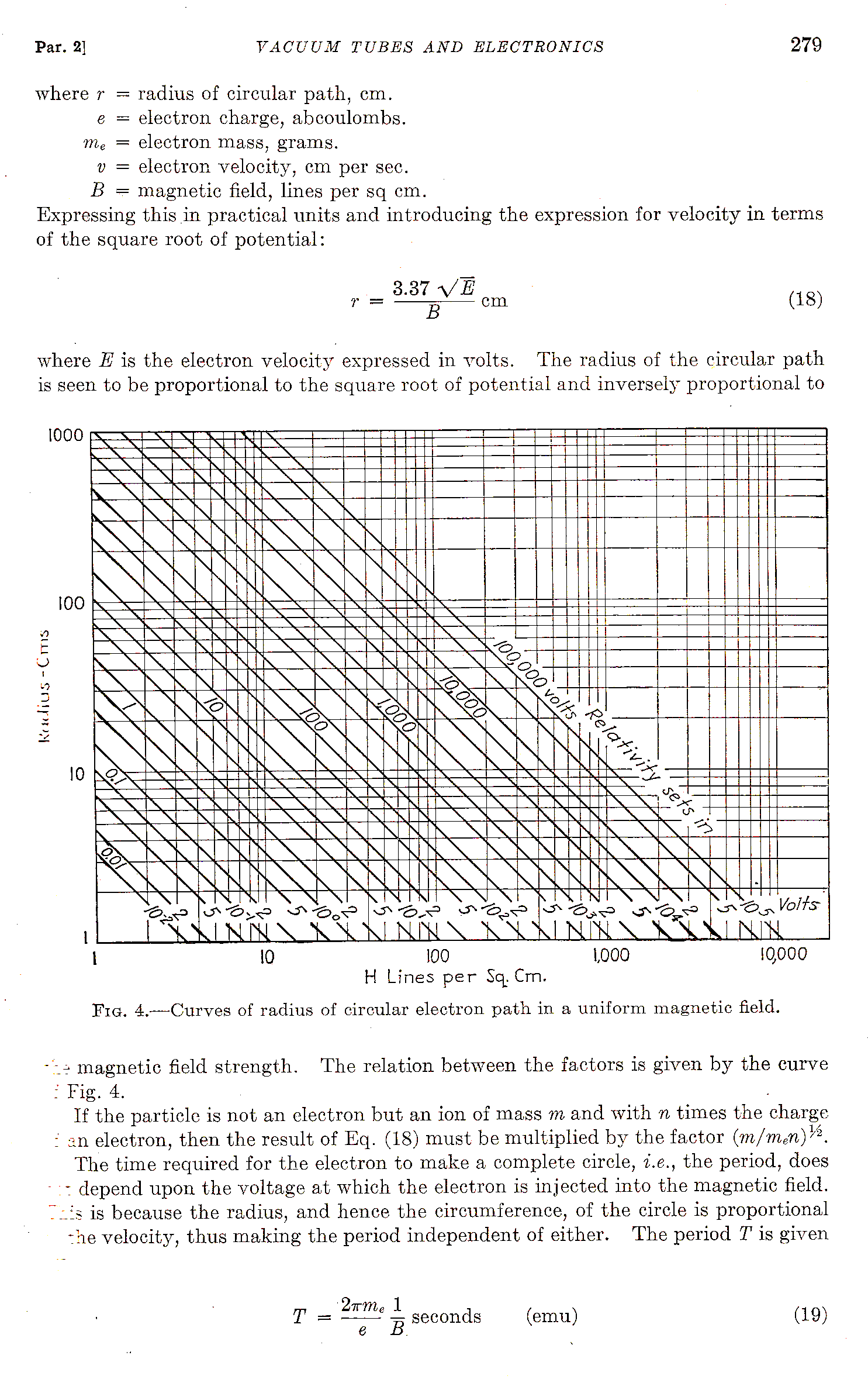

People wanting to mess with charged particles and magnets might also find this page scan interesting. Sorry 'bout the focus here, I have just one good copy of this and I'm not going to cut it up to lay flat. Once again, real units!
