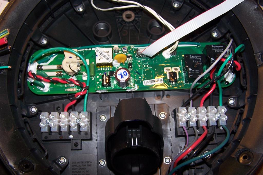

These units are kind of expensive. The GM Voltec is by far the cheapest at "only" $515 delivered - people tend to pay about $2k to have them installed, even with subsidies, as they just mark up a local electrician until the subsidy is gone, plus about another thousand bucks or so - it's not a not for profit outfit. You'd think you get a buncha fancy stuff for that 5 bills, but here's what you actually do get:
Guts of the Voltec unit.
In a big plastic box, you get this little circuit board that's mostly blank. Fuses, then a GFCI sensor, a little +/- 12v power supply to run a uP, and a couple relays to switch power out to the car. It comes with a long coiled (ugh) cord that puts way too much side-stress on the car connector for my taste as well.
It turns out, that's all you need, and even a uP is kind of overkill for this. Sure, since they have it, they check AC frequency and voltage and a bunch of other stuff and refuse to work if anythings not perfect, but so what - the car doesn't care, it's just a brute force rectify and switch into the batteries kind of thing at the other end. After all, they don't have to change the car for 208v (between two phases of 3 phase) or UK, at 50 hz and whatever - it's just a universal switcher in the car.

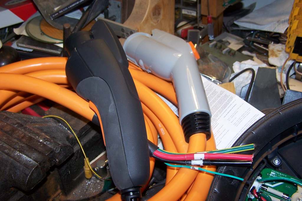

Thus are all slick projects born. As mentioned above, I bought one of these expensive cords, raw, to implement my own system for this:
Better cord from TusconEV, also expensive, but lookie that fat, straight wire!
Got this nice orange one from http://www.tucsonev.com/
This uses straight wire (which I prefer) and this one's number 8 stuff - not number 12, so less losses at 15 amps. It's longer than the Voltec/SPX unit and obviously much better made. The only difference is it lacks the built in led flashlight on the end, but has a connector cap to keep mud out (important here). There is an open EVSE project out there that uses an arduino to control this, but I like PICs, and theirs also doesn't have the desired/required features (though I could probably add them if I wanted to bother to learn the ins and outs of yet another UP). Here's their page - I've asked them a few questions, and they've helped with answers. I plan to publish this there and here as well - the more open source ways there are, the better. http://code.google.com/p/open-evse/
