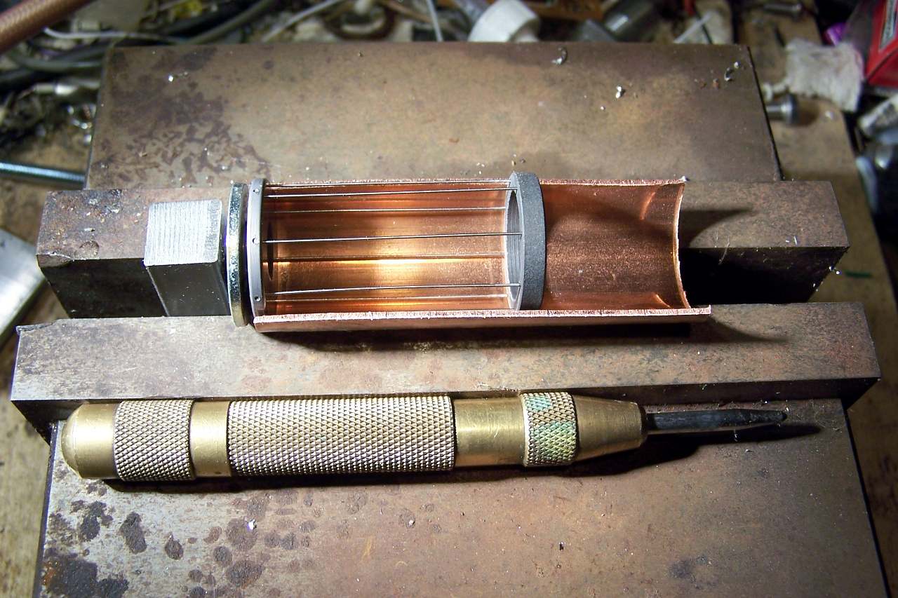

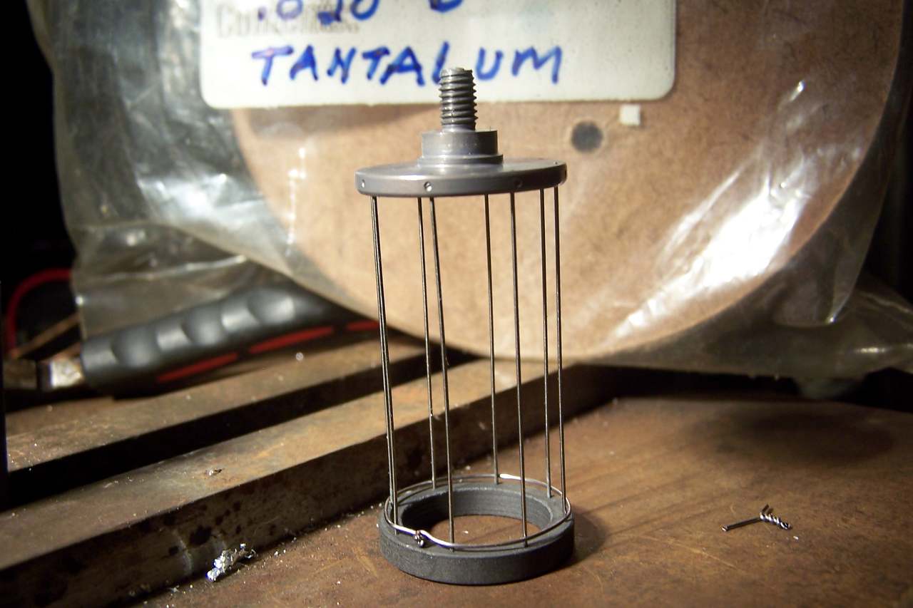

First, here's the new grid under construction, in a jig I made for keeping it straight while setting the rods. The Ti base was fabricated here from a 1" rod of Ti, cut down on the lathe and drilled in the mill with a circle table. This was done so we drilled through the Ti, and partway through the graphite ring beneath it, so for better or worse, all the holes line up perfectly. I actually used a 5x stereo loupe to observe the exact marks on the circle table to get it as close to perfect as I could. The Ti here has been anodized to reduce sputtering and arcing - this has shown to work very well with Al, so I thought I'd try it with Ti too. The Ti, where the rods go through is about .1" thick, or thinking another way, the holes for the rods are about 5 calibers deep. This was one tough job of drilling - .020" drills are on the fragile side, and breaking one off in the work is almost always a disaster. The rods, once set in place, are staked with a spring-loaded center punch. This only works with a strong punch, and holes that are right at the edge - these are about 40 mils inside the rim.
Obviously, there's no hope of having the rod straight post staking if it wasn't before, so I built the jig pieces shown. There's a tapped chunk of steel to hold the back level, and a cut piece of 1" ID copper pipe to hold everything perfectly aligned (well, kind of) while doing the deed. This leaves the carbon ring at the other end just a push on, and with forces we normally see, that's not good enough, so that end gets a girdle. In this case, I used .020" pure tantalum wire, because I had it (Thanks BillF) and its ductility makes this easier than using, say, type C thermocouple wire (W-Re alloy). We've been playing around with a shield for the feed through glass behind the grid. This seems to surpress some sputtering and arcing, while also making it harder for hot ions to hit the glass and reduce it to silicon metal - very bad, that almost always results in shattered glass. Here's the old prototype, and the new one I'm installing today: And it looks like this with it all installed: This time, since getting too eager tends to mess things up, I let it pump down overnight before even thinking about doing the conditioning. This AM, the pressure in the tank was about 5e-8 mbar, pretty good, so I proceeded to condition the grid. I set the supply at a reasonable (for me) current limit - 15 ma, and 35kv initially, but didn't turn it on till there was enough D in there to hold it at 5kv or so, gradually taking out gas as the little arcing spots went away at each voltage level. I did push it a little fast today - above about 40kv, it's going to take a lot more time and care to get this really broken in and all the tiny whiskers and contamination gone.
