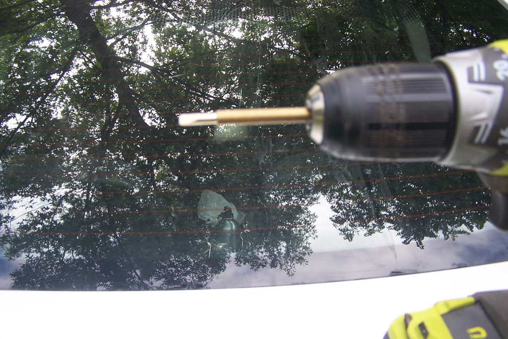

The next step here is to clean the primer pockets. I want this ammo as reliable and safe as I can make it, since it's going to be shot by noob journalists on camera, for one thing, and out of several different guns. While not strictly required, for either safety or any but hyper-accuracy, I just do this, it's simple and worth doing. Primers have three little legs that seat against the bottom of the pocket and a precise amount of crush is required there to get uniform primer behavior. If there's junk in there - no way the next primer will be seated at the same place the last one was - all 3 legs won't be set the same, leading to inaccuracy and worst case a misfire. So we do this here on all rifle rounds.
To do this, I made a special tool - makes it easy and quick. The tool is just a piece of 1/4" brass rod turned down to .170" (about the size of a small rifle primer) and ground with a screwdriver tip to spin in the pocket. You don't have to use a drill or drill press - this stuff is crusty, brittle, and comes right out easily even if you just hand hold the tool. But doing a few hundred rounds, heck, I use the drill. There are other tools sold for this, but this is so simple to make, why? You could also file down a small normal screwdriver, but you want to be careful then to not scrape brass off the bottom of the primer pocket. Sadly, this is out of focus, but it gives you the idea - nothing fancy here.
Blurry but this is simple, maybe I'll get a better pic later
Here's what the process looks like in action - I find it good to learn from how someone good at it "holds their mouth" - this communicates about how hard to push, how long to spin and so forth better than mere words.
