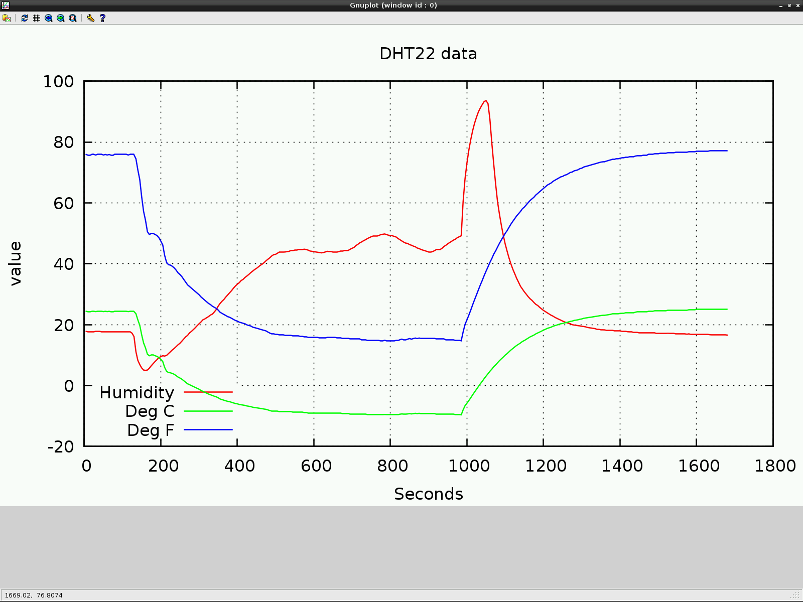

Here's a plot where I was taking data kinda fast (5 second intervals) and just testing the sensor itself. I went to 1 minute for the overnight run since it's so slow anyway. You can see where after letting it sit on my bed for awhile, I dropped it out the window. It's on one end of a 9 wire flat cable I happened to have some stock of, one wire is +5v, one is data (in the middle) and the rest are ground, and it's about 20' long with a 10k pullup - so these things don't mind a little cable run, cool.

Like I said, more tomorrow, including the code etc. but for now here's the response time plot of the thing. It's pretty obvious where I walked it over to the window and tossed it out, then later brought it back in. Good old exponentials, more or less.

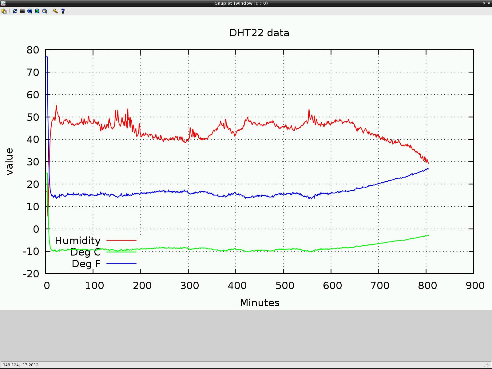

As promised, I let the thing run overnight on the coldest night here so far this season. When I got up this morning (late, around 10 am), I stopped the run. Since it was cold in here by then (wood heat), I started a couple of gonzo propane heaters to make it tolerable in here, waited for that to happen (it's fast at 200k btu or so), then started another run, pulled the sensor in and set it on the bed, and turned off the propane heaters while I ahem, went to the building next door to use the plumbing (which survived, likely do to my preps and running a blazing fire there, last load at 7 pm). I then started another run and pulled the sensor in and put it on my bed. I saw the usual spike in RH as condensation probabably happened on the sensor, then the usual slow recovery to room temp, which then fell a little as my wood stove in here hadn't yet caught up.
Here are the results.
And a zip of the entire thing, including code. Morning and pulling it back inside: I'd love to make an image of the pi as configured and share it, but it's a gb zipped and last time there was a disaster - both dropbox and my "unlimited" ISP shut me down when I tried last time, with only a single download they stopped in the middle (me, testing the upload at 4 mbit/sec). Wow, some unlimited, eh? I'm using a 16 gb micro SD class 4 or better card for the pi. I suppose I could mail them if people sent me a blank one and the usual self-addressed stamped envelope.

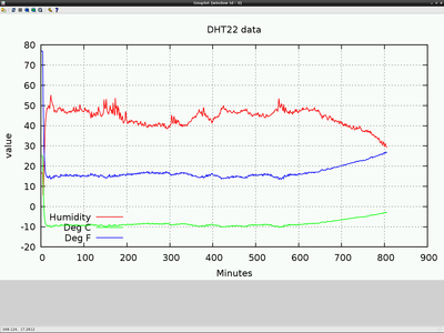

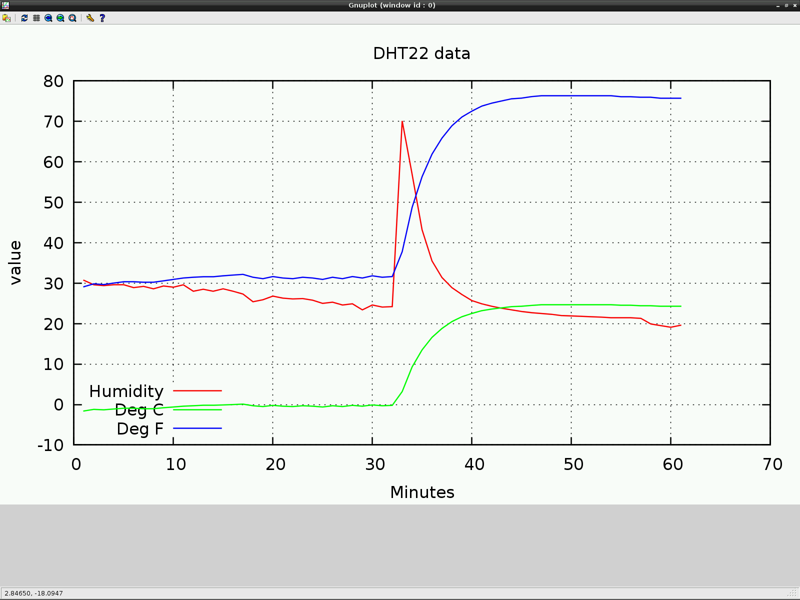

It missed us, thankfully. It got far too cold for snow here - the water all dropped out far north of me. I do plan to carefully calibrate one to put on my cistern, though, and use excess solar power we sometimes have to store heat there in winter so it won't freeze. I suppose I could put this sensor in a baggie and immerse it in an ice bath to find 0c or whatever water freezes at at this altitude accurately.
