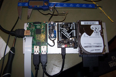

Here's the build - it's going into a cabinet in the wall of my living room, so it doesn't have to be purty:
Just bolt 'em to a plate and screw the plate to the back of the cabinet.

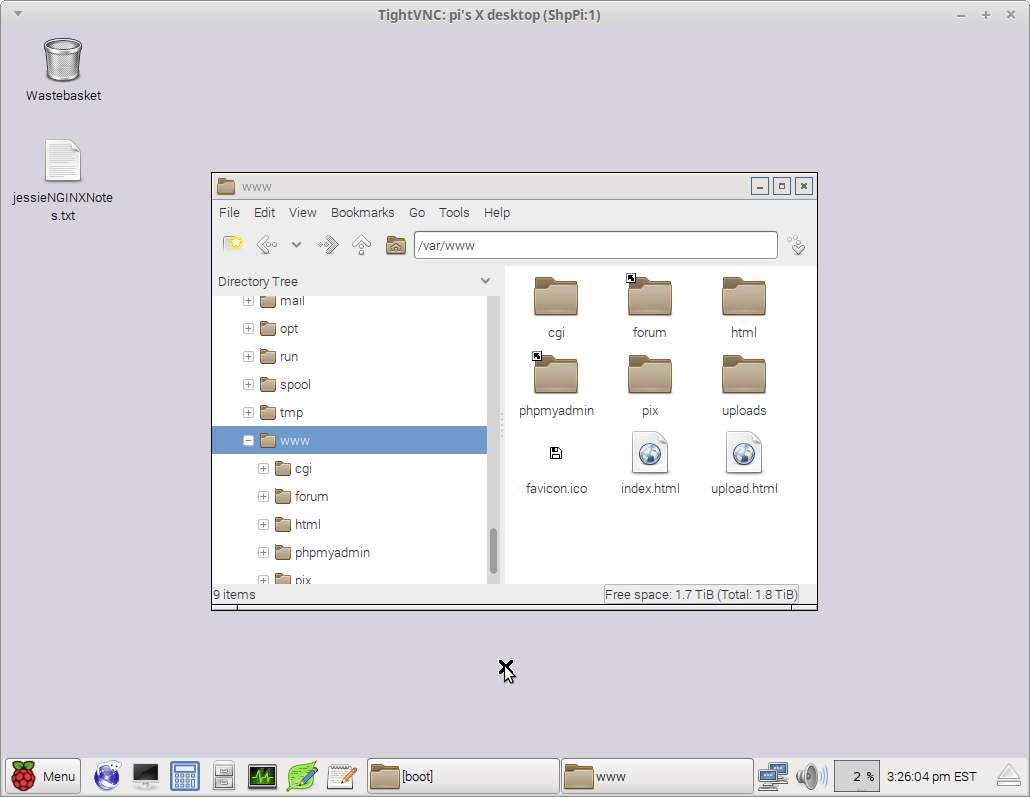

Here's what my web stuff looks like on the pi - and I didn't even have to disturb the cat on my lap to go over there - I got this shot via vncviewer, as the pi is running headless anyway:
Pi screen showing the web stuff.

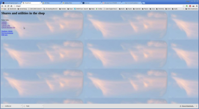

This is pretty cool...I haven't used the arduino for anything yet, but if I have enough trouble getting the pi to control the pan-tilt stuff for the camera, well, I already have an arduino sketch for that...who knows, maybe I'll add some other data aq to it.
This doesn't look impressive - I don't care. It does a very worthwhile job, no ifs, ands or buts. You don't look at the home page - you go do things with this, right?
