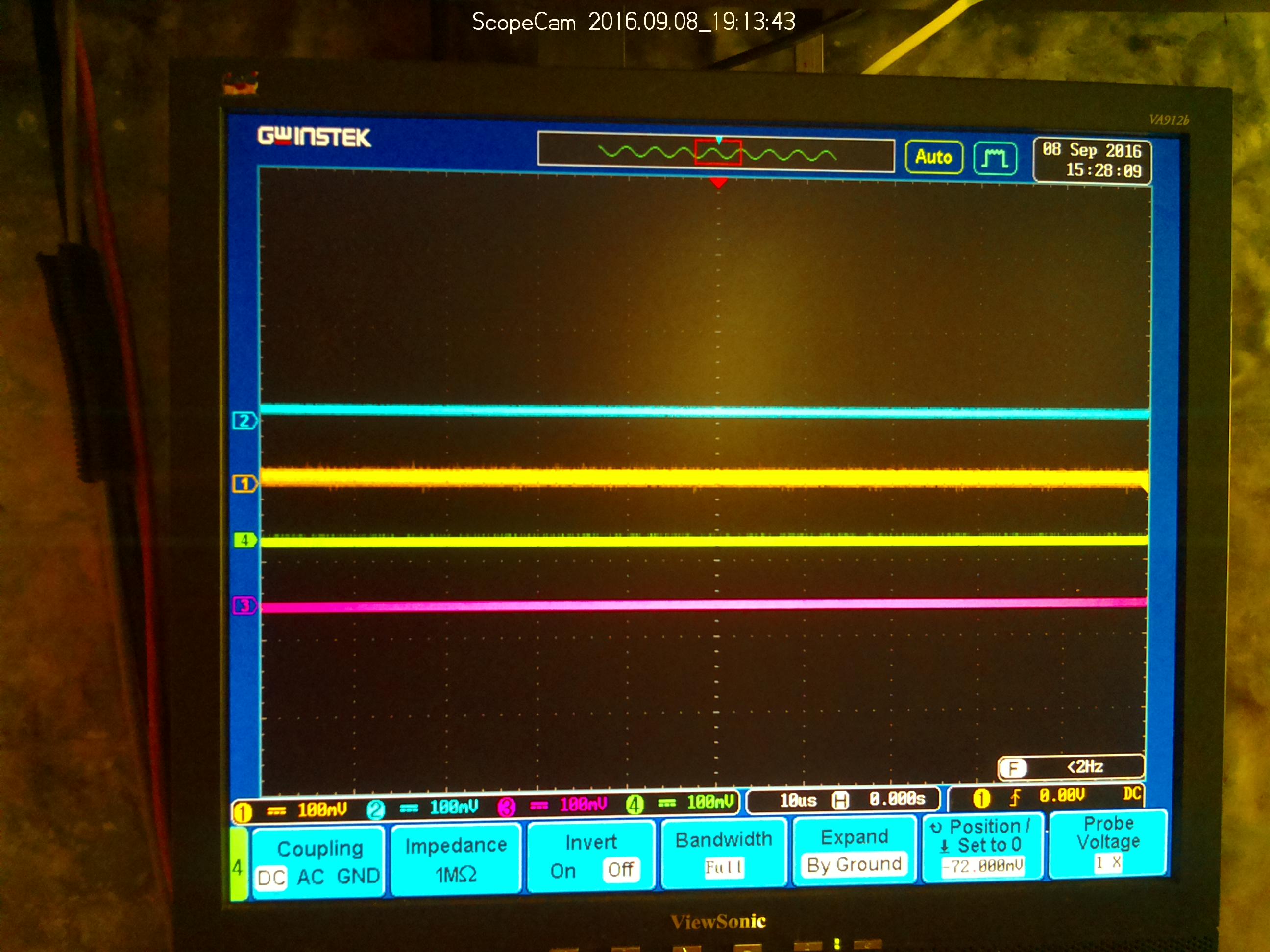

Taking a break from all that wiring and grunting on the messy floor over there - this isn't the same as my nice spacious well-lit workbench that all this got built on.
But, I have some neat pix to share from testing out two of the three cameras; I'm not sure at this point if I need the third overview and servoe'd camera, as it's going to be a heck of an emi risk with that long flat cable, and I don't have a couple meters of 1" diameter braid to put over that. I have been using the 3rd one to just peek at the power supplies' front panels while I test the remote control. Don't even need good focus for that part.
It's slightly weird sitting here at the op position and hearing some very high fidelity, perfect imaging audio from "over there", fans, pumps and so on. Almost as good as a picture.
But not as good as these pictures: I remember the days when we wouldn't convert data to human-readable ascii to save bits over our low bandwidth modem. Now you just real time stream HD video from a scope screen, as it's easier and cheaper. Wow. This cam really takes a beating despite the half inch thick leaded glass it's looking through. Sparkles from X rays and neutron hits on the sensor when the thing is running. RIght now, I just have a 500w "stab in" bakeout heater for light.

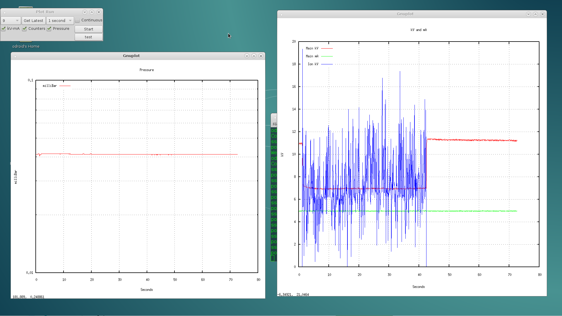

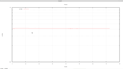

Rrealtime plotting from SQL replica coming along, far from perfect, but...
FWIW, I'm doing the dev on an odroid xu4, which has two advantages over the big machine - it draws next to no power so I can work on it after sundown...and it's very pi-like so the habits transfer easily.

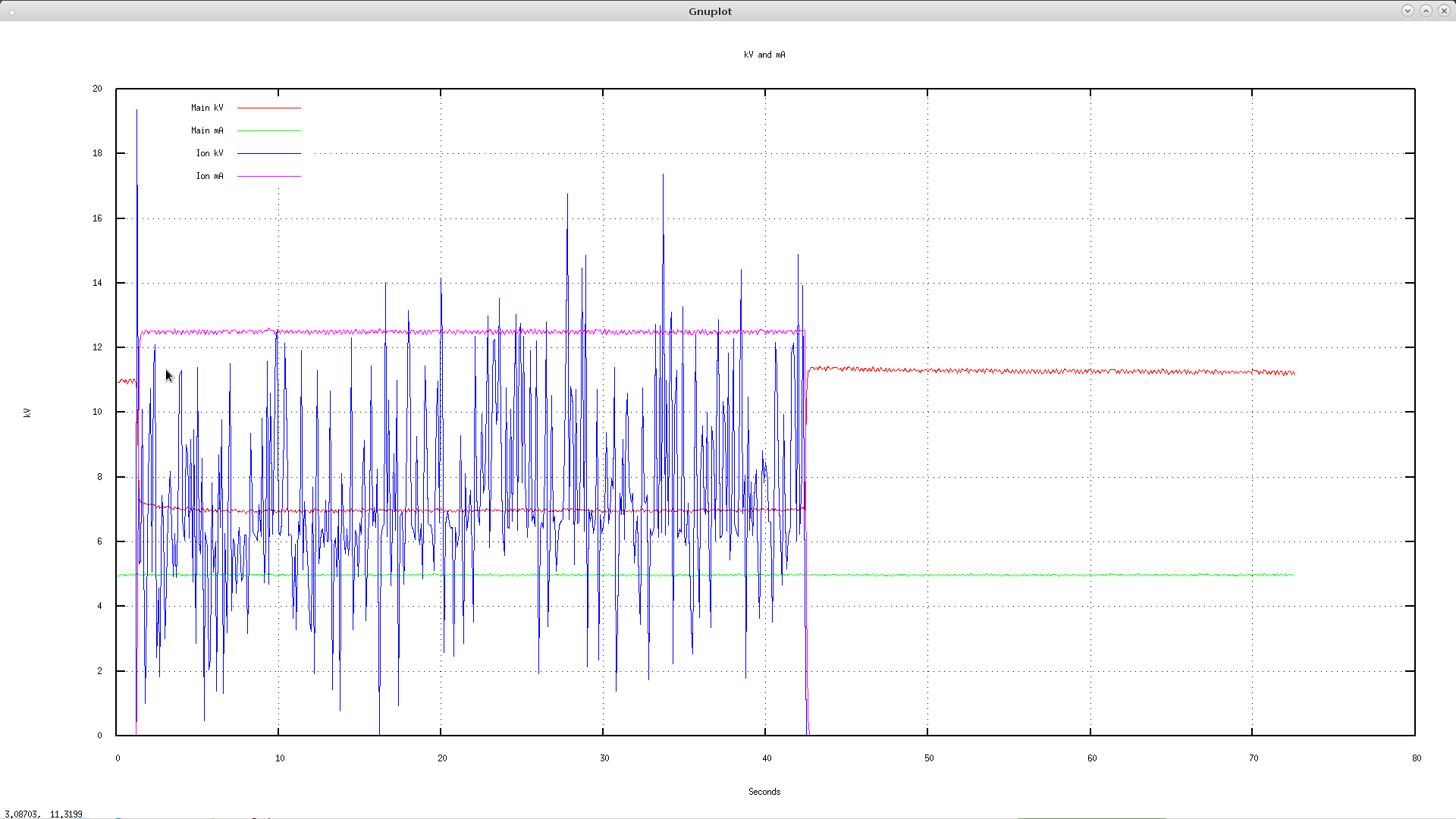

Clearly, I have an issue with the ion volts measurment, which was showing up weird on the analog meter too, earlier. OK, maybe I either need to find and fix the ptv supply or just make another voltage divider.
You can also see in these a difference in both start time and noise floor between the two arduinos I am using. The one doing pressure is the newer, better structured code that takes 10x the number of samples and does some fancier DSP on them - it's so much better that it's still nice and quiet after exponentiating the input.
There are for certain NOT our usual operating conditions. What I'm doing here is using way too much gas to load the various supplies to their current limits so I can calibrate these plots to the analog meters when things are stable.
You can see (with some interest) that even under total current limit conditions on the main HV, that turning the ion source on and off (obvious despite the noise) changes the voltage it current limits at. Shows my dinky GUI for this too. Ion current and voltage are measured at the supply, not after the ballast R, so I'm suspecting that crazy volts plot is instrumentation error. Well, accurate is relative in this case. That's what the pfeiffer display said too, but the dox on it say it reads high on hydrogen, which is what was in there (well, it was deuterium, but...).

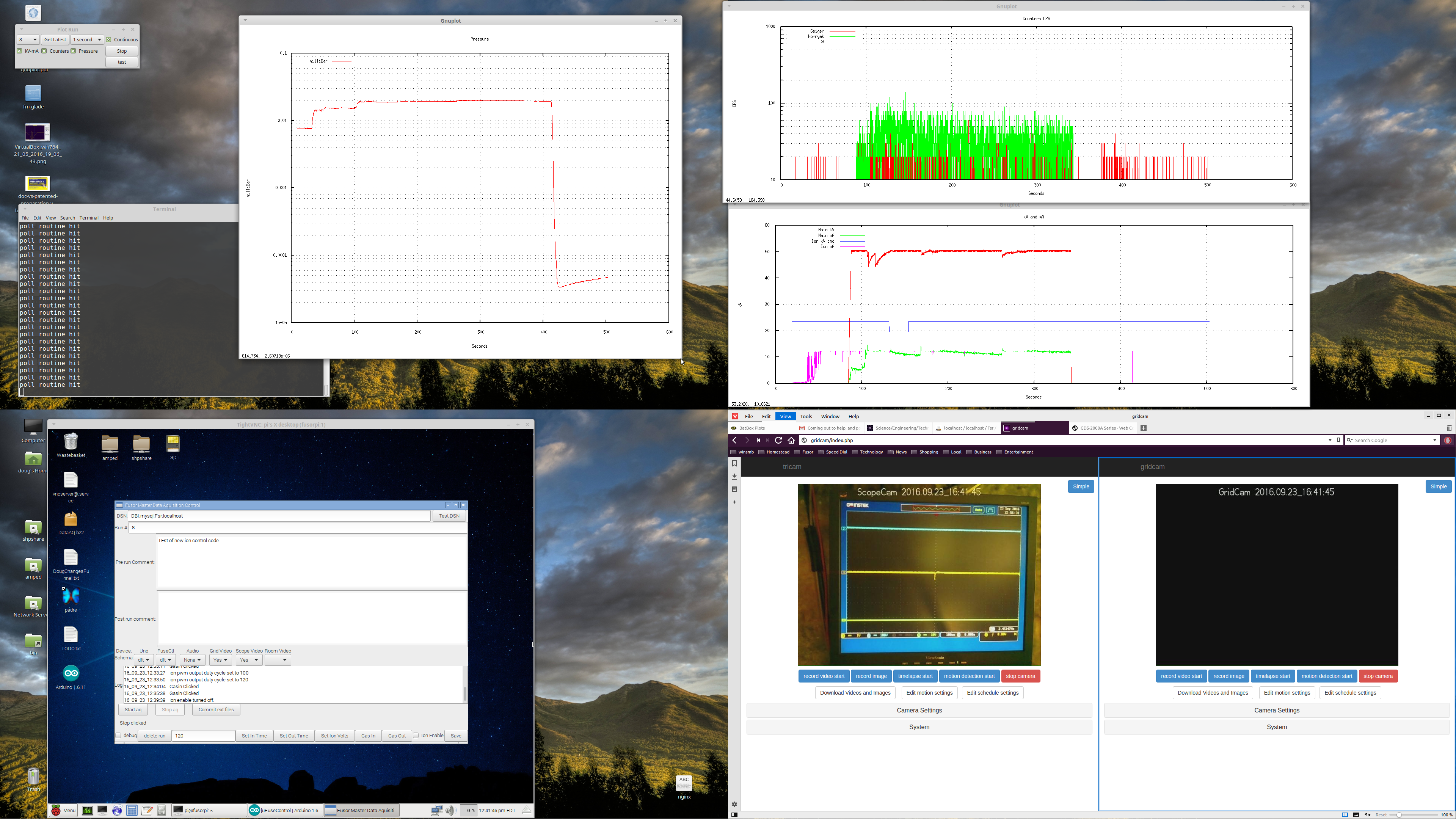

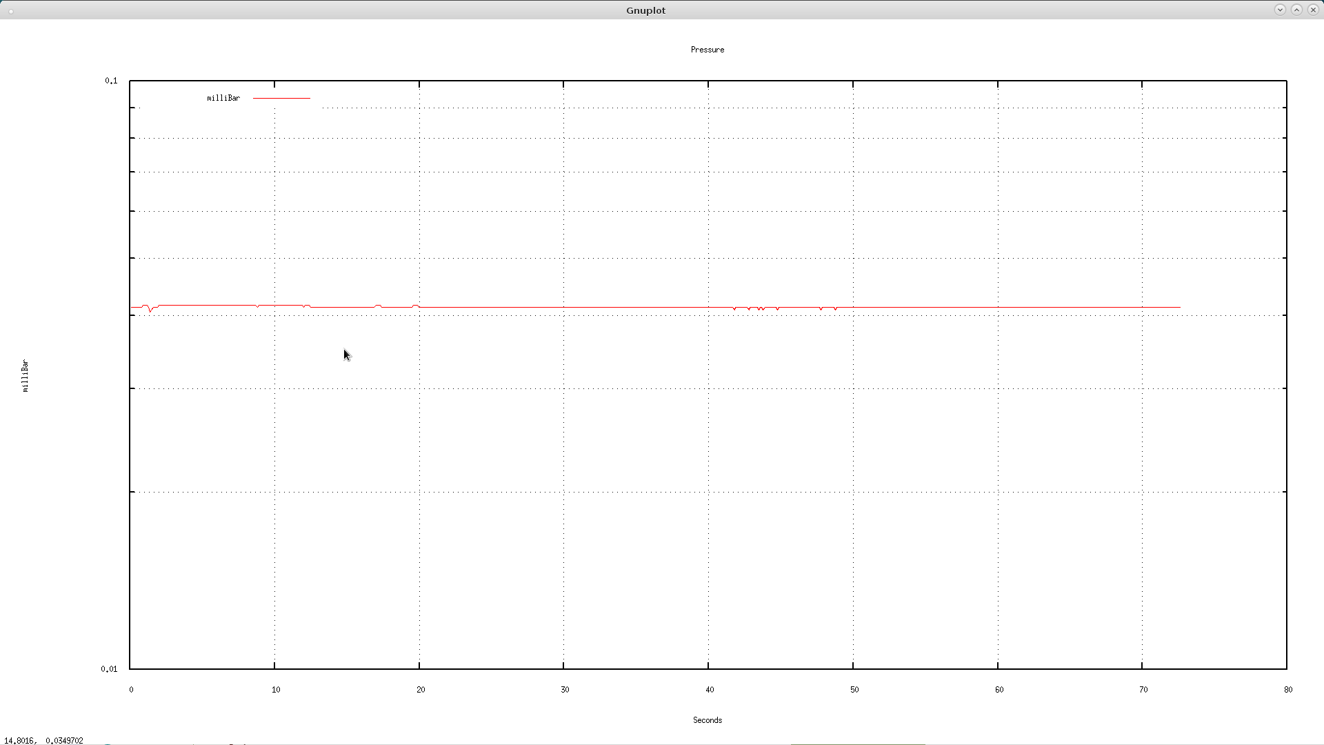

Here's a screen shot from the end of the run in the videos:
I'm streaming two videos live from two raspberry pi's that are recording and slaved to a third pi, which controls 2 arduino unos that actually take the data plotted here - that pi talks to the operating position and also runs mysql for the data, which is real time replicated here "just in case". Times are in tenths of second since start of run. At tne end of the run I turned off the high voltage and ran over to put the silver, then the indium on the geiger counter, but silver decays very quickly, and indium is harder to activate - you can tell the difference between the background count rate and when I did those things - barely, at the end of the plot for counters. No worries, we first of all can trust the hornyak, and secondly, if the gonzo mode works, the indium at least will be plenty hot after a run.
Note on pressure. The documentation for the Pfeiffer PKR-251 gauge I'm using says it reads high on hydrogen (or presumably, deuterium). But we're in that middle zone where no one knows what to call this vacuum, and in it's middle zone where it's not sure whether the ion gage or the pirani should take over. So it's a factor of something a little less than 2 high on pressure is the best estimate. Fusors are so touchy that in fact they are far more sensitive to pressure than any gauge you can buy, and after you know the number once...you can count on the fusor itself more than anything else. Too much gas and it becomes a pretty good zener diode and your supply current limits. Not enough and it won't light off at all, and the range is way under 2::1 - even with an ion source. We are in this funny place between "viscous flow" and "molecular flow" which vacuum math doesn't handle well - even when the particles aren't charged. It only gets more complex than that. This is the 3 body gravitational problem only with 10^20 something bodies and two "polarities" of gravity. We have both molecular and viscous flow at the same time in different places, as well as whatever you call those things with ions that can "see" each other even if they're not bumping into one another via Coulomb forces.
I think I learned an important lesson here. When you live in "nowhere" and only have 1 megabit/second top speed, one doesn't upload near-gigabyte videos often. I should have edited out a few snips to comment on here, and will in the future.
Video times are UTC via NTP.
Scope: https://youtu.be/9_UBf5TTTug
Key - yellow trace is the neutron detector. Anything > 2 major divisions is a real neutron. We are triggering on this.
Blue trace is a faraday probe in the tank, about 3" from the main action, and opposite the ion grid. When it goes big-negative, the main HV is on, and we note this isn't exactly a neutral plasma, is it.
Green trace is EMI picked up by a probe a few inches from a wire on the ion grid (south of the ballast R). When it jumps positive, it means the ion grid stopped drawing current for a bit.
Now I can proceed to try "gonzo mode" from a safe distance, or nearly. Almost all the kinks worked out of the remote control now. Minor changes, then we can go places and change the world (I hope, at all, and for the better).

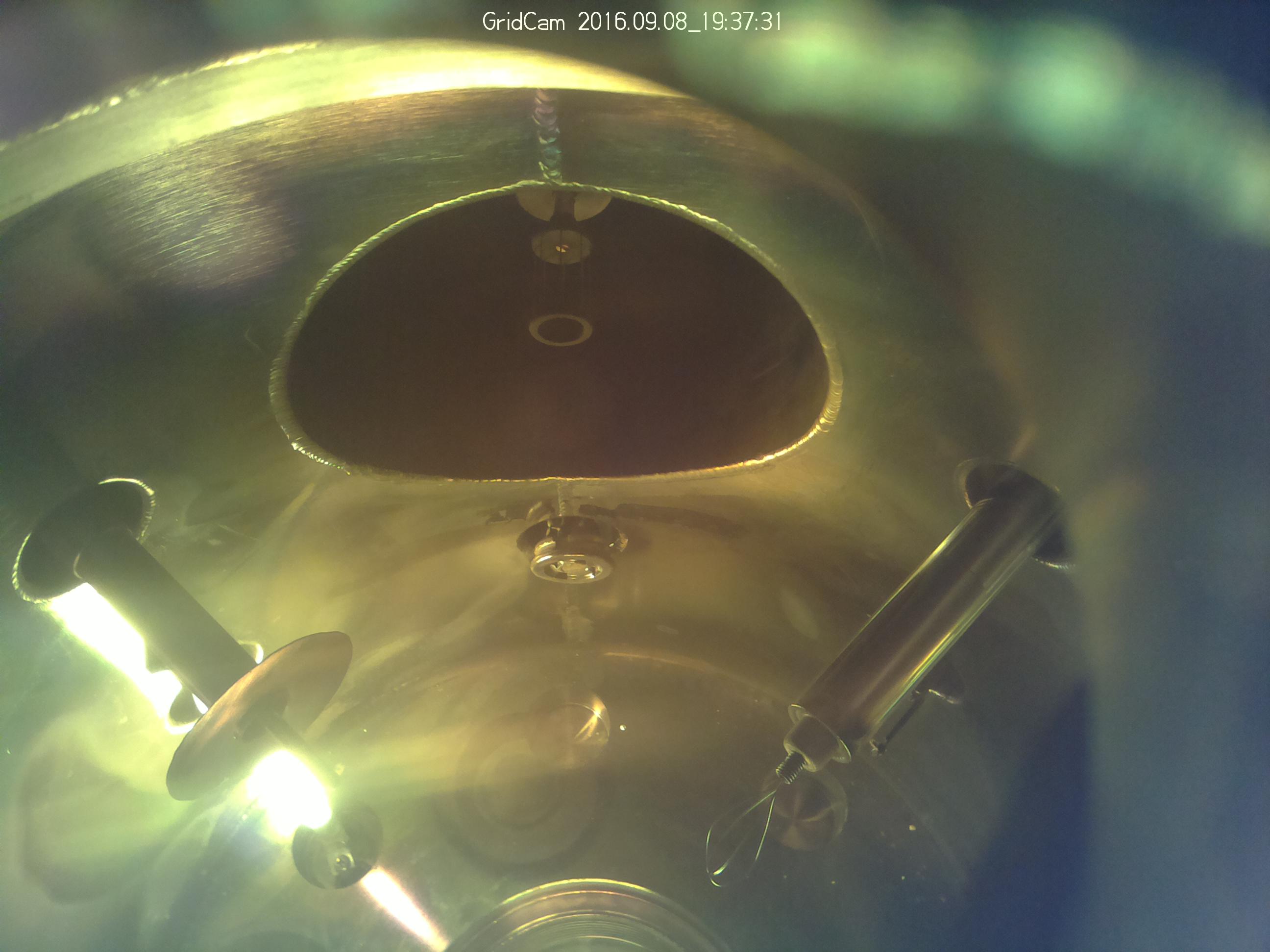

Grid - fusor innards. This was a lot shorter as the video compression was easier to do, I suppose - factor of ten or so fewer bytes, same time (cams are started in sync).
https://youtu.be/lqxArGT1s5c
Yes, I got the grid a little warm by the end. I was playing around with the tradeoff between running higher pressure and the main grid alone, and running less but with an ion source. The data is good as far as I can tell, for my setup. This has all been calibrated the best I could manage, and the plots (click to enlarge) seem to be "on the money".
Key: ion grid in lower right, main grid upper middle.

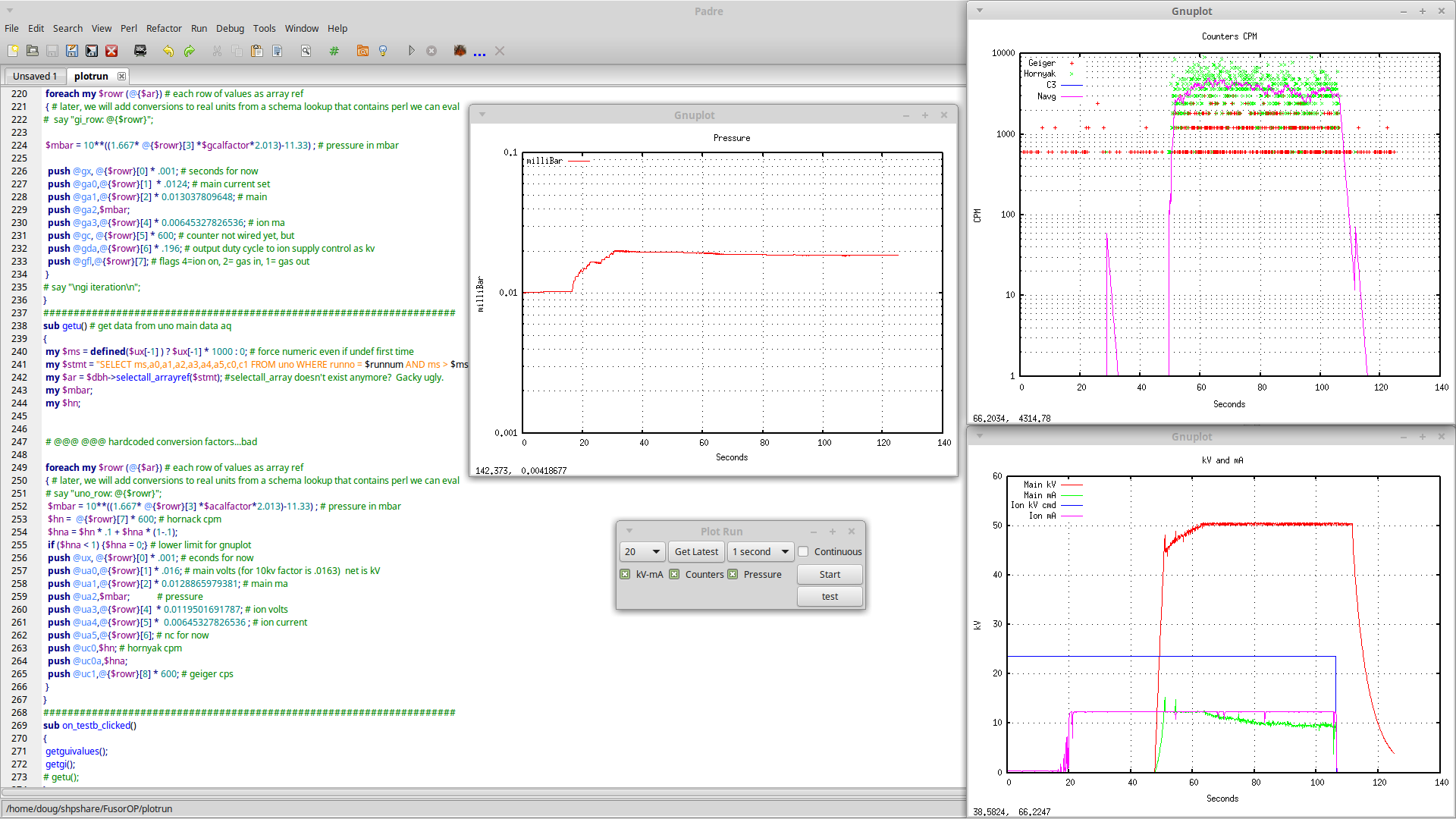

Couldn't resist posting the results of a short test run today (I'm working on the plotting code and video compositing, more soon). Who says perl has to look like line noise or be slow?
Sure, almost any language can be misused - they all hand you enough rope to shoot yourself in the foot...and yes, I'll be posting the source up here when it's ready, or close enough.
Though a lot depends on my exact setup here, it's pretty good as an example to modify for your own.
I changed the scaling to CPM, since that's what we all think in, and this is why the counts look quantized - we are actually taking counts at 10Hz and have to multiply by 600 to get to CPM.
I changed to points on the geiger and hornyak plots so the odd line going back to zero (with short counting intervals, you get those) wouldn't hide the stuff behind it, and added an averaged neutron count as a line.
