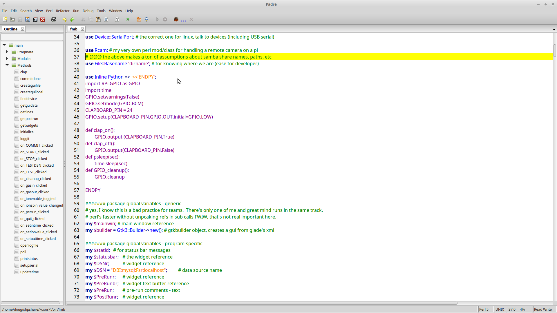

Here's some gratuitous screenshot action from padre:
Nice highlighting and navigation in padre

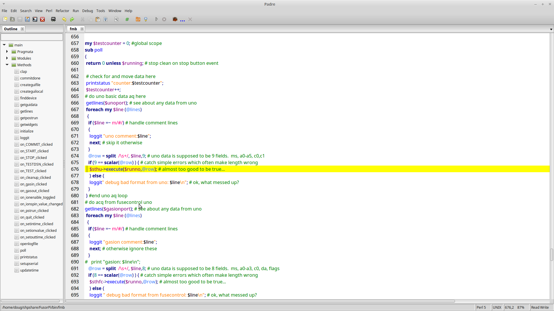

The routine where the action is during a run

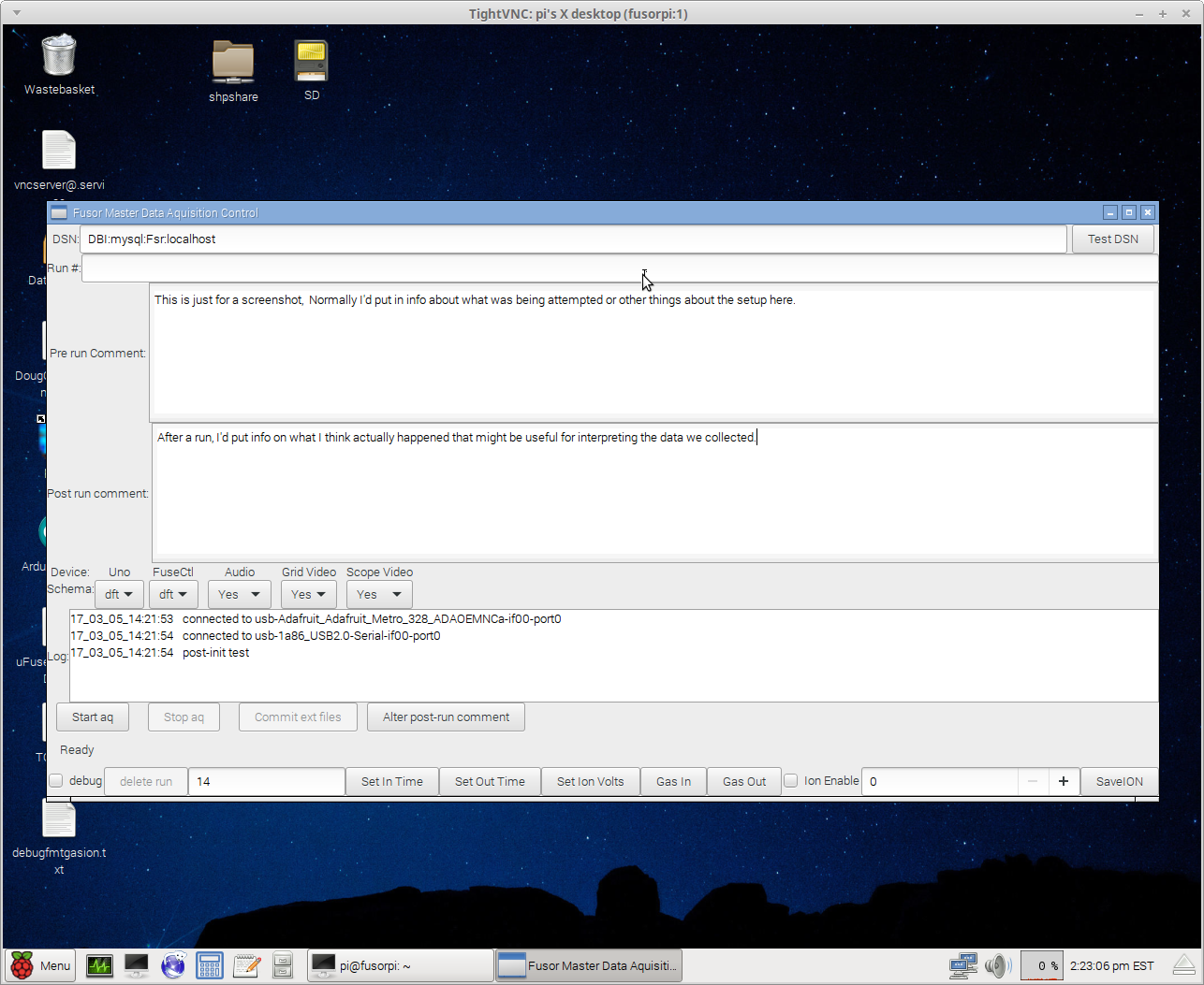

What I see via VNC at the op position - this is fusorpi's screen.
So, the above is my master control panel, so to speak, for the raspberry pi nearest the fusor (there are a couple more that are used as video cameras). Fast enough, and cheap enough not to care too much if I happen to fry one.

Yes, when set up right, it really is this simple to stuff formatted data into a database which then automatically replicates on another machine just in case. This "poll" routine is actually called by the GTK runtime at 250ms intervals and it merely scoops up data from the arduinos and parses it in order to stuff in the database, using prepared statement handles. But perl is so hard to read (chuckle) no one would ever figure that out, right?
