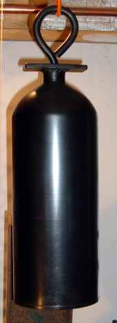

bell Friend Paul spent a previous life as a firefighter, had access to some out of date CO2 cylinders, and wanted one made into a bell. Here is the result. One of the others became the bell jar for our vacuum system..
When he brought the cylinders over, they were in mucho rough shape. So, the first order of business was to take out the valves and chuck them in the big lathe to scrape off the paint, rust, and crud and get down to clean metal. The lathe was also used to cut off the bottoms, with the Bosch jigsaw used at the end to finish the cut.
The bell potential was evident as the final turning operation was done; the thing started ringing and making the tool chatter. I'd estimate it hit 150 dB or louder before I could stop it! Literally slammed our eardrums into their stops with a great deal of pain.
Paul wanted the arrangment at the top, so we made that next. Forge work is fun in the wintertime. That big 5/8" stock bent like a limp noodle at yellow hot. Then it was welded into the plate from the back side, and the plate welded onto the cylinder. At this point we had a ringing bell, but it obviously needed some surface coating. This caused us some pause, as this thing is meant to be hit, so paint was probably out as a practical coating. It would probably also affect the tone.

The result is phenomenal. A light tap rings this loudly and clearly, and it rings and rings and rings. This could definitely annoy the neighbors, or be heard for miles. Paul is going to make a leather covered wood striker for this, and a stand. With the soft striker it ought to be a little tamer, which would be a good thing. The finish seems just right for this. It will take strikes from a walnut knocker with no visible damage. It's hard to take a good picture of a shiny black thing, but in person the effect is very nice. To accelerate the rusting, we use a chamber Doug built that is just a 2' x 2' x 4' masonite box with a door on it, which has a hotplate inside. On the hotplate is put a gallon sized container of water, which is kept just below simmering heat. Various hangers in the box allow for workpieces to be supported without contact on their bottoms. The outside of the box is insulated with R–Max. We run the temperature in the box at about 100° to 110° F, adjusted by the hotplate setting. What you are trying for is a coating of very fine grained rust. When things are working right, it sparkles a little. The arcane secret formulas were developed to get this to happen fast, without the rust also becoming coarse pits. Basically, less is more here. You could try diluting regular ammonium chloride / zinc chloride liquid plumbing flux about 10::1 for starters. 2% ammonium chloride by itself works great. You don't want condensation on the workpiece, which washes off the formula and generally makes things look bad and uneven. On the first pass, both the work and the chamber are cold, so no problem, they will heat together when the hotplate is turned on. On subsequent passes, if you work fairly quickly, the work will still be hot from boiling it, so again, no problem. But if you put room temperature work into the steam bath, it will fail.
