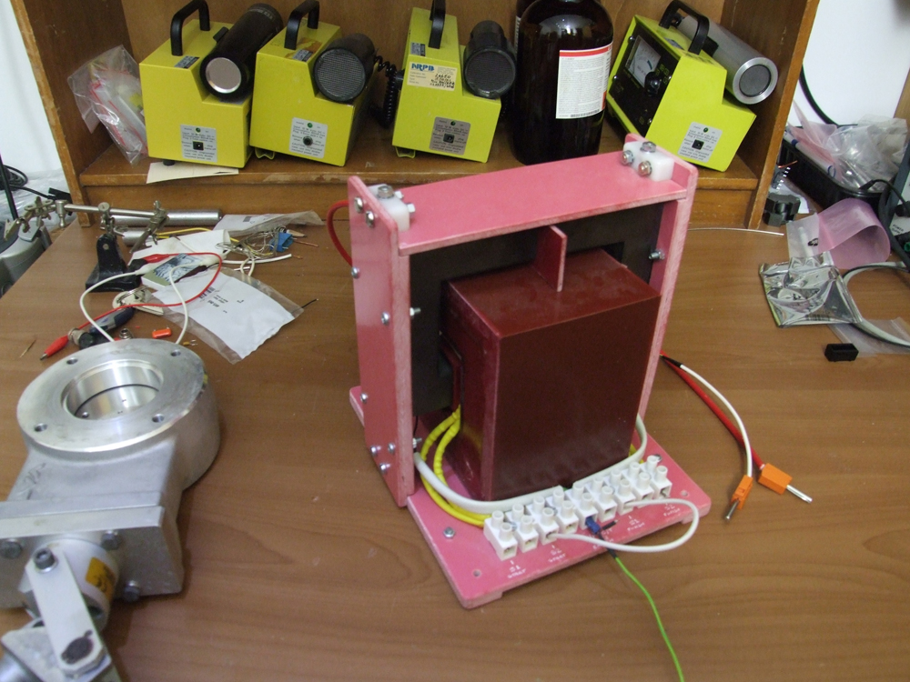

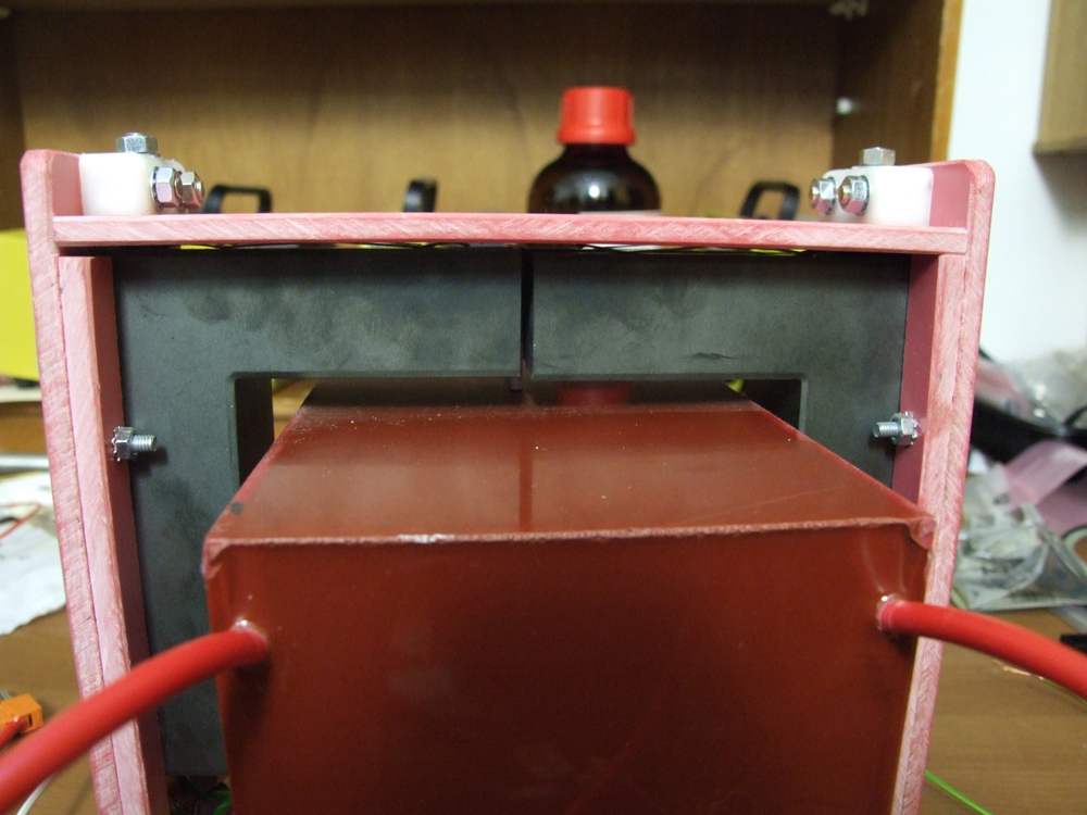

The low down on the transformer:
This transformer has two primaries. They are made from 4mm diameter litz wire, what looks like about 10 or 12 windings each. I thought they were interlaced, but now that I look carefully, I see that primary one is actually wound around the ferrite core first, then a layer of insulation, and then primary two is wound over primary one. I never noticed this before and I guess that it means the primaries do not contribute equally. The dc resistance of the primaries is 0.1ohm each.
The secondary was designed to carry about 0.5 amps - so I presume the wire is around 0.2mm diameter, although I cannot see it as it is potted. The secondary is centre tapped to earth, and this earth wire is connected to the ferrite core by copper plates in contact all the way around the core. The dc resistance of the secondary is 11.5ohms each to the centre-tap, 23ohms all together. The secondary is wound above the primary, on the same side of core.

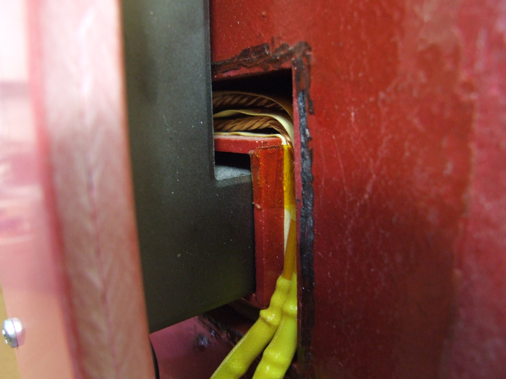

The core itself is made up of 2 square '[' shaped halves, forming one large rectangle '[]'. There is a 3mm air gap top and bottom of this rectangle - so the '[' shapes do not touch - they have a some sort of 3mm hard plastic shim keeping them apart.
I have some other figures here but I do not know if they are accurate: The input impedance of the primary is low, so that would require the driver to have a low input impedance to match. I have a figure of 19uH for the input, with a self capacity of around 115pF. The self capacity of the secondary winding is more like 35pF. I'm not sure if that makes sense or if these inductance and capacitance values are manufacturer measurements or just estimates. It was designed to resonate at 40KHz, but it looks more like 63KHz based on those measurements in the previous post. The people who built it never had any means of testing it.
The next obvious step here is to run it again with just one primary.
High voltage transformer
Primaries
Primaries
Air gap
Air gap

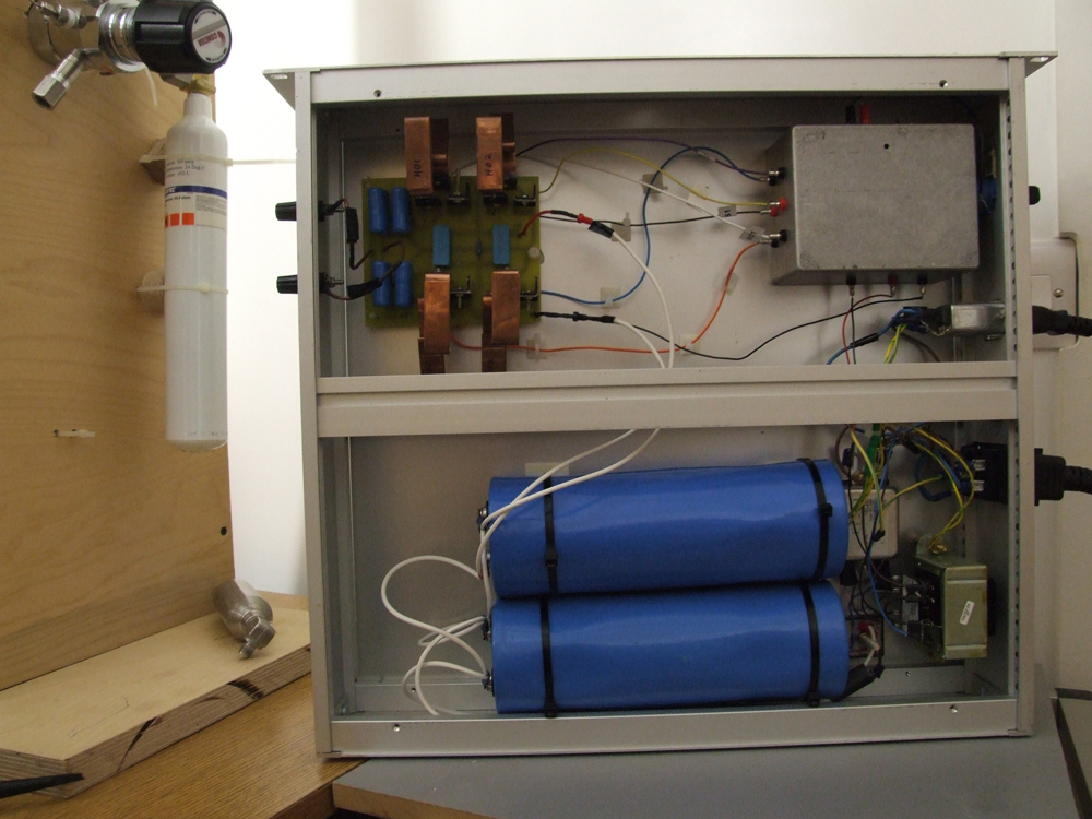

Shielded driver and H-bridge with smoothing caps

In an iron core circuit, the fact that one primary is outside the other isn't a big deal at all -- the "iron" in this case being ferrite, but still hundreds of times more magnetically conductive than air, so a little air here and there just doesn't make a noticeable difference -- it's really how many times a wire goes through the hole that matters most. The gap spacing does -- those shims you mentioned. They are there to control how much net "mu" the core has, and to prevent it from being "too good' and saturating so easily. So in fact by changing this shim thickness you can tune the thing all over the place -- a tiny air gap has more "reluctance" (which in magnet-speak is roughly analogous to resistance) than the length of core material does, because the core material is hundreds of times more magnetically conductive than air is, or thousands, depending on the material. The gap is used to tune that parameter overall as far as what the windings see. It's not normally used in AC circuits, but is often used when there is supposed to be a DC component in say, a switching supply inductor, so the core doesn't saturate. In this case it's cheaper to use more wire to get the inductance back up than tons more core material.
I couldn't easily tell what the square area is on that core, but it looks like about 1 sq inch (sadly, I think distances in "English" while the English have gone metric, but I can understand either).
I'm able to get about 8v/turn without saturation on cores here about that size with no gap, for what it's worth -- if yours is bigger than that in square area, you should be able to get about that much more volts/turn without saturation. In your case, reducing the gap makes it easier to saturate re current (ampere-turns), but willing to take more volts/turn before the same current is drawn (because of the higher inductance you have with more mu). If it turns out that you can't get high enough in drive frequency to make this guy truly happy, reducing the gap would bring the resonance down to where the driver could be happy. In realty, you can't really get "zero" gap as nothing ever fits perfectly, and even .001" is significant with high mu ferrites.
For fanatics about that one, they do make a ferrite loaded epoxy but that's over the top for this -- a small gap is probably what you want anyway to keep the resonance F high.
I have a similar transformer from a Spellman, and while it has more than one resonance, the main one for a lower voltage secondary than I think you have, is much lower than you are reporting (more like 20khz). Something isn't quite right here, yet. You might be wise to extend your measurement with an oscillator down to 10khz or less, and up to a couple hundred. That sloppy made Wallis I have shows about 3 significant resonances, as in that case there enough weird airgaps and two huge (8" diameter) secondary pie windings that all interact with one another in "interesting" ways -- everything has various stray C's to ground and to each other and a lot of leakage inductance and even coupling between the two secondaries. As luck would have it in that case, the main resonance is well inside where the driver is happy, and there's enough leakage inductance for the other resonances to still occur -- right at 3 and 5x the lower one, so it's perfect for a square wave drive(!) -- my Spellman that looks more like yours doesn't have that "feature" and is much tougher a load on the drivers without that series resonant LC in series with it (which I'll have to add externally). It seems to be more or less "built in" to the Wallis transformer, which isn't potted and is very sloppy, made out of a bunch of short square sticks of ferrite, loosely held together with gaps all over the place.
I note you have the other leg of the magnetic circuit exposed and available. I've gotten fantastic results by putting a few of the primary turns on that other leg so as to have some leakage inductance between primary and secondary, and Glassman does that on purpose in their designs. Makes it a lot easier to drive that fast edge into what is otherwise a fairly high Q tuned circuit -- the leakage L there means it doesn't present such a low impedance load to the driver for that part of the spectrum. I've had it cut quiescent current from hundreds of ma to a few, and everything gets a lot happier at that point.
Until you get into heating issues, you can just use one primary for testing and it may work better that way anyway. No need to parallel them till you're getting to high enough input currents to heat the wire ohmically. At any rate, you shouldn't notice much difference in anything with just one compared to both in parallel unless something else is wrong.
(I'm going to find a nice looking hysteresis curve for ferrites and put it up here to illustrate something -- you really shouldn't be seeing that rise in resonance with voltage with that big core and big gap unless you're well outside the ratings of the transformer, or pushing them real hard). Your rise in resonance indicates (if too large) that you're getting to where the BH curve bends over and so the material looks like lower mu (a straight line from the origin has less slope plotted as B vs H).

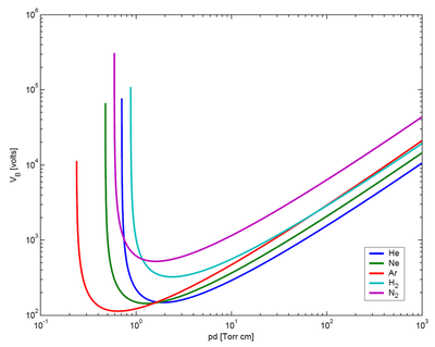

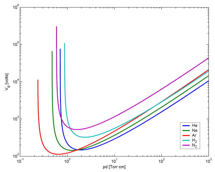

Yes, plasma is a hard load to drive indeed, and the dependency of current draw on gas pressure is intense to say the very least. This is why we use a series ballast resistor in the 50-100k range and spend so much time with gas control. The way it works out, we're working on the very steep part of the left-hand side of the Paschen law here.
Paschen's law from wikipedia
If there's too much gas, current will rise more or less without limit until evaporated metal atoms get involved, at which point it gets to a pretty good short circuit (arc welder -- 20v, 100's of amps). As you go down in gas pressure, there's not as many ions and electrons to carry current, and less of the gas is ionized as a proportion of the total gas present too, so in a narrow range, you can drive it with reasonable kit.
A plasma has negative resistance -- the more current you try to put across it, the lower the voltage goes, due to more current carriers coming into play -- this is on top of Paschen's law, so the plot above isn't the whole story at all. We are trying for the opposite extreme from an arc welder here, and even a moment of high peak current (from the stack capacitors) can take you to "arc welder" conditions. You need an absolute current limit (series resistor) of under an amp or so at these sizes to prevent that happening every single time it lights off. Which is why you can make a neon lamp blink with a series R and a parallel C. The arc mode from peak capacitor current drives the voltage on the cap well below the original "strike" voltage of the lamp, which goes out as soon as the cap can't bring all the big currents into it.
The lamp then goes out, and the cap recharges to the strike voltage again, and the cycle repeats. Same thing can happen in a fusor, and often does. In the case of the lowly Ne-2 bulb, the strike volts are about 110, and the stable sustain volts at very low current is about 70, but during a capacitor discharge can go much lower while the current is high.

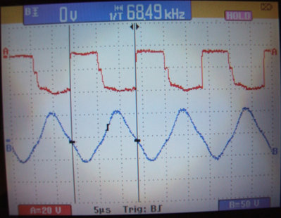

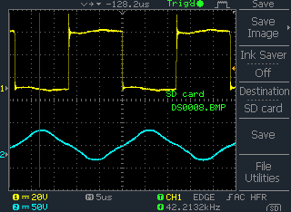

Re: Burning FET's and driver troubles

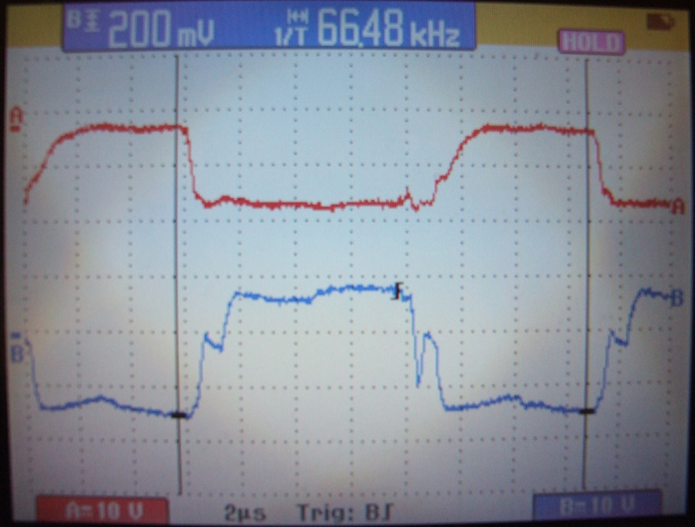

Here's what you need to see on your scope to make me (and more importantly your semiconductors) happy.
Good operation traces
Upper trace is scope directly between source and drain of one of the lower fets. Lower trace is a probe held near one of the secondary output wires.
In phase, no nasty glitching, etc. Note while the secondary isn't a square wave or sine wave, it's closer to the latter.

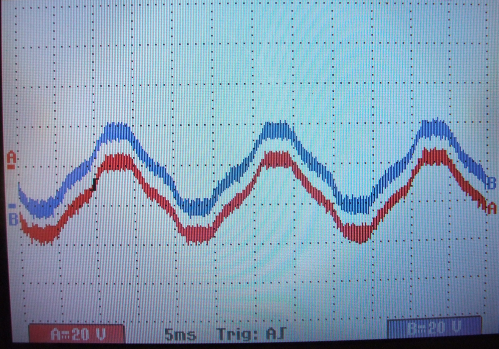

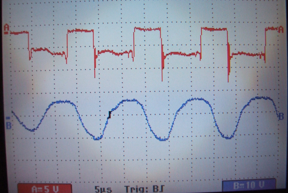

>the bad waveform above is explained by capacitor ripple (which you can measure on either rail vs earth gnd, and you should see some when the bridge is drawing current

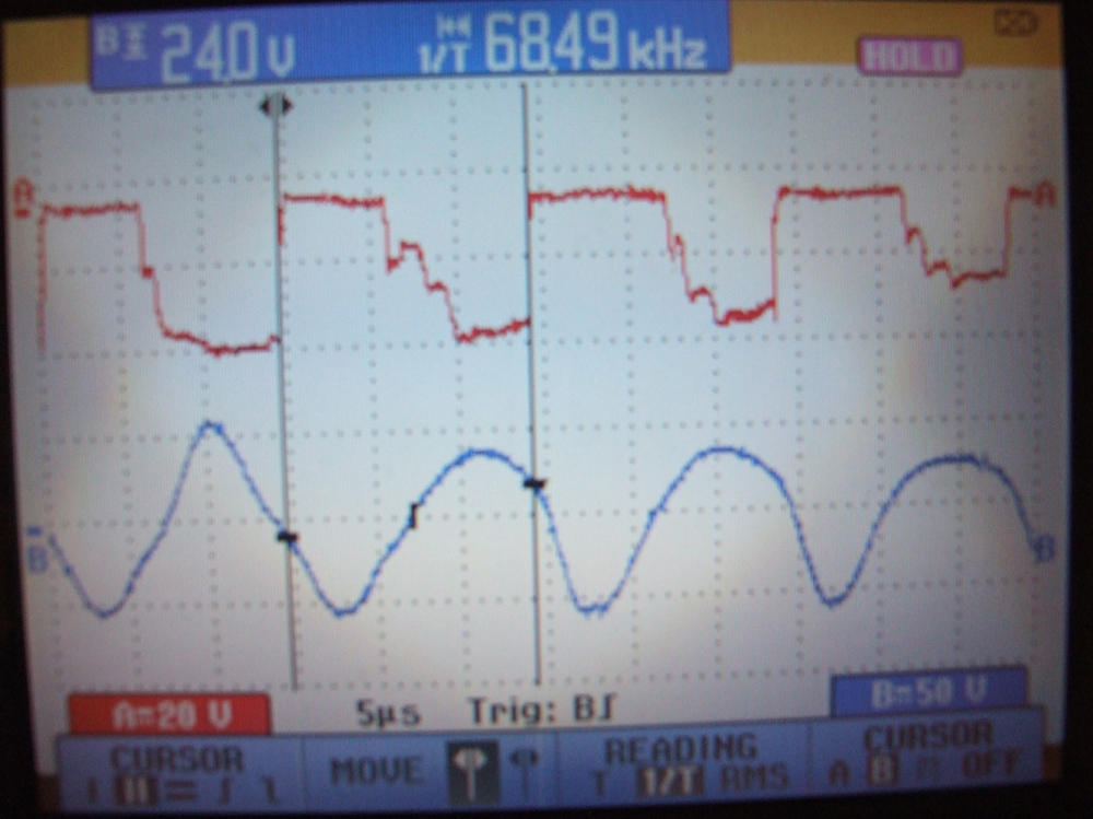

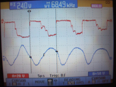

I have checked the rails under load (30KV at 'high pressure' - around 200mbar) - see pic 1 & 2

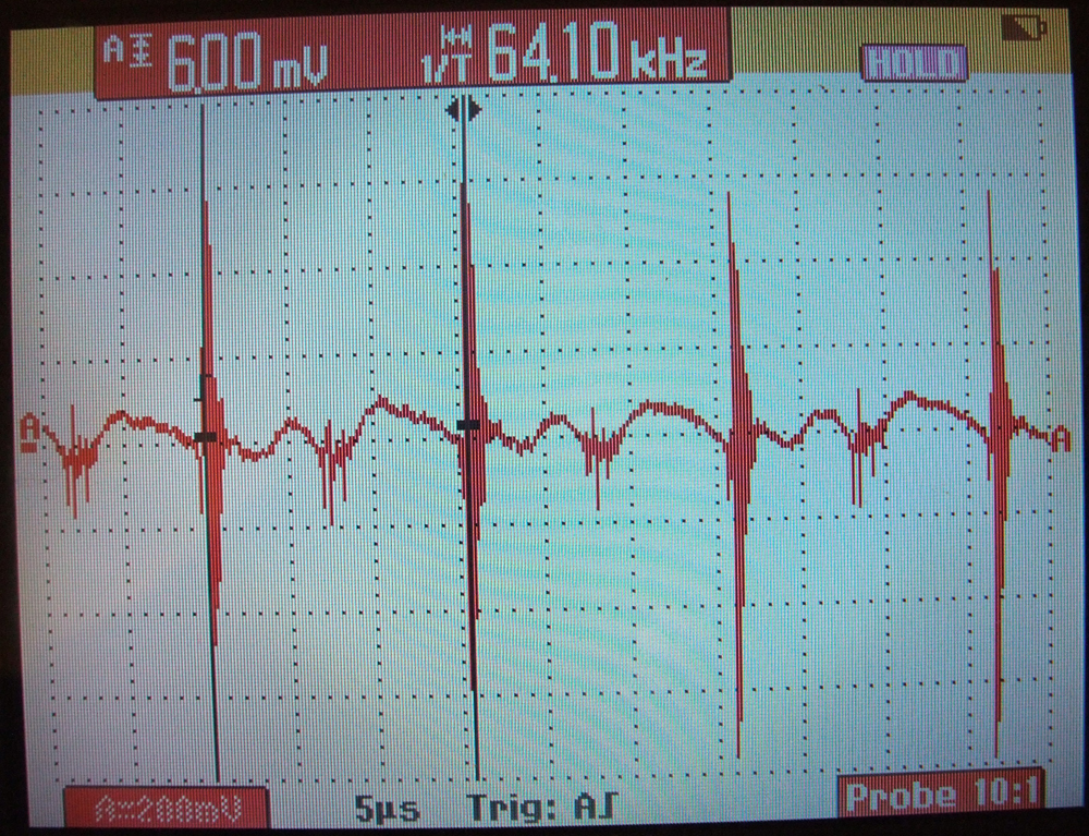

I also remeasured those gate/output waveforms - looks like you are right, I just need to measure with respect to ground. (pic 3 - using only one primary)

Capacitor rail under load, measured @ positive rail and scope gnd to negative rail
Capacitor rail under load, measured @ positive rail and scope gnd to earth<br />Red = positive rail, Blue = negative rail

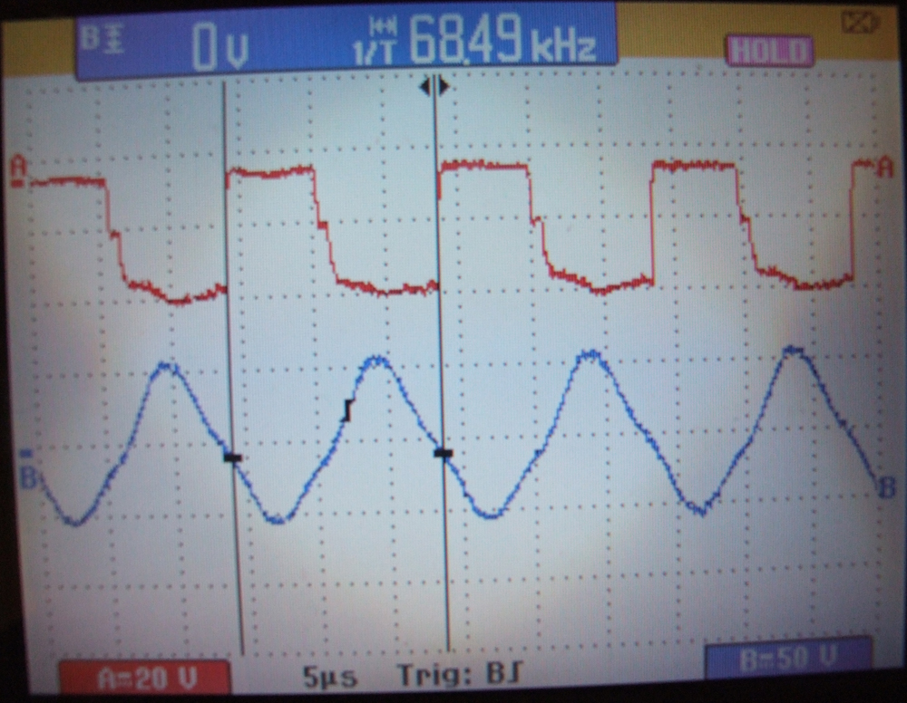

Red = gate, Blue = output (drain) @66.5KHz,  scope gnds to earth, with plasma load

Yes, scope traces far better, now I can read the legends too.
40v ripple is a bit excessive on the cap rails. Shoot for under 10v pk pk and things will like that better.
That bottom trace -- hopefully we're seeing mainly drop on the power supply if you're using 'earth' for the scope ground rather than the fet source terminal. If that's the case, you're fine now I'd guess. Otherwise looks "in good operating range" for these things.

Ah, I just saw your post and ran that same measurement. It looks pretty close.
The first pic is at quiescent current, and is about as near as I can get to resonance (just below by a few hundred Hz without everything going haywire (no load). Upper trace is scope directly between source and drain of one of the lower fets. Lower trace is a probe held near one of the secondary output wires.
The second pic is at resonance - the tank actually 'whines' at a rather unsettling 'imminent death' kinda pitch, and the waveforms go crazy. (no load).
The last pic is under load at a pressure that my thermocouples read as 5 microns - looks like a phase shift...
260mA on variac, -25KV
270mA on variac, -25.5KV
3amps on variac, -1KV
Excellent pix (and operation).
Hard to explain that whine being anything in the audible region at all, even with 100hz ripple on the supply. But yes, if it's making noise, that's not a happy condition for some reason. Could be a kind of loose primary turn plus some acoustic resonance in the construct that's getting hit at 100hz and ringing at some more audible frequency?
At any rate, that implies motion someplace that will eventually make trouble. "If your arm hurts when you do that, don't do that" ;)
The phase shift under heavy load is in the direction I'd expect -- this is actually operating according to "theory" now, great! When you draw secondary current, it cancels some of the primary volt/amps, which lets the ferrite run at lower magnetization, where the BH curve is steeper and the inductance is higher, so the resonance drops. Hence the lag under load. This is a good thing as now "theory" becomes useful as a tool again should anything else need work.
This means you're getting near magnetic limits at no load, which is worse than full load for that -- and eventually you might want to tune this for "typical load" but I'd make no load happy by default myself unless that caused other problems.
We learned this one the hard way, buying some X ray supply transformers that only wouldn't burn up if fully loaded, and even then only run for a second before smoking out of oil Perfectly fine in their intended use -- in oil, with fractional-second power-on times, always full load (preheated tube filaments) and plenty of time to cool between so some guy could come back in the room and change film -- not so good for this work.
