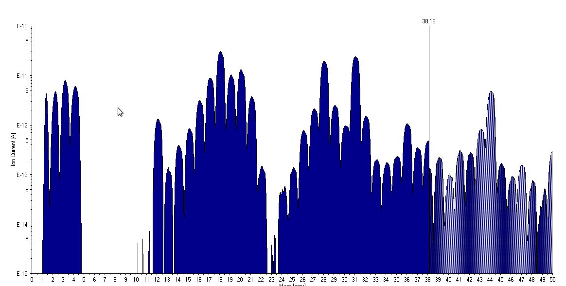

Ok, let's have some fun and look at the pretty eye candy a little bit. As always, click the pic to make it bigger.

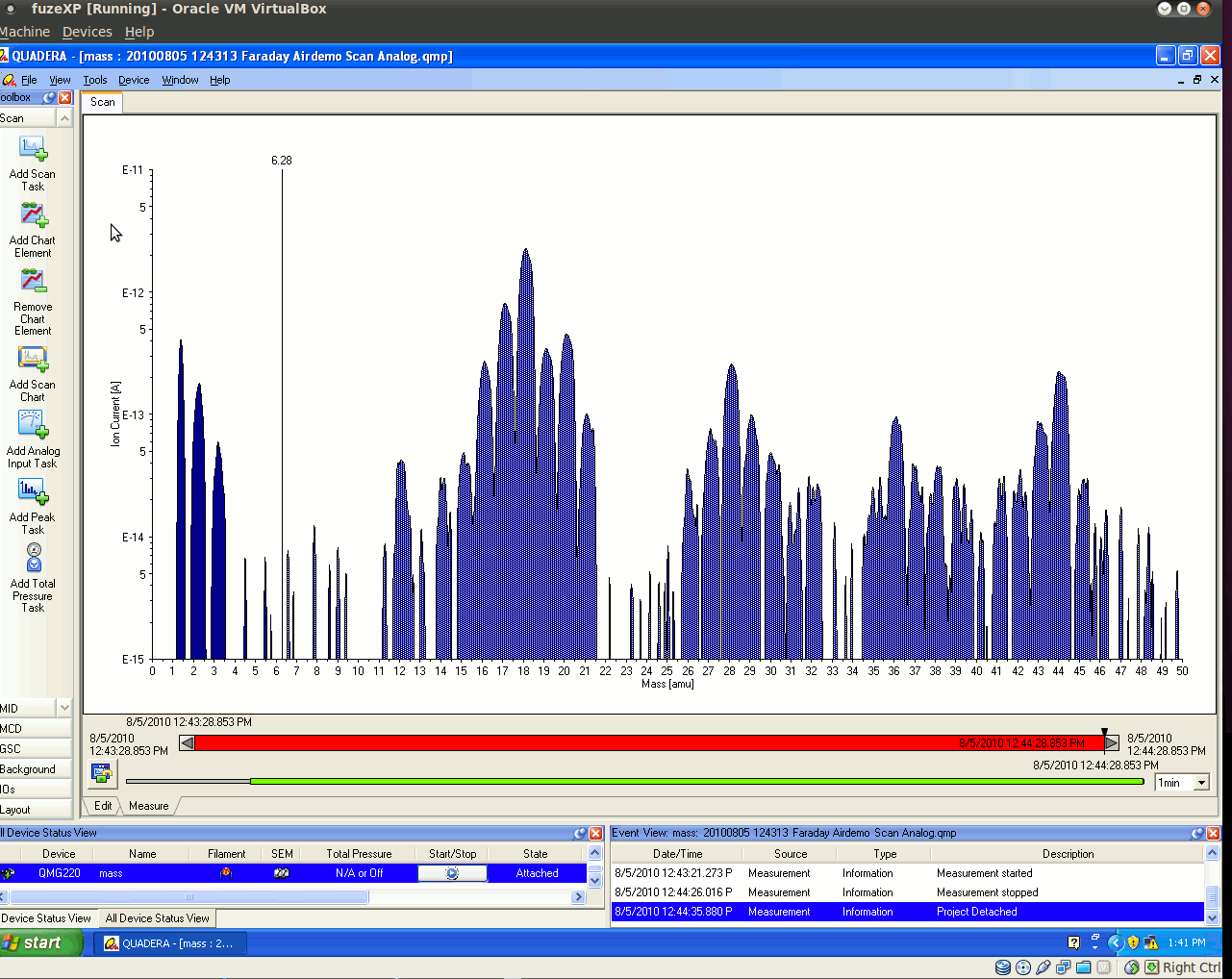

Analog short scan as the system sat when I started, having been on pump for about a week.

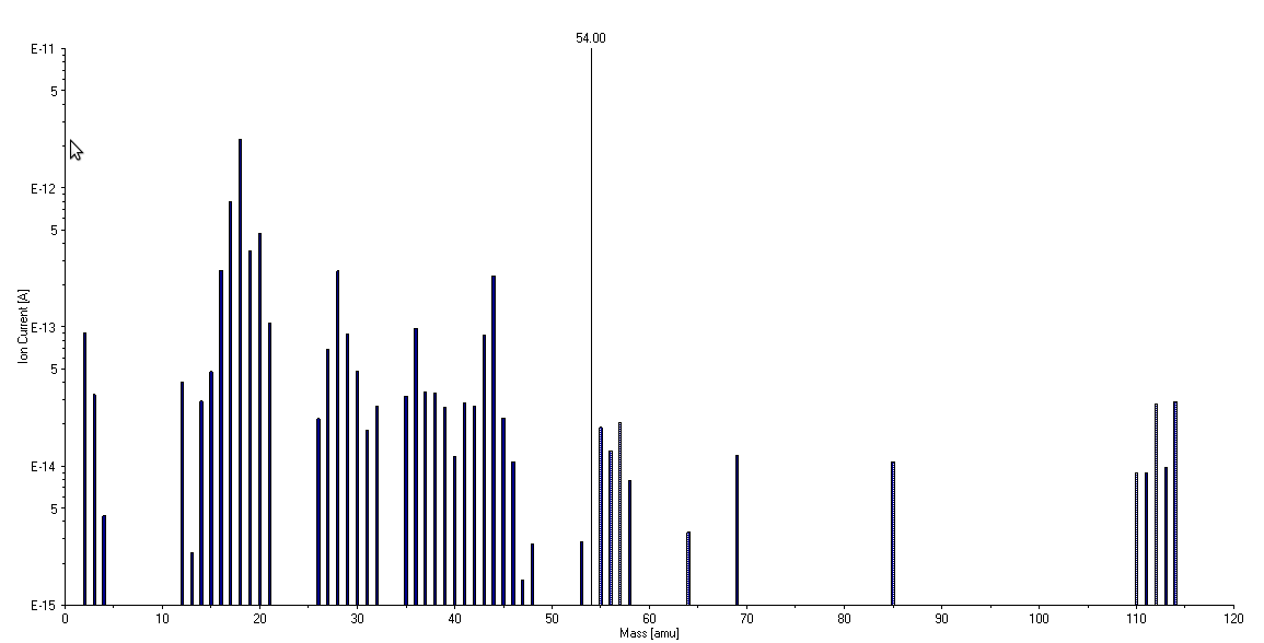

As I said, this can be a bit daunting, but it's also clear why "water is the enemy" is the word in vacuum systems. The system was at about 2e-8 mbar at this point, and this truncated to mass 50 scan was done fast so there are some noise artifacts in it. You can pretty much count on those skinny lines, which are narrower than the normal resolution are in the noise and mean nothing. You will also notice that the masses are a bit off from the periodic table -- I've not yet recalibrated that since I got this upgraded lately, but hey, you can read through that, right? Well, we can make the little stuff go away by having it bin things into unit masses, but due to that error, we now have another one:

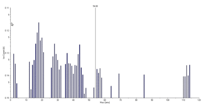

Faraday binned into integer mass numbers.
As you can see, all the "1" became "2" due to the shift off calibration. But we can also see less noise and see farther down as a result. Obviously I need to do that calibration though!
Now, this system had been under pumping for maybe a week or 10 days since the last tim a fusor run occured. It's been a long time since it was up to STP, maybe a month. What we are seeing, mainly, is what can get through the viton O rings that seal the door and a couple of feedthroughs - the rest of the tank is clean, and CF flanged. You'd think that a week or so at about e-8 mbar would have outgassed the tank, right? Nope. Let's turn on the internal quartz heaters for about 30 seconds and take another scan.

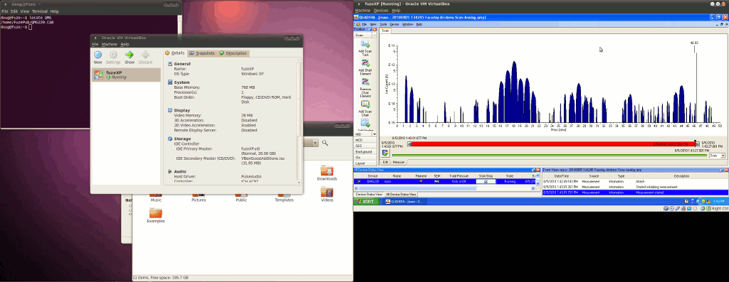

For fun, here's a screen shot of what I see in the lab, split over two screens there. Note that I am running Linux (ubuntu 10.4) and running this windows XP .net DCOM app in virtual box, which did take a little trickery, but that's where all that nasty, crashy, slow, insecure stuff belongs -- in a sandbox on a real operating system. This has to be the worst, yet still kind of working software I've ever seen (and the next few on the list are all .NET). I'm not sure it's the fault of the tools, except maybe they make it too easy for people to think they are programmers, who should really stay out of the kitchen if they don't know better than to try and do realtime in things like this with polling loops, and highly wrapped comm protocols they don't understand the issues with.

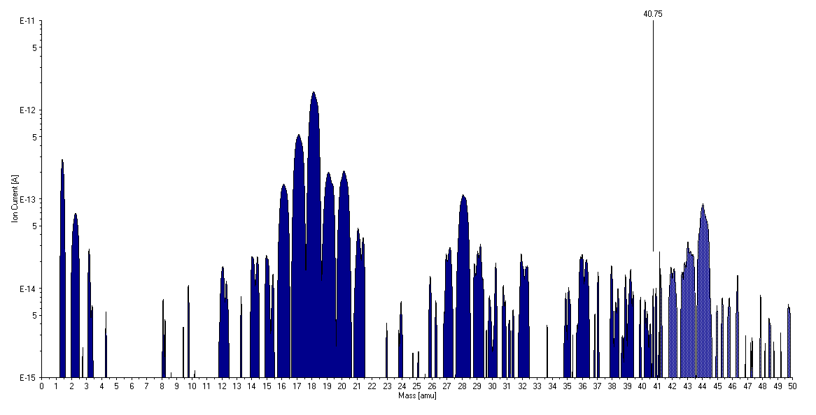

The whole picture, analog scan post heat.

Looks like some oil got back in to the system. Maybe backstreamed from the foreline hose when the turbo was off.
Your unit just has the faraday cup, right? They are nice in that they can stored at STP. The electron multiplier ones need to be kept at vacuum or the sensitivity drops. My Inficon Quadrex 200 seems to be getting more sensitive as I use it. It must be slowly drying out. I think I found a new emult for it on ebay. All sealed under vacuum.
Heres an old scan from my diff pumped system. You can see peaks at 41, 43, and 45. These are indicative of pump oil.

Yeah, those peaks around 40 are usually (other than Ar) carbon of some sort -- CO, CO2 and such with maybe an H stuck on there to make it more complex. You should also see some in the 100's and up from oil, depending. I've got a real poser at about 110 I'm trying to figure out. I'll have to take more good data and show it - no one has been able to say anything real convincing about it yet.

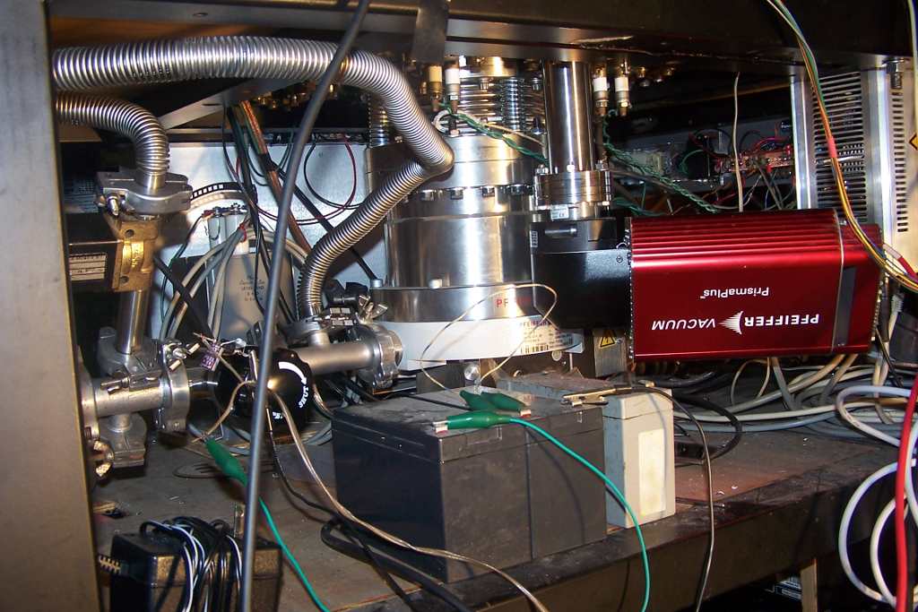

Here's a pic of my lashup. Yes, the thing is under the tank to be out of the way (people walk into things around here sometimes). I have a screen over the top to keep junk out of it.
This was bought as a Prisma Plus RGA, later upgraded to a "real" mass spectrometer with some range. Like a lot of manufacturers, that was really mainly a software change for a lot more money. I had it in for repair anyway, as someone did walk into it when it was in another place....
Of more note, in this picture you can also see the gas flow regulation system that lives between the turbo and the Xtra-Dry pump below the shelf. There is a manual type valve, with a small solenoid valve we scrounged from a leak detector going around that. When I run, I set the turbo to spin about 25% of nominal speed, close the manual valve, leave the forepump running, and keep the pressure stable with an occasional short click on the solenoid valve. At some point after the start, I shut off the intake valve for the D, and then a couple small clicks, and it's stable and effectively a sealed off system at that point -- it takes a while for the gas in the intake plumbing (not shown here) to finally equalize with tank pressure, and that's it. Gheesh what a struggle it was to finally get that to work for long periods hands-off, but it's there now! This is new to me, so I'm still using the 12v gel cells you see in the picture, along with the wall wart they will be replaced by when I get my round 'tuit.
