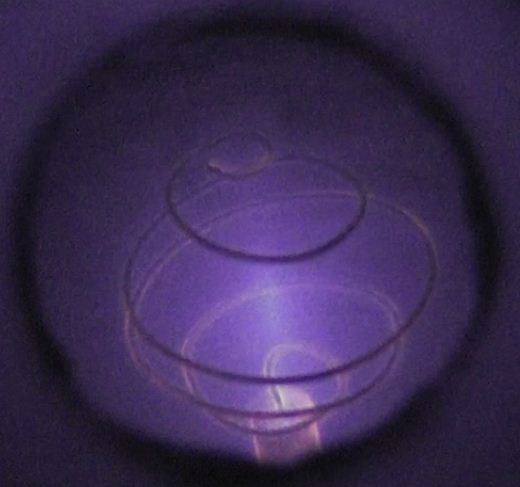

We're having some problems (I think) at the moment. We got some vacuum fittings to secure our 1/4" copper tubing by pass loop into our 1" bellow tubing. We got the pressure back down to our previous level of 1 mTorr, but for some reason when I close the main stop valve and pull air just through the bypass loop, the pressure slowly rises (about .1 mTorr every second or so). This is a HUGE concern and I'm not sure how to trouble shoot. I already checked the flanges on the fusor for small leaks using alcohol and I didn't find any. The connections of the copper tubing are as perfect as we can make them (they look perfect to me). I'm really not sure where to go from here...
Perhaps more troubling is the video we just took. I brought the fusor down to 1.3 mTorr and at around 17 kV I leaked some air into the system. The pressure got to around 2.5 mTorr and we got a BRIEF glow that was really bright and then it dimmed a bit and, in less than a frame on the camcorder, it went out. The power supply is reading an overcurrent, but it is set at 25 mA for that. I put the pictures from the start of the glow to the end where it cut out below. If nothing else, they look different than what we've gotten before.

This kind of thing isn't uncommon to see when you have a leak and things are drifting. The reason the pressure goes up on bypass-only is that your leakage is big, and cutting down the pumping speed makes things equilibrate at a higher pressure. In any vacuum system, the net pressure is some equilibrium between leak/outgassing and pump rate -- even my really clean/tight system.
The pump says "we go below e-11 mbar" but heck, I've never seen that (and probably never will). In my case, I'm lucky to get within 2 orders of magnitude of that number -- and that's with a 500 liter/second pump! I can see permeation through the small amount of viton sealing I have, as well as outgassing on my mass spec, and pretty much a little of everything that has ever been in the tank since the last laborious detail-cleaning. When I pump down again after opening the tank, I can see my fingerprints as they evaporate on the mass spectrometer (takes a couple days sometimes).
When I was having such problems, I found that using a deliberately injected gas that has a different glow color than air (say, He or Ne) helps to see just how bad it is, and can sometimes also be used to find the doggone leak in the first place, by watching for a color change in the glow (just set current limit low, say 5 ma, no need for big power at this point, just need a glow to go by).
You have a large leak (by vacuum standards). That's got to be priority one on your project -- find and fix that bad guy. At this scale, the "large leak" may not even be enough to see light through (but you should try that -- because the human eye has a lot of dynamic range once dark-adapted), but it can still be big by vacuum standards. Think how much air it takes at STP to create a millibar in your tank -- in this example, it only takes 1/1000 of the tank volume as a leak. And even a drip can fill an ocean eventually. With a slow pump, it doesn't take as much leak to make trouble, either.

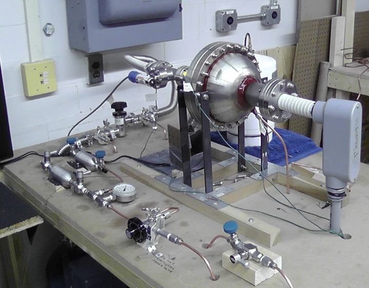

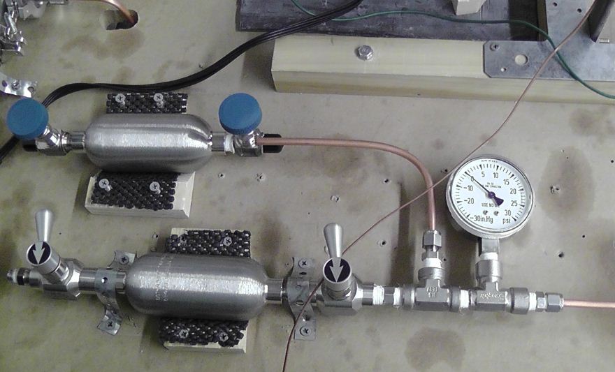

Alright, so after a long day of troubleshooting and making some new connections, we've helped the situation out some. So we found a leak between a stop valve and a needle valve we have in our bypass loop, so I think its fixed. As far as all the connections, flanges, and valves, I used an alcohol-dampened paper towel and looked for pressure spikes. I saw none, while before the valve connection was fixed, I saw a pressure spike when i put the paper towel between them. I also shut both valves off and saw the pressure shoot down. We're getting to low pressures again (1.2 mTorr or so), but the pressure would go up again when only the bypass loop was used. This went up fast the first couple of times, the pressure would go up fast. However, after letting the pump run for a while, the pressure went up pretty slow (about .1 mTorr every 5 s.). Hoping this trend continues, we're going to leave it on pulling just through the bypass loop and see where we're at in the morning. To give people a better idea of our system, I have attached an updated set of pictures below.
Gas Reservoirs (one for D2, one for any other desired gas), and fill pressure gauge
Entire setup. Note the glyptal painted in rings on the sphere.

Lee, if I understand your setup correctly, then your bypass loop is the small diameter tube that you are trying to pump through. If that's true then it may be contributing to some of your problems. Leaks are always a problem, especially when it comes to contamination, but it's really difficult to get a good base pressure through small tubing - the bigger tubing the better with vacuum. Shortening any tubing runs as much as possible will help too.

That definitely makes sense to me. I was lobbying for the use of 1" bellow tubing for the bypass loop before we built it, but that was mainly because its easy to move around and change. Originally, our bypass loop simply curled out straight from the two Tees in the picture, so each tube up to them were less than 8 inches long. The downside to that is our view port points right at the valve location, so our adviser said move it. So, we basically had to move it where we did for adjustments while we're operating the fusor. I would have liked to re-organize the entire cart, but we're scrapping that setup soon and moving to a vertically oriented reactor so everything will change. Would you think simply running the vacuum continuously for days will help get out the contaminants? We also have some Argon we're planning on running through the system to condition things, will that help?
