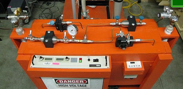

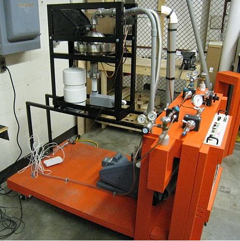

Alright, we've been EXTREMELY busy since my last post, so this is going to be a long one. Our radiation shielding team decided to orient he reactor vertically now versus the previous horizontal arrangement. So we had to re-run all of our fill and vacuum lines after we had them fixed. Its their part of the project and it looks so much better now, so I'm okay with that. So our new setup is shown below.

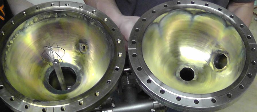

To put the reactor in that new cage structure, we had to take apart the hemispheres. This was the first time it had been open since we got our first plasma back on March 1st. We found that the 304 Stainless Steel was now a golden color on this inside. From my research, I have only been able to find that 304 SS turns "gold" at 400 C, orange at 500 C, and so on and so forth. I don't really have a better explanation than that, does anyone else?

Ok, so after that test, we were finally able to start conditioning with Argon. The main difference besides that is the fact that we put in a 3 loop, 0.032 inch diameter Tungsten whisk (1.6" diameter) that looks more symmetrical to me. When we ran the test, we got up to -32 kV before we got an arc (all time high for us at the moment), but our He-3 detector still wasn't working. So our reading for this test was consistently above 0.5 mr/hr, but spiked to 1.23 mr/hr and up to 0.9 mr/hr pretty often. So from this, we're estimating that we got about 100k neutrons, but its pure conjecture. At the moment, we're working to fix the He-3 detector and put in some 5% boron by weight borated poly we got for neutron shielding (we're going to monitor any gammas that come out of that). Hopefully we get a test in this week, but I'm graduating Saturday, so this may be my last chance to run it. I'll pass on this info to next year's team, so hopefully they get "better" results and put them up on here.
