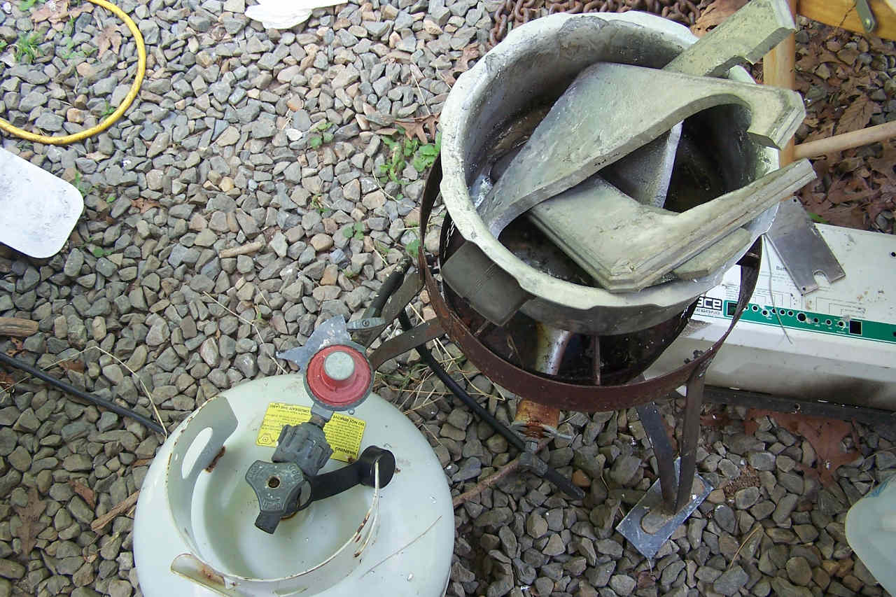

Here's the basic rig I'm using for melting.
The basic rig.
The basic rig.
Ranch grade all the way, baby. Fire set on about the lowest it will go, and a bit of water in there to help thermal contact with the raw chunks and warn me if things are getting too hot. I've had pure Cd catch fire...you really don't want to go there.

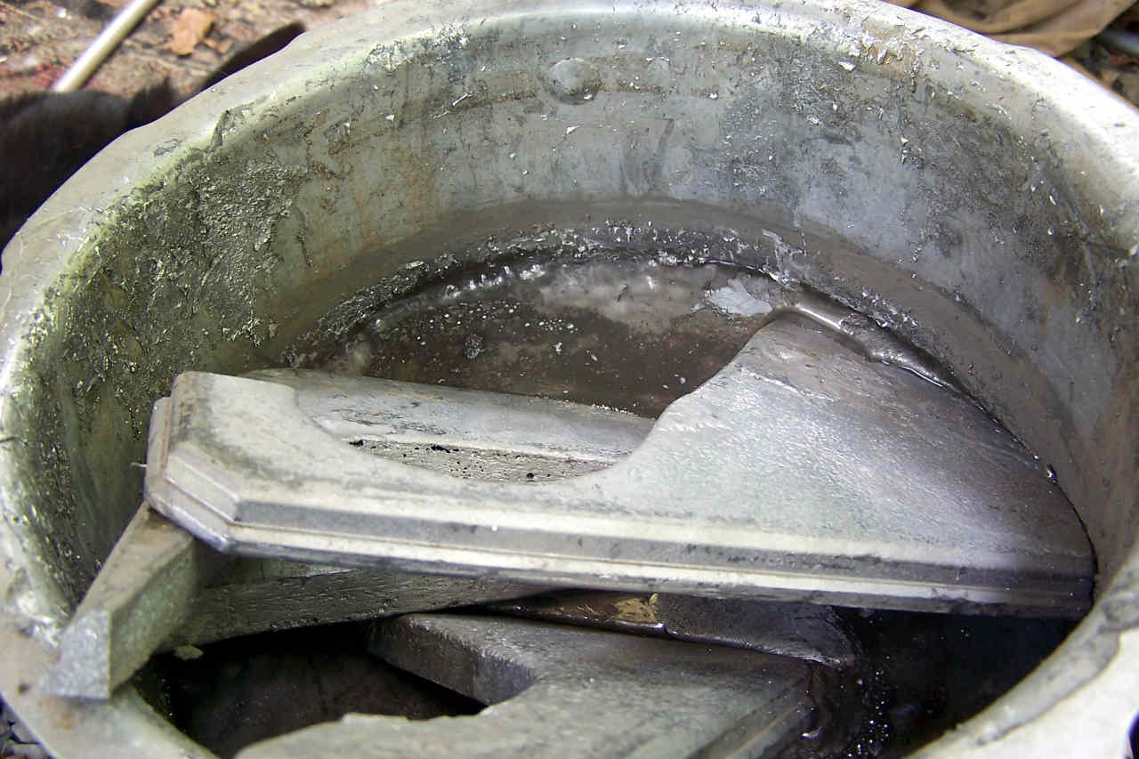

Just getting going here.

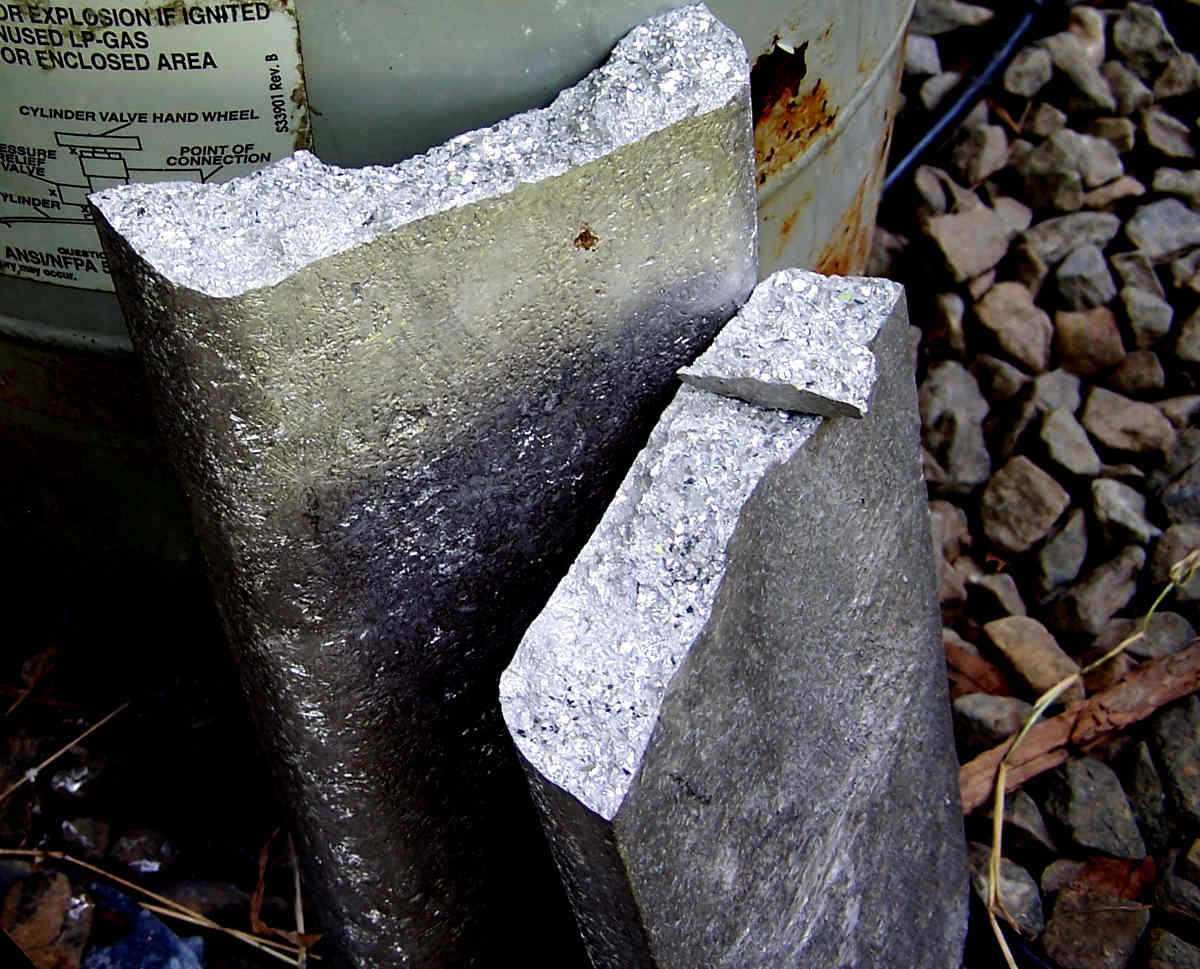

One hassle with the low melting point stuff is just that - it's low melting and takes quite a long time to get hard. This is exacerbated by the fact it has a weird phase-change heat as various things get hard and new eutectic compositions are formed. Short story, it takes "forever" to get hard again, outdoors in 80f weather. And, since it gets hard so slow, the crystals of this and that intermediate compound (none are really the pure elements as far as I can tell, but different eutectics or intermetallics) are huge. Which makes the stuff weak. Here's one I broke after only waiting a couple hours for it to cool off before dumping it out of the mold. Not everything I do works on the first try...
I broke one.  I'll need some smaller pieces anyway, I hope.  Lucky to get 2-3 a day of these since they take so long to do.

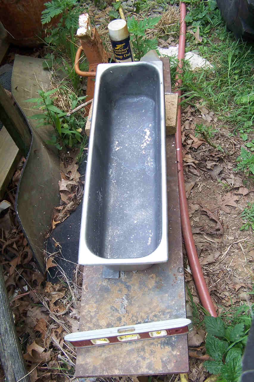

I've had sub-batches of this stuff permanently expand when hardening. I strongly suggest John Strong's hints in Procedures for Experimental Physics re casting - leave some draft. And use a mold release. Here I'm using one from Midway designed for bullet casting, and a really fancy stainless steel mold pan, I think made originally for drywall mud. It has plenty of draft and the stuff just falls out.
Like I said, ranch grade - anybody can do this with the best gear and unlimited time/money.  <br />A good engineer can do for a nickel what any damn fool can do for a dollar, after all.<br />All that other junk is used to level the pan each casting so things come out almost uniform.
Well, we have to melt it before pouring it. This takes awhile, and one should NOT turn up the fire to make it quicker. This stuff just takes time, and you don't want to overheat it.

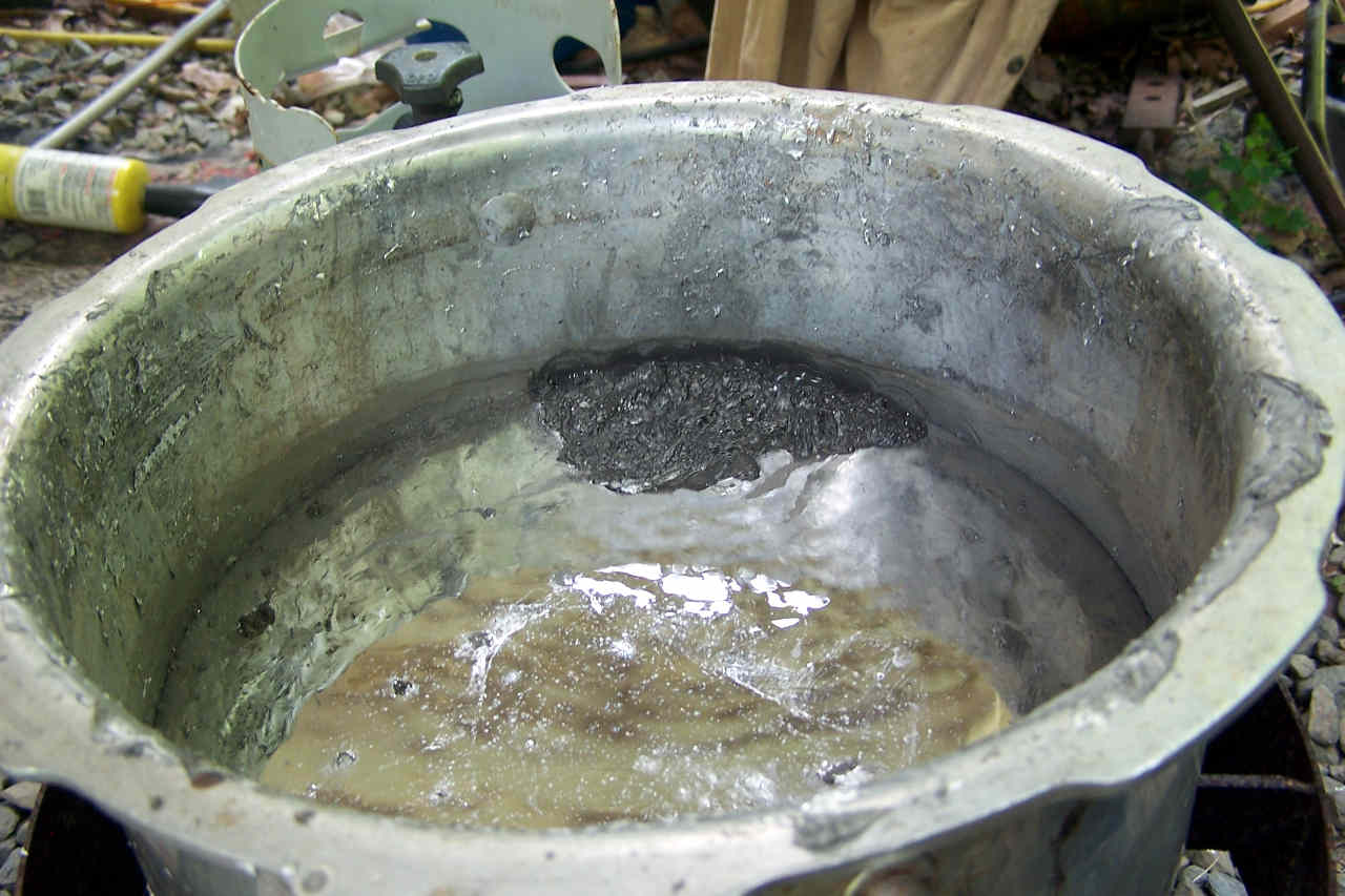

This stuff will happily sit under boiling water above its melting point and not melt for quite some time.  It makes water look like a lousy phase change heat storage media.
See that big pile of slag I skimmed to the side? Those pieces were cleaner than that - some of that was oxidation while doing the melt and taking all that time. Another reason for using the water to reduce the air exposure (water doesn't hold much oxygen when it's boiling). That slag is a deadly poison (Cadmium oxide and so on), FWIW - dispose of it properly.

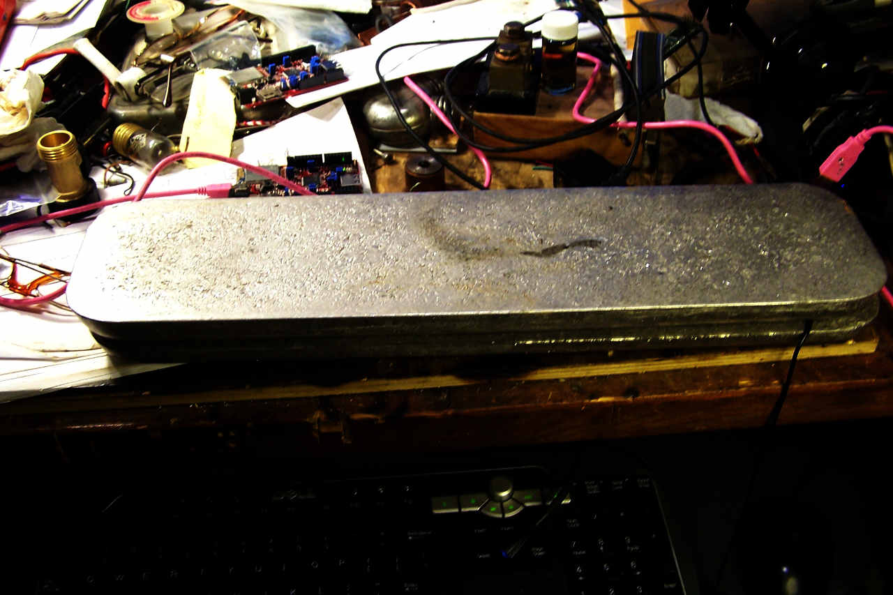

So, now (not quite done yet, have half a week more to do here) I have a bunch of 4.5" wide, 19" long by around 3/4" thick blocks of this. I plan to use the rounded edges so they can overlap a bit, and mount them with some sheet lead I also have to keep leaks down and hold it all together. We'll see if this will take tapped holes strong enough to hold its weight. I know the lead won't - they'll pull right out, so the bolt heads with washers will go on the lead side of things (outer).

And oh, here's a couple of the resulting "raw bricks" I plan to customize a bit before use. This stuff saws easy as pie FWIW.
Bricks of gamma/neutron shielding before customizing and mounting on the fusor.
