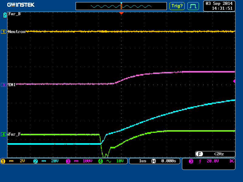

During these runs, we took some scope screenshots (with of course, yet another perl program). Here's one worth looking at, but it's the very devil to interpret accurately. I'll give it a bit of a go, but anyone who wants to do the real math is welcome to correct me. Here's one that's worth looking at:
Screenshot during ion source-on run.
First, the vertical scaling doesn't mean a lot here. For the blue line, which is the "back" faraday probe, the load was 100 megs with a 100x probe. For the front Faraday probe, the load was one meg with a 10x probe.
The front faraday probe is pretty near the ion source grid, which ocaisonally sputters, not in the vacuum deposition sense, but in the sparkle sense - the feedthrough has an anodized aluminum rod, and there are the odd little sparkles there which generate noise on the ion source grid, which in turn affects everything else. The green trace sees this first, as it's close to the ion source. The other, blue line, is diametrically opposite and much closer to the main grid, but still out in the main tank volume. The purple line is a very differentiated version of the voltage on the main grid - it's just a t0x scope probe about 3" from the end of the feedthrough outside the tank. No neutrons happened to be counted during this one - there's not much correlation, and this noise is in general, not that huge, though via other measurements, we see a lot of power gain between the ion source grid used as a control element, and the main grid used as a collection element - we have what amounts to a huge PNP tube here (maybe better described as an enhancement mode Pfet), and the power gain is about 100.
So, if we call the green line the input (start of events) we see it takes awhile to get across the tank to where the blue line sensor is. Quite awhile in fact - >200ns at least. We see the blue line rise, and continue to rise as finally the main grid (the EMI line) starts to go positive, which indicatees the main grid is drawing much more current, but losing voltage due to the ballast resistor in series with it.
The fact that it goes positive shows this, and since it's a VERY differentiated signal (tiny C between the end of the scope probe and the real signal) this is showing that it's still rising as it goes off screen. Since the original voltage is negative, this means less and less actual drive voltage on the main grid.
My original hope was that we could use this accidental "transmitting tube" as an oscillator, and therefore use it to drive a POPS type of system, but this is far too slow for the (extrapolated from Miley's data, only a little better than a guess due to the very different conditions) for a 7MHz system that we think is at least around the correct octave for this...A lot of things have to be right at the same time for POPS to work at all, and the resonance is very narrrow, but it's nice to have it cut down to an octave or so in a the frequency and amplitude parameters, as the search space is otherwise quite daunting.

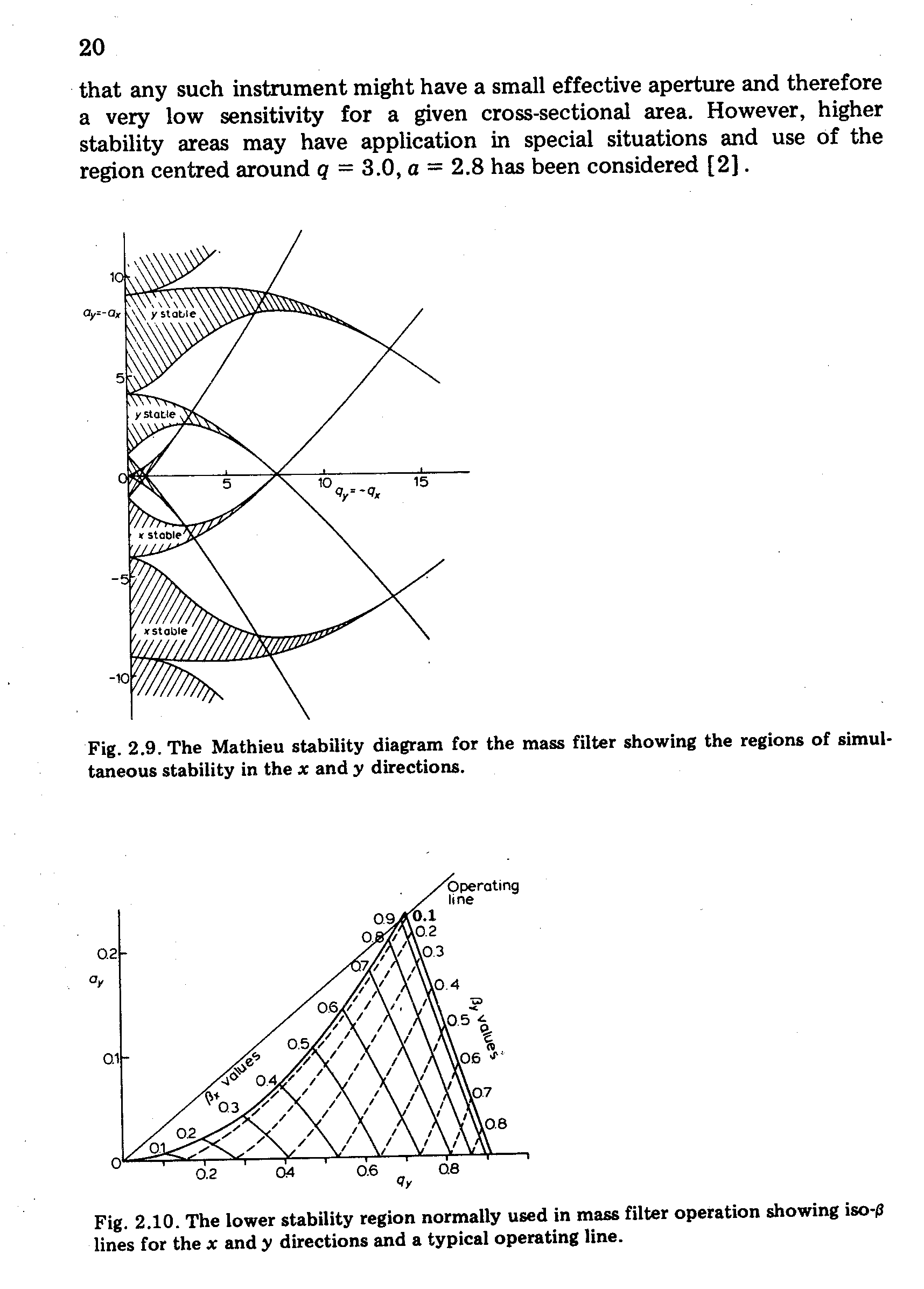

The math for POPS is quite similar to that used for quadupole mass spectrometers, only there are a couple more variables due to things like more than one charge/mass ratio at a time, not all the same speed, and space charge repulsion - those are all added variables to what is already pretty hairy. Basically it's this function with more complexity added to it(!).
A rather expensive book BillF got for us shows a plot of the "simple" version that doesn't take velocities and space charge into account, like we'll have to. This kinda shows why this isn't trivial. It's not a brute force thing, it's a subltle thing, but that doesn't make it easy.
Even the variables used for X,y, here are actually complex combinations of frequency, voltages for both RF and DC...and so on.
As you might guess, happening on a sweet spot by "just trying stuff" is not really likely. Even this is simplified over the fusor situation, and it already makes my head hurt.
Area usually used is near the origiin for mass spectrometers.  The only points that work at all are where this overlaps.
I will note something very important. Just about 100% of the literature makes the assumption (often unstated) that all plasmas are neutral.
this is clearly NOT the case in a fusor. Whether this excess negative charge is free electrrons, or from charge exchange to negative ions makes a difference in some analyses - when they ignore the whole issue, count on them being dead wrong. we have NEVER seen a net positive or pure neutal result from a faraday probe during fusion. Never.
