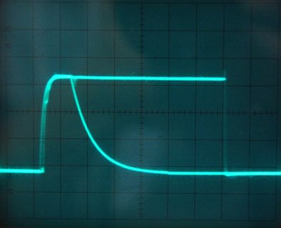

Here's the input signal waveform that I tested the circuit with (fast rising exponential followed by slow falling exponential):
input signal and output of peak detector (10us/div)

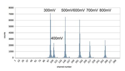

Here are some results (I just manually swept through some discrete voltage levels, so no precise timing and hence different peak heights in the spectrum):
entire 12 bit spectrum with peaks of various amplitudes
Below 1V, however, things start to get a little nonlinear. Peaks below 300mV are not detected or smeared out to the left of the spectrum.
What do you think? If you're OK with the functionality, I'll upload the final schematics / board layouts as well as the source code and get the thing on its way to you.

Looks pretty good except for the bottom end, yeah. I see both stretching and compression down there. In theory, if it's repeatable, we could fix it in the PC later, though - it's a better place to do any heavy-lifting type math. I noticed issues even on the big-guy expensive stuff, actually. It's not like all the available detectors are perfectly linear across the entire range, or that you need 4k for anything but maybe HPGE - NaI has fairly broad lines by comparison, and 1k gets a little more than it really has anyway. Usually I wound up using a small crystal for the low end of energies, and another big one for the high end, at any rate - with appropriate gain changes so each one's max output was full scale for the converter - then do the math later to make them into real numbers. The big ones don't work too well in the few kv range for whatever reason, and the little guys excel there, but stink at high energies where more often than not, the photon just compton scatters out anyway.

After this, I did another sweep of input amplitudes, here's the results (resulting spectrum to the left, pulse amplitude vs. channel to the right):
sweep from 1V up to 9V in 0.5V steps
sweep from 400mV to 1V in 50mV steps

As for bipolar pulses: here's the same low-voltage (i.e. from 400mV to 1000mV in 50mV steps) sweep with a crude bipolar-pulse (1 period of a sine wave) and the result looks even better (beside some flattening at the very bottom of amplitudes):
sweep with bipolar signal
Most commercial products seem to do the entire signal processing digitally which avoids most of the hassle we have here...

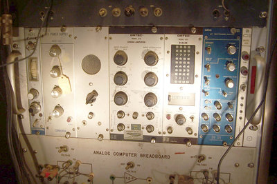

What it used to look like...

Your NIM-bin setup looks nice! I've always liked to have as many knobs, meters and LEDs as possible...
I also like the analog computer below -- I've only read about them, but never actually seen one (although if I interpret the text correctly, yours is breadboard to test some functions before they're wired into the real computer?).

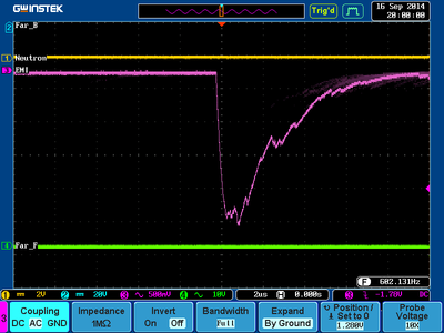

Here's a typical signal from a couple of NaI's I plan to send on to Phillip for his testing. These are 2 wire, and I used in the neighborhood of 820v with a 10k load driving the 1' provided (hardwired at the sensor end) cable and a .01 uf coupling cap to the ten meg scope probe to capture these.
From the .5&quot; crystal bicron Cs 137 662 kev line
From the .5" crystal bicron Cs 137 662 kev line
From the 1x1&quot; by 4&quot; deep bicron, looks like we caught a double here. (pileup)
From the 1x1" by 4" deep bicron, looks like we caught a double here. (pileup)
