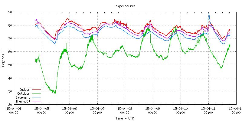

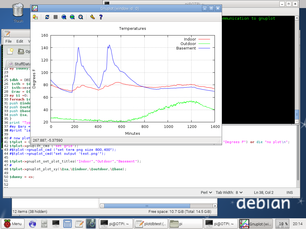

Well then, after only some bit of struggle, here's a nice plot of temperatures since roughly 9pm last night (it's now about 8:15 here)...work to do on X axis and so on...and basement temp is actually a sensor about a foot from my woodstove, looks like it's about time to start a fire again. What's new here is that this was from a MySQL database query and run remotely. The real plan is to have another daemon updating some plots as .png in a directory the web server has access to (when the pi is not too busy, it can check for that), and have a little html serve them up as part of a page...a submit button on that page might re-set the time interval and other options. Then with the auto-pull trick above, we can just have the nice 10.1" display on the pi updating all the time and see conditions over however long at a glance when walking by it.

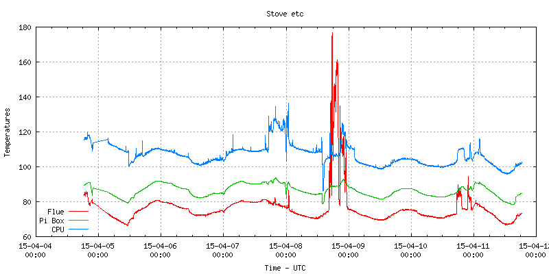

The thermocouple CJ (cold junction) is also on the bench, and at times I've had the TC itself hovering over my soldering iron. Box temp is what's reported by the BMP180 in the pi box. At some point I added a homebrew heatsink to the pi chip which *seemed* to drop its temperature differential a little (3/4" round stock with fins cut into it, about 1" long, epoxied to the cpu). But it's obviously in no danger, even in summer. Seems most of the heat is coming from the LCD and its driver stuff, FWIW, it's a nice little 10.1" display. I've not figured out how to either make the pi never go into "screen share/idle mode" or how to get the darn backlight of this LCD display (the main power eater I suspect) to go off when the pi is showing a blank, black, screen.
Yes, I googled and applied the supposed "fix" for going idle - and it didn't work.

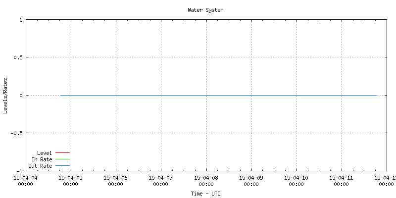

Here's some pretty plots. I can't easily show you the webpage it emits, as it's not on a public network - which IS THE WHOLE POINT here. Water stuff wasn't hooked up...but will be soon, it's installed and tested in the building it belongs in. As you might guess from this last plot, the system is designed to be "not stupid" and not lock up if a sensor is missing or fails.....Just show blank stuff. I'm looking for lots of 9's reliability here.
