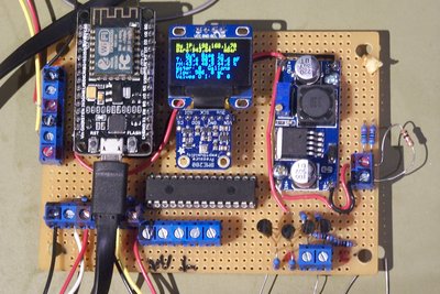

Here's the node hardware, more or less. This runs off the same DC supply that runs the house water pump, and uses some external logic to drive solenoid valves, and obviously some external sensors, but this is the fun part.
The node hardware
The node hardware

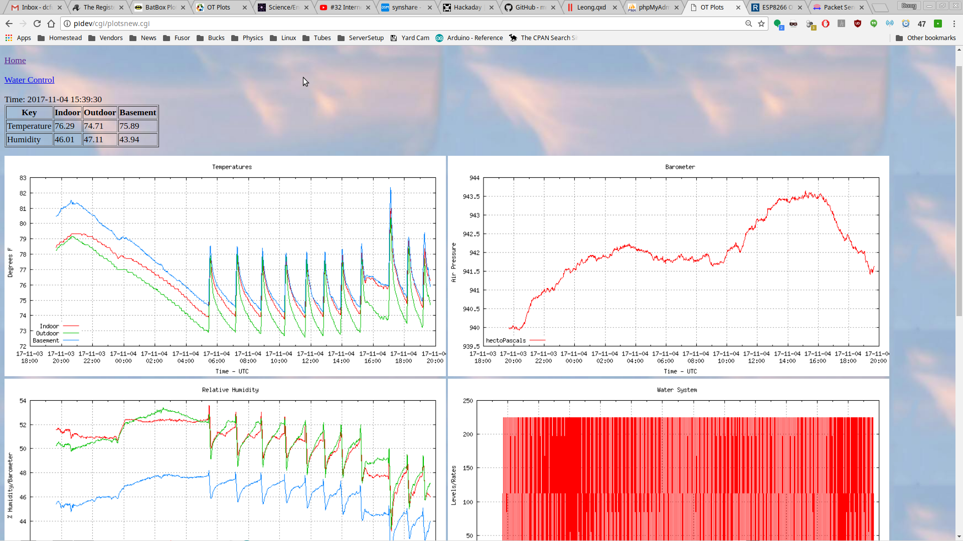

Here's a screenshot of one of the web pages the pi emits as a result of the data from this thing. You can sure see the propane heater that's right under this test jig cycling...And that there's no sensor hooked up to the water level pins, so random data there.
What I see as a result of all this.

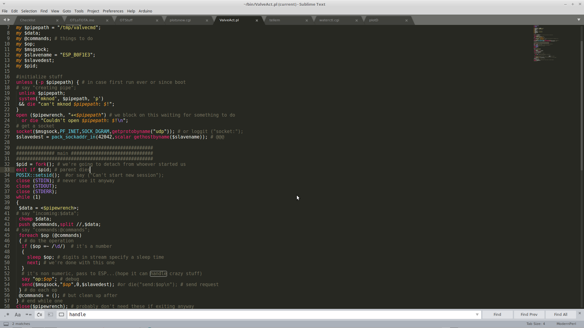

It's so little code I'm tempted to put it here, and I often give into temptation (other than, yup, still no smoking since spring!).

Hopefully even perl haters can read this fine...you don't have to make it hard to understand, and I rarely do, as I might have to understand it again later.
Of course it looks nicer in sublime-text, but you can't cut and paste from a screen shot. The syntax coloring does help see what's going on.
What I see &quot;at work&quot;.
What I see "at work".
